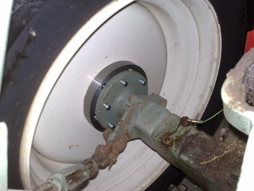

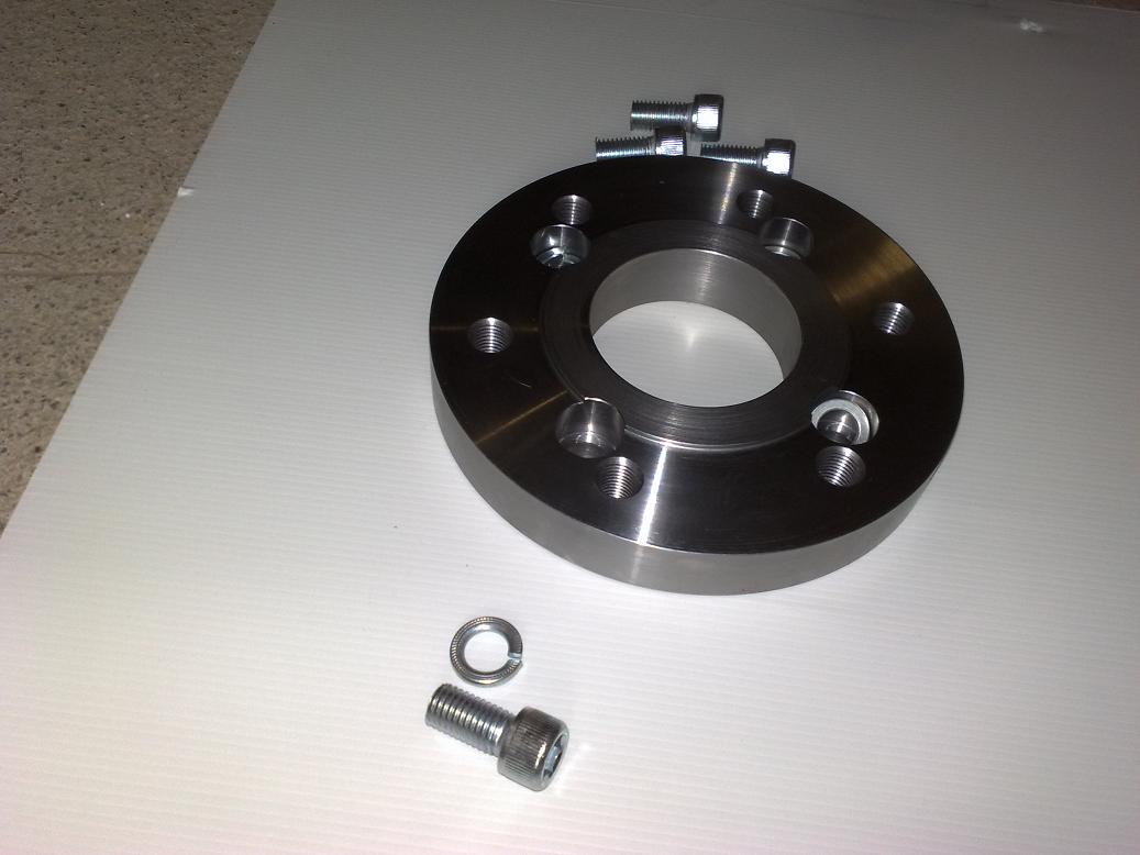

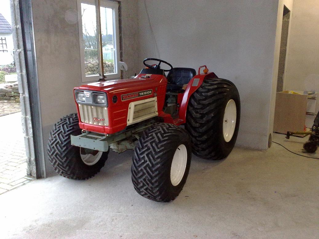

Progress going on.
Brought some plasma cutted iron rings to my friend. He is going to mill and drill. So i will see next week what i get.
made a sketch.
what i have got today.
Going to be an adapter for my yanni
fast sketch for my friend at the millingmachine
Stefan

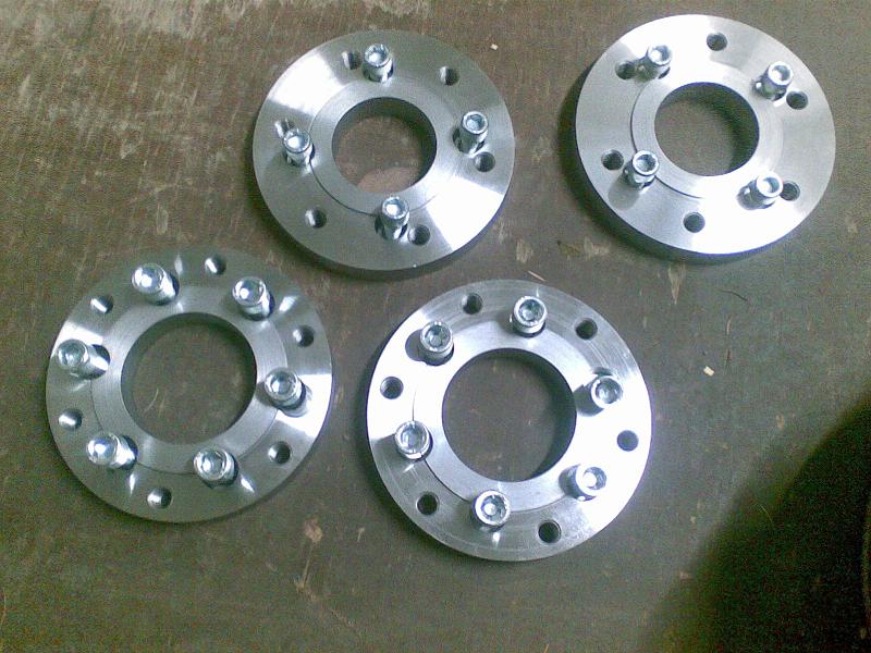

Hi,
got this evening my adapters from my friend with the millingmachine. Tomorrow morning, I will mount them to the Yanni and then you can have a look.
good night until tomorrow
Stefan:confused2:

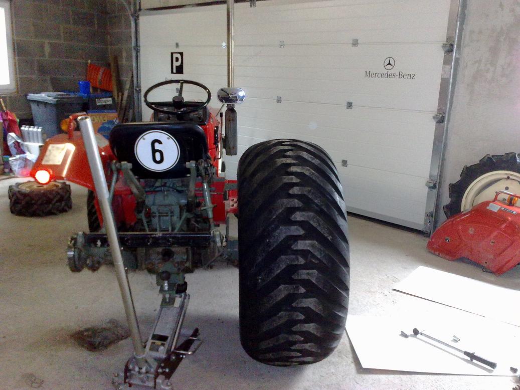

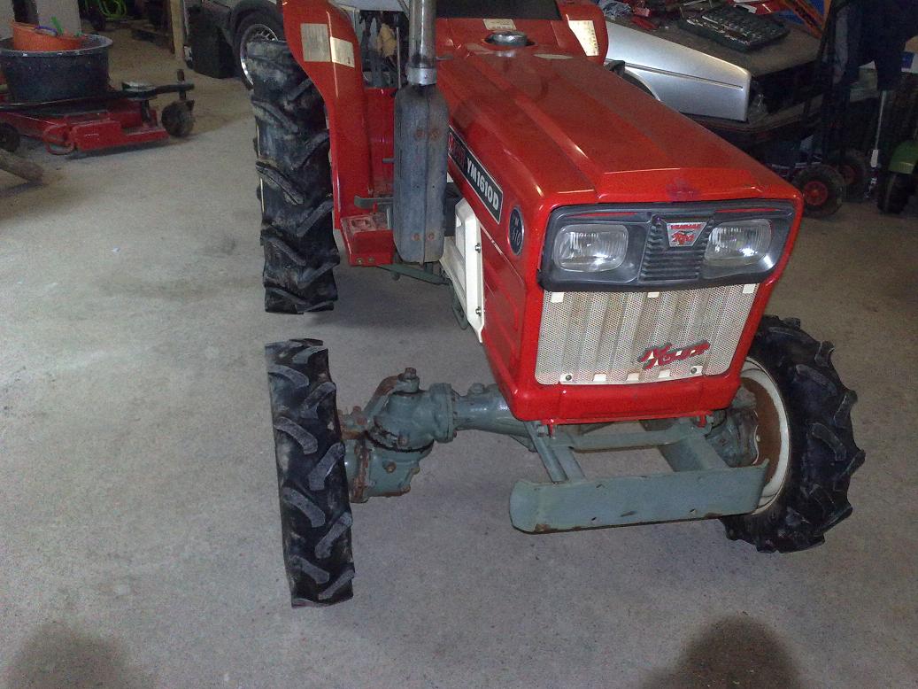

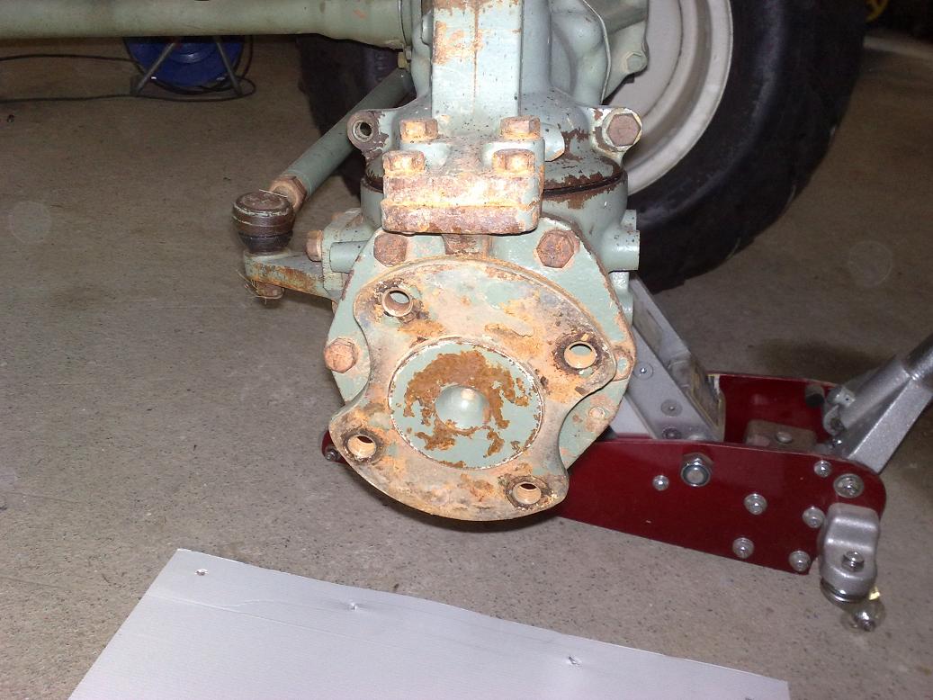

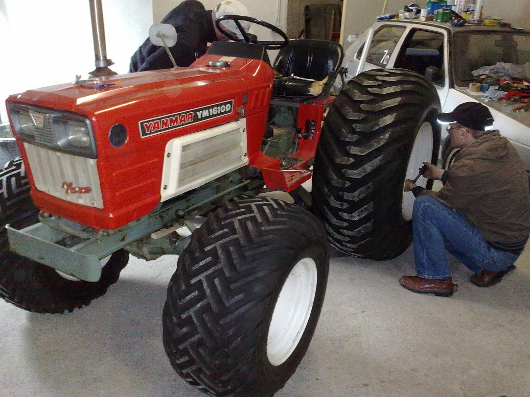

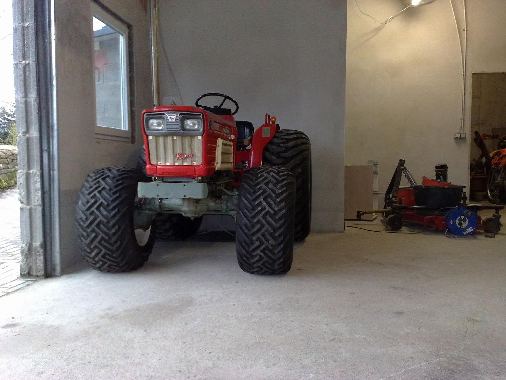

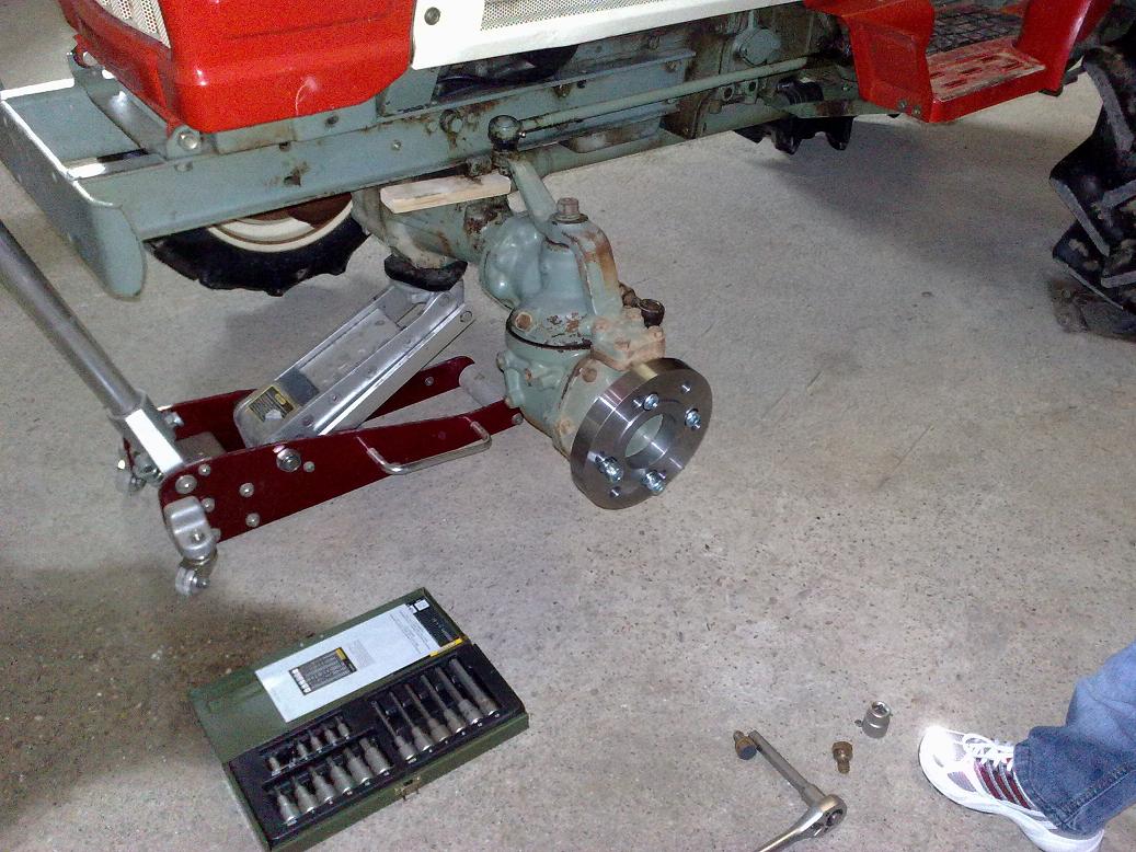

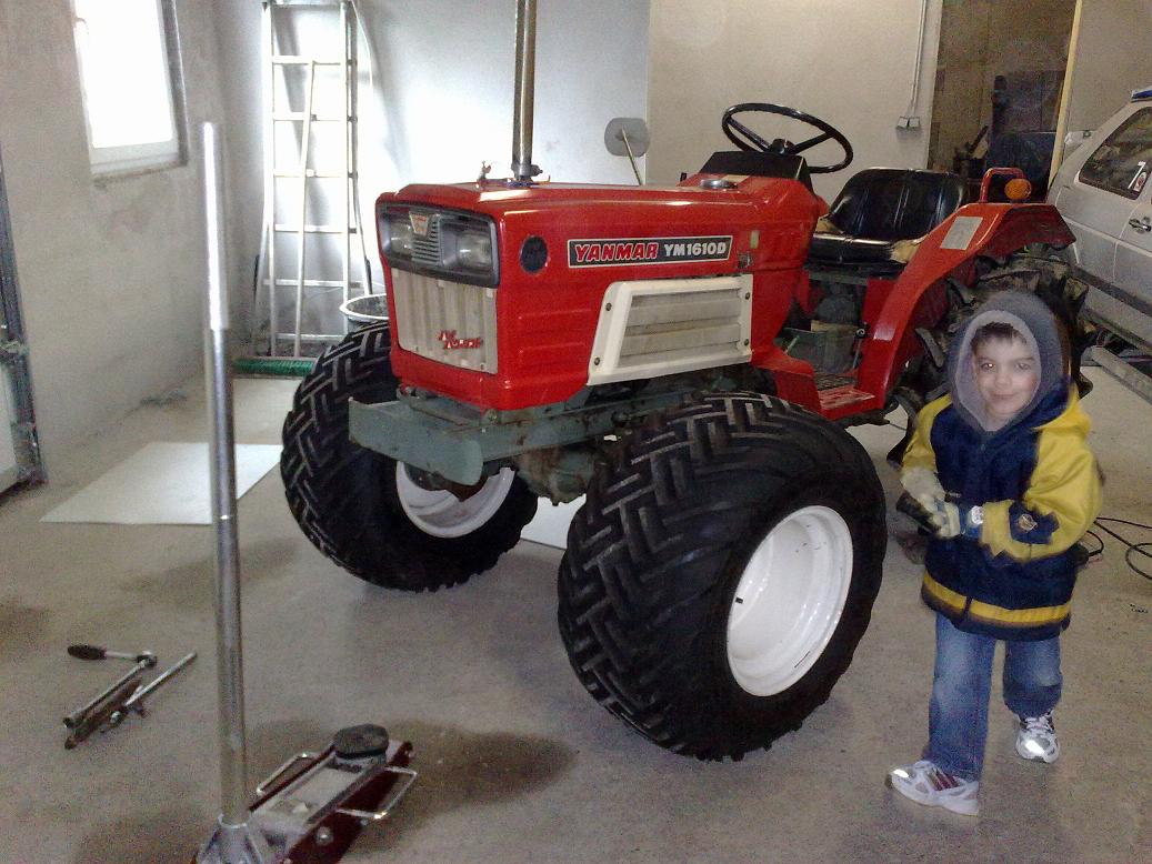

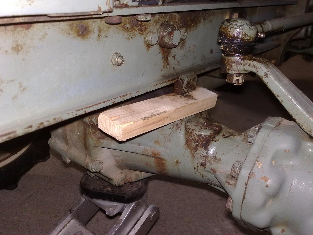

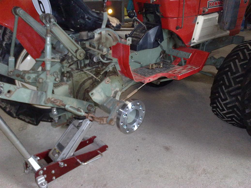

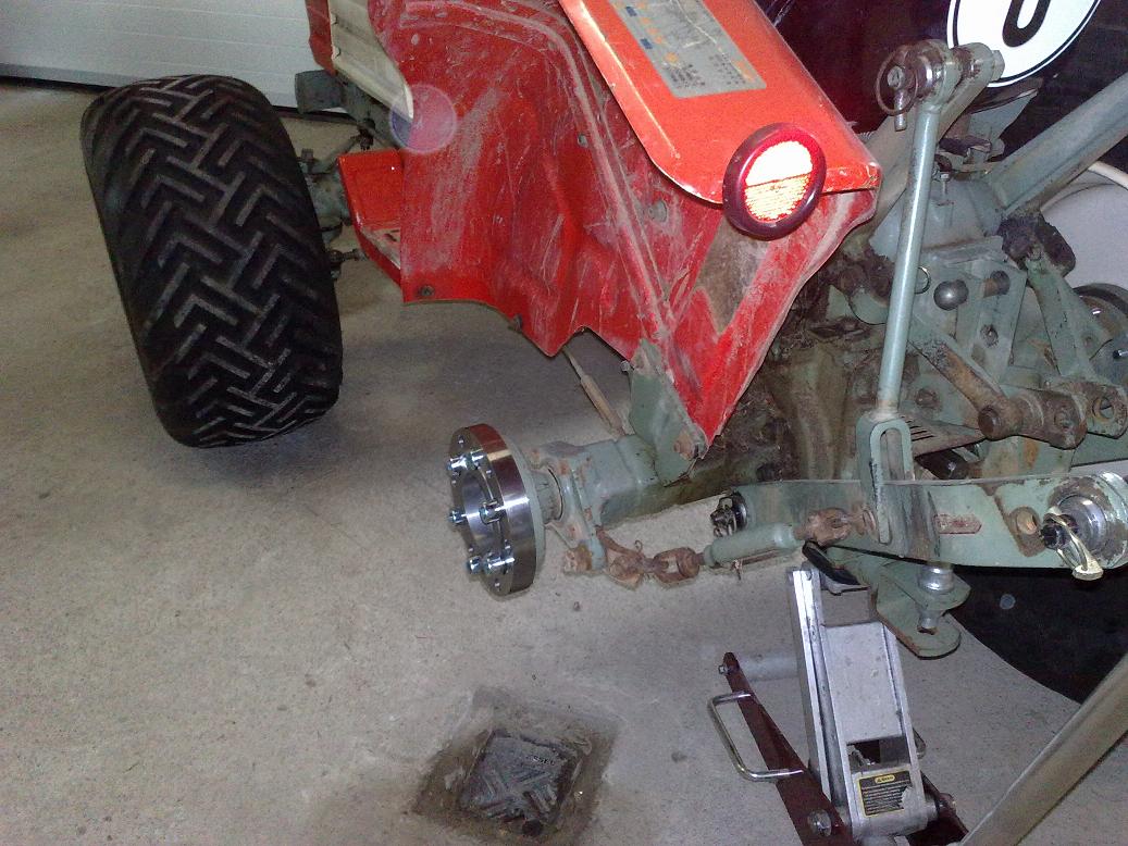

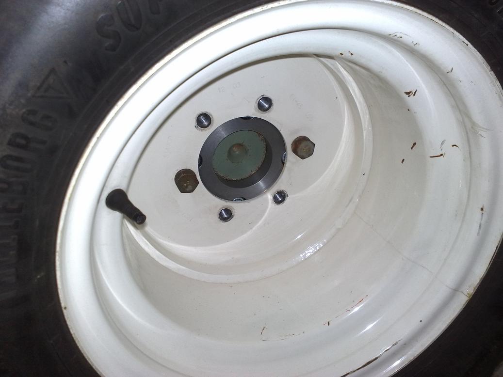

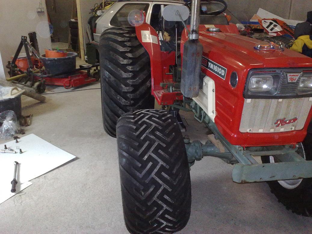

Hello to you all,
waiting has an end. Today i mounted the wheels and made a testdrive.
First mounted the front adapters and then the rear. With the help of my son Joschua and my friend Andreas ( I need them because the wheels are very huge to handle myself).
Before mounted the rear I had to remove the fenders. You know the wheels are huge. Drilles some new holes and mounted the fenders again and then the wheels.
Here you can see the result. My son made some videos an I will try to post them on youtube.
I know you like pics, so here are some attachments:cool:
