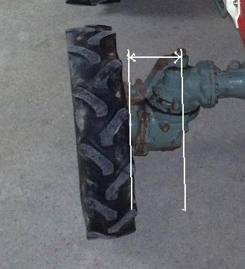

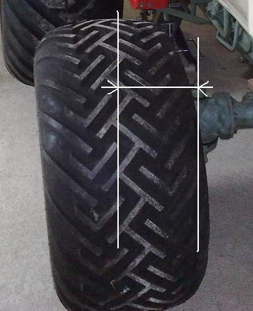

Hi Neat 1500,
had a lot of testdrives yesterday after mounting. I think the frontend will have no problems with the wheels. I think if you have a normal tractor with a FEL the stress for the front end ( stub axles etc.) is a lot of more.
Also something to think about: If you mount the original tires to the wide side, the stress to the front axle is higher than you mount the more wide tires, which are mounted in the middle of the rim. Hope you understand what i try to describe. my english is not the best. see the pictures. so i think if you have a FEL mounted it is harder for the YANNI :cool:

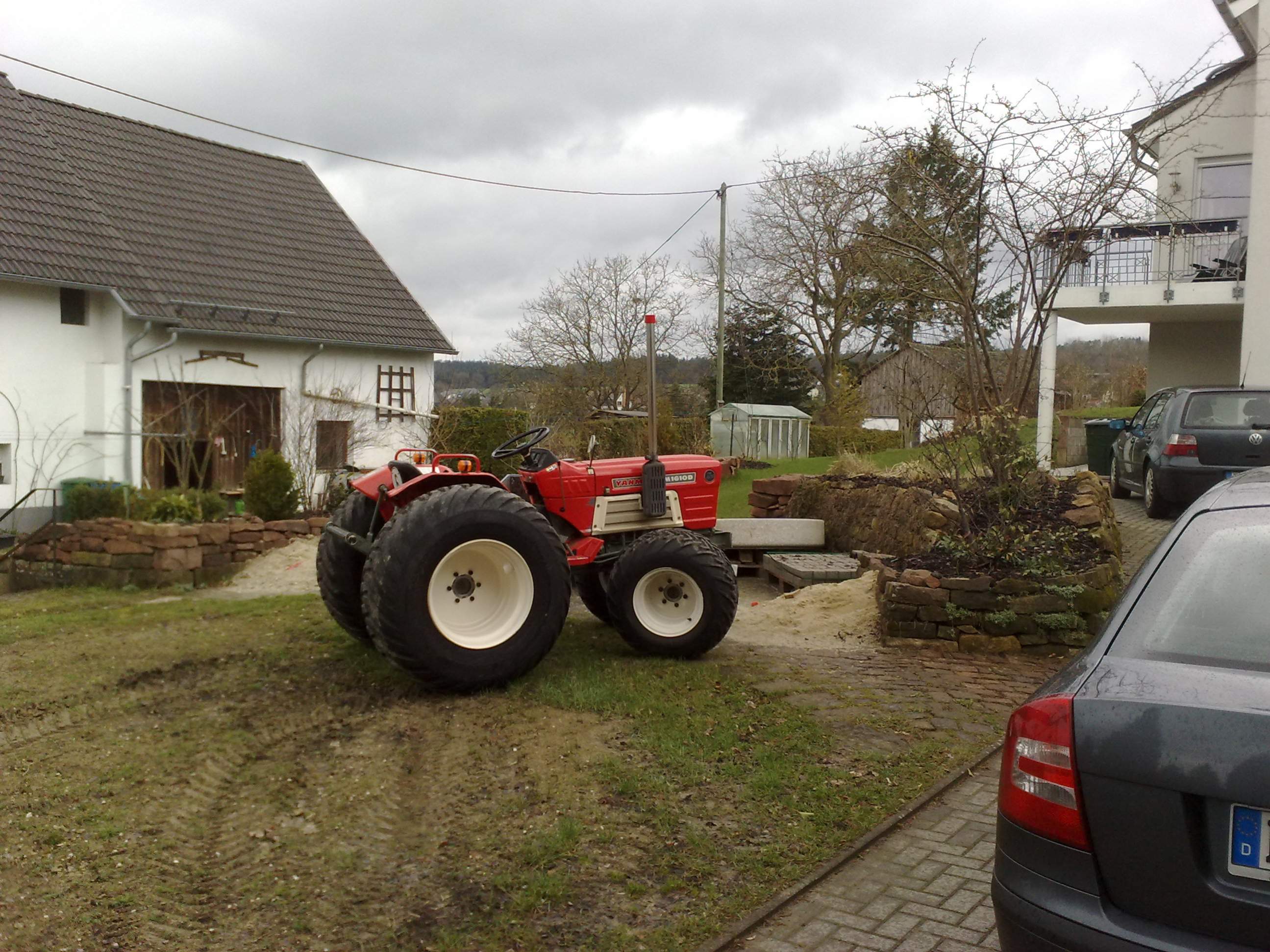

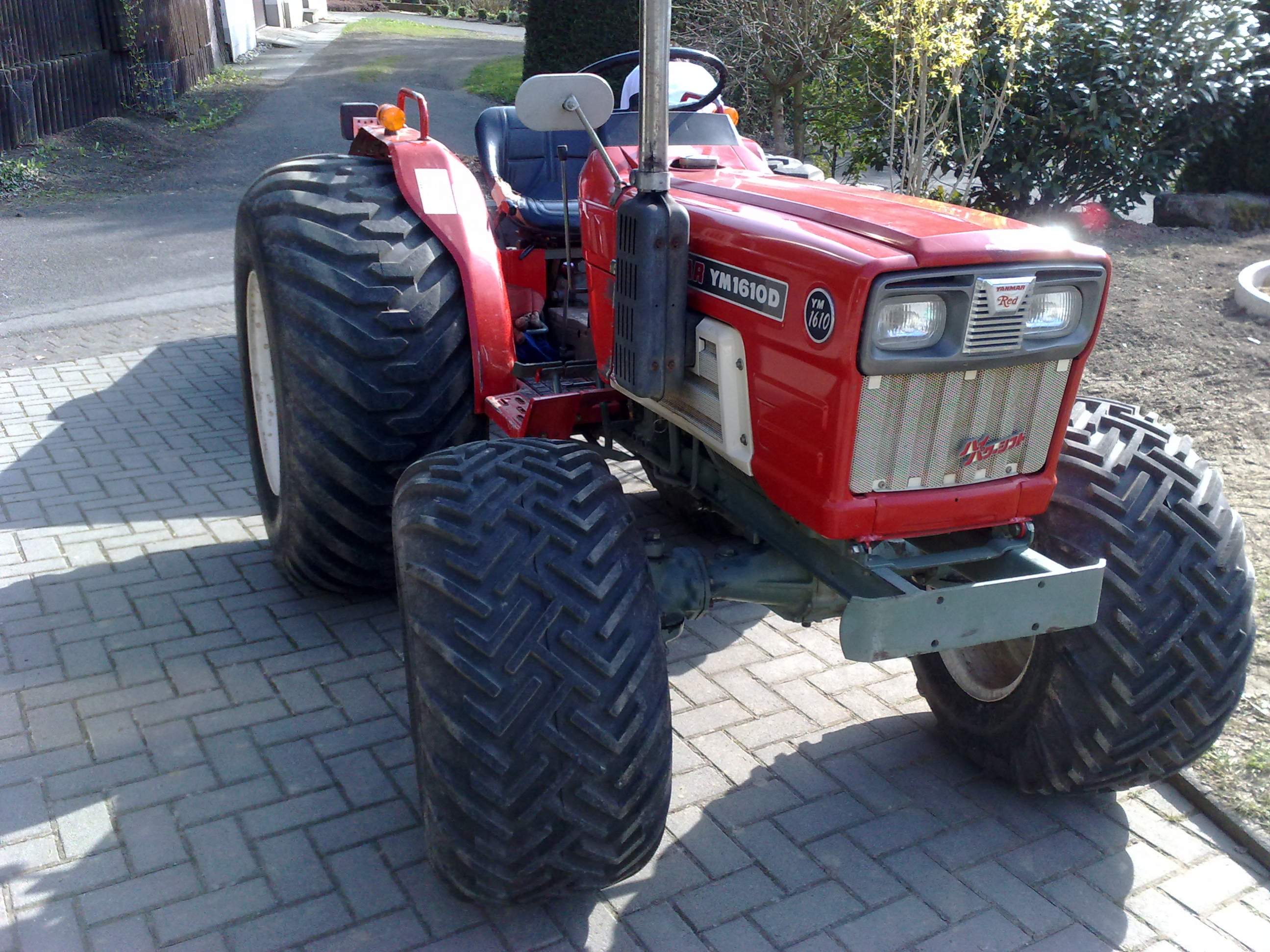

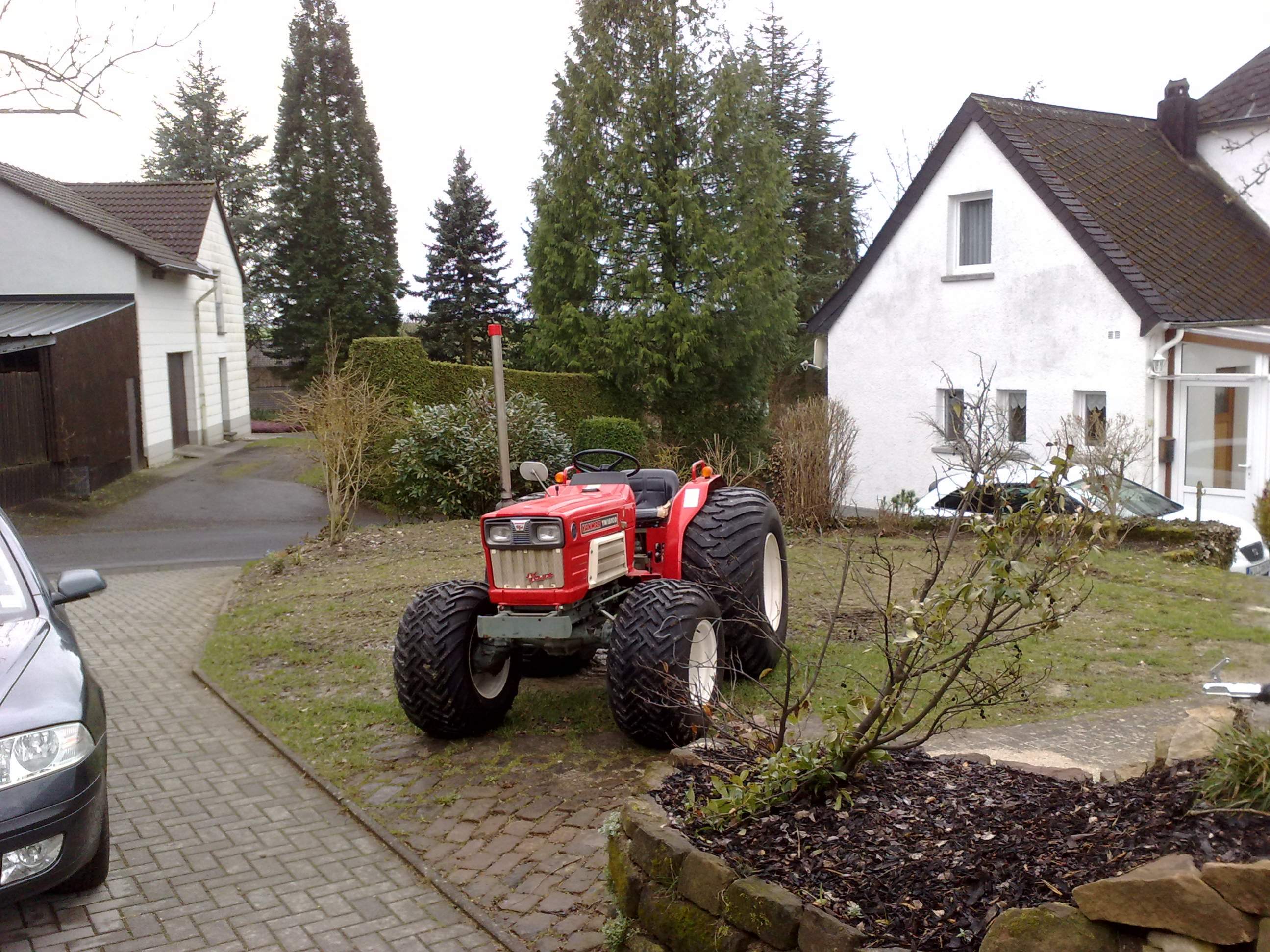

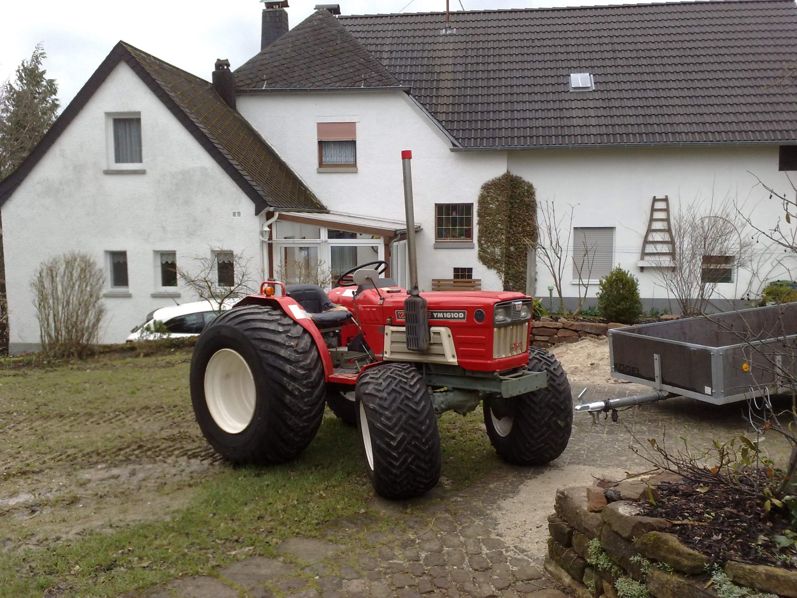

#34
Had a lot of testing thru the last weeks,
drove two times about 20 mls thru the hard forest. no problems with the wide tires.
one pic with fenders.
ps. it doesnt swim. :confused:
