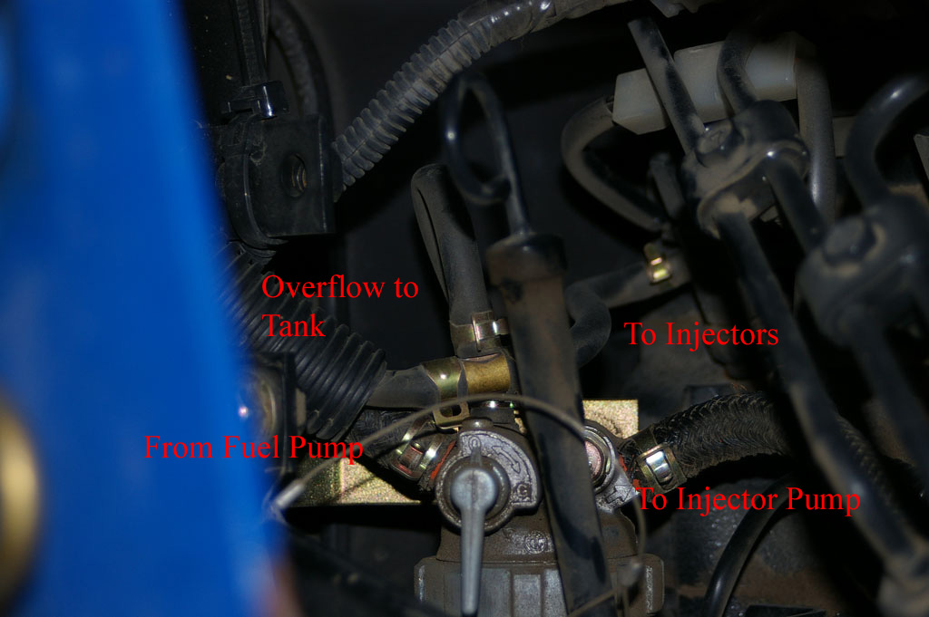

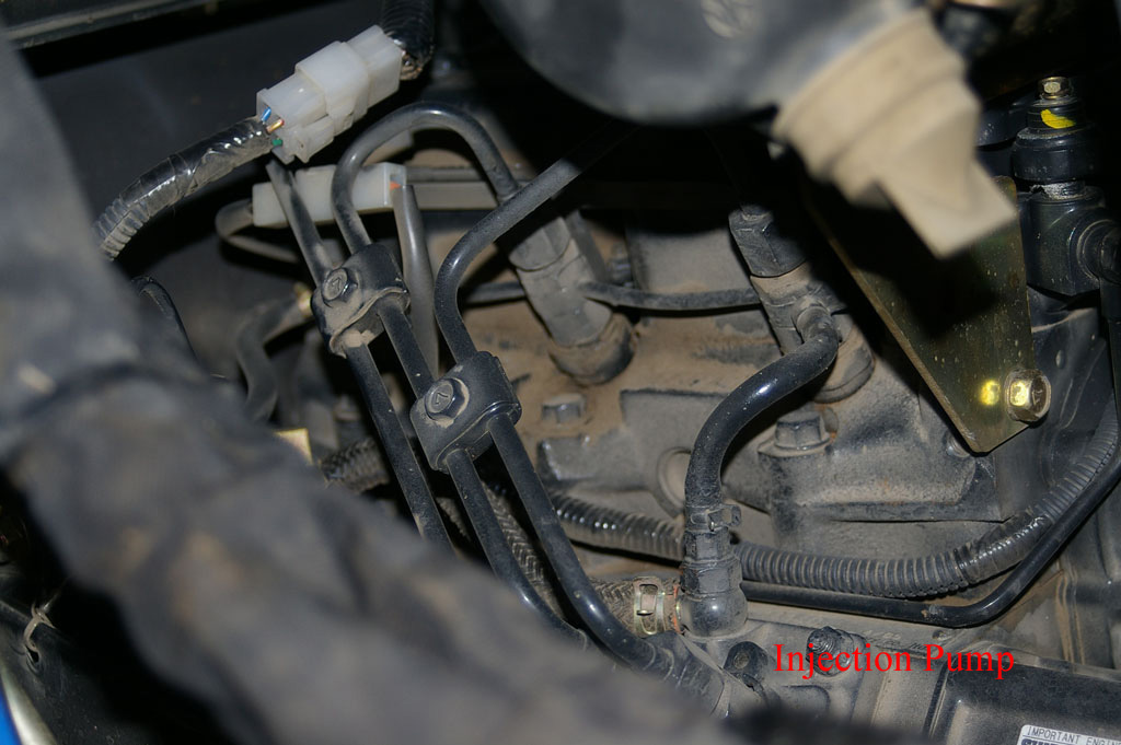

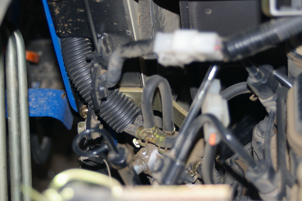

Here's some pics ... they're looking at the fuel filter on the right side of the engine. I annotated the photo of the top of the filter assembly to help identify which hose goes where. Notice that on mine, the #50 hose is looped and almost kinked.
If the tech said that it bled slowly, it's probably a plugged or pinched hose somewhere...or maybe he just didn't know the proper procedure for the TZ's.
