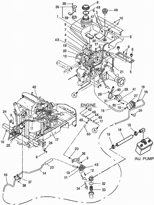

Boy, you aren't kidding when you said complicated fuel system. Looks like a maize to me. lol Of course, even the simplest would appear that way to me.

Hey, thanks for the picture. That should be quite helpful....well, for my husband, that is. :) I don't know that I would know what I was viewing?? :rolleyes:

Here's some pics ... they're looking at the fuel filter on the right side of the engine. I annotated the photo of the top of the filter assembly to help identify which hose goes where. Notice that on mine, the #50 hose is looped and almost kinked.
If the tech said that it bled slowly, it's probably a plugged or pinched hose somewhere...or maybe he just didn't know the proper procedure for the TZ's.

Took it all apart...no screens in main or reserve tanks, the factory fuel hoses are badly deteriorated and I dislodged rubber flakes from the lines between the main and reserve tank and the reserve to inline fuel filter...the inline filter is doing it's job, finer dark (probably rubber) in there as well. I will replace all fuel lines and both filters at this stage of the game. The tractor is 3 yrs old with 210 hours.

Reassembled after flushing tanks, changing two short fuel lines and new filters... wife says still have same issue! I suspect vapor lock in reserve tank.. Next step is to bypass reserve tank and feed fuel directly to primary filter. The reserve sits in an area that I would consider subject to heat buildup.
