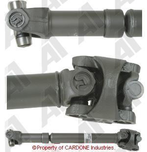

Just replaced all three u joints in the front driveshaft of my 99 F250 SD. Had a shop do it because of that double u-joint, some things I have learned better than to even try. Even in a shop that does these regularly, it gave them fits-had to cut the old joints with a torch to get them out. My rant is about the grease fittings on u-joints. there was just not enough clearance for the zerk mounted on the body of the u-joint. One was sheared off just from picking up the shaft. After figuring out that the fitting was just too long, finally found a cup type fitting that uses a rounded needle. Clearance was not a problem, still can't grease into it. THen I tried to grease the other joint, can't even get the end of the grease gun into the joint, much less even being able to attach it to the zerk.
SO, why do they put the zerk on the body where you can't get to it? Why not put them in the end cap? I do like to keep things greased that need it, but with these joints it is impossible unless you disassemble the joint-not going to happen.. Can you drill a hole and install a zerk in the endcap? The originals lasted almost 200K miles, would be nice to get similar life out of these. It is the front shaft, but I leave my hubs locked most of the time, so the joints rotate, they are just not under pressure most of the time.

It is not a double u-joint, it is a constant velocity joint. If they had to cut it to get it out, they don't know what they are doing. If you position the u-joints in the CV properly they will have the clearance needed. Most of these including the spring loaded CV member can be greased easily with a needle point adapter on your grease gun. If they messed it up that badly I would think you will be replacing parts again soon. Personally, I would have someone else rebuild it properly.

A double u-joint with a centering ball on a front 4wd driveshaft is also known as a CV joint. Easier to say than cardan joint. You also have to grease the centering ball w/spring which provides pressure for the constant velocity effect. I again will say "a properly rebuilt cv joint is greasable with a needle point adapter($5.00) on a grease gun".

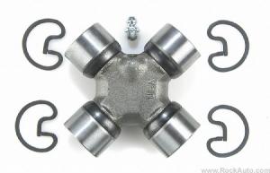

Awhile back I drilled a bearing cup just to see if I could do what you suggest. I couldn't touch it with a regular bit and had to use a carbide one. It was too hard to thread with a good quality HHS tap. I never did buy a drive in zerk to see if that would work but I did turn the threads down on a threaded zerk to see if it would drive in, which it did. It wasn't a real tight fit since the bearing cup was too hard as in not elastic enough to expand slightly and grip the threadless zerk and I wasn't really confident that the centrifugal forces acting on it wouldn't dislodge it. There wasn't a lot of meat left where the threads had been after I turned it down and I never did field test it.
That being said, apparently MOOG does have what you are asking for.
MOOG Super Strength Universal Joints

I have drilled MANY u-joint caps for grease zerks. Works perfect every time. Drill it out, tap it, install the zerk. Problem solved.
Not sure why everyone says they had trouble drilling it..?? I use Caterpillar drill bits and a 1/2" drive high torque low speed air drill.
