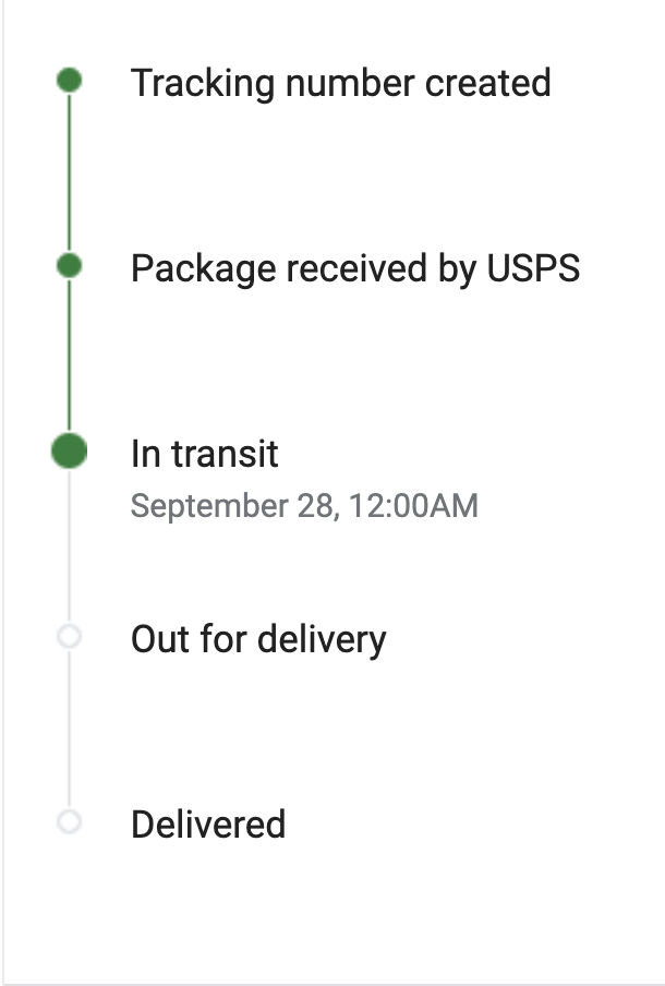

I mailed it out on 9/17 and looks like I'm having a delivery issue with USPS. I ordered another kit, will resample, and switch to UPS.

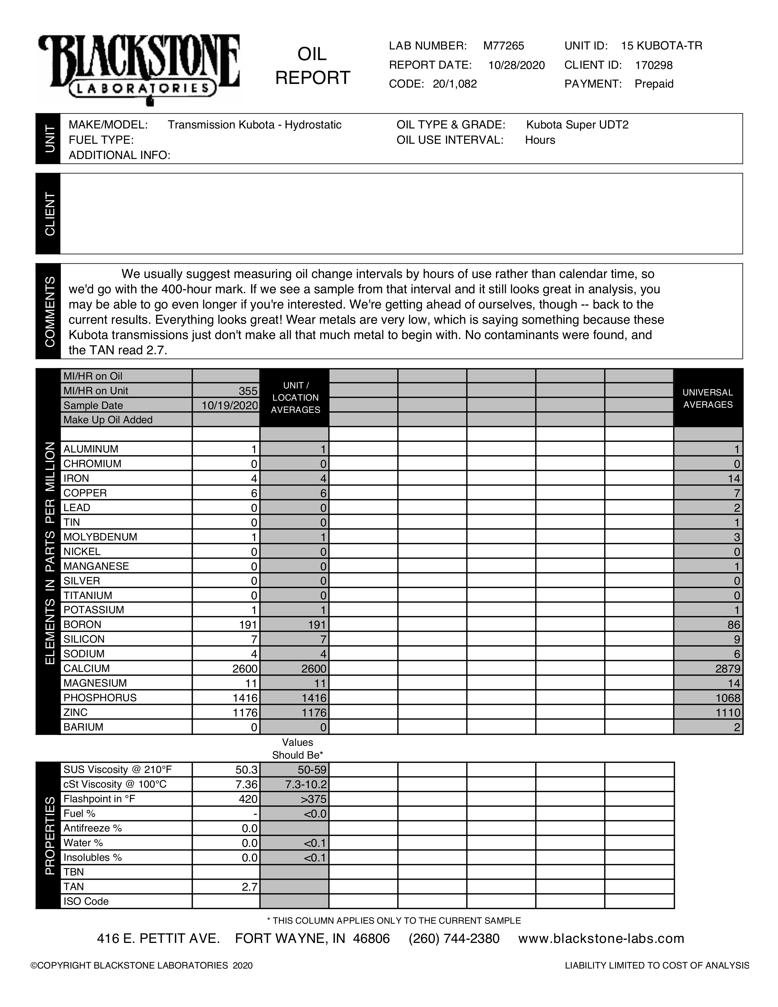

Here is the report guys,
I opted for the extra $10 tannin result, I'll call them to clarify that one, and I haven't taken the time to make a more precise interpretation but the notes say its good to go. I'll follow up with another comment on the results if I have anything worthwhile to share.
Here a copy of the explanation the website offers for the transmission and a jpg is attached of the actual report.
Transmission Report Explanation | Blackstone Laboratories
Cheers!

Now send in a virgin sample of oil straight out of a new barrel and we can see what are the measurable differences!
   / UDT2 Maintenance interval, time vs. hours
#28
At that rate I would also need a sample that was over the hour limit to get a true gauge of where I'm at.
