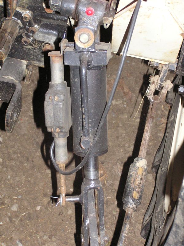

The UFO cylinder "leaks" down when I have the lift arms up and an implement attached. Any ideas on why and how to fix? Thanks.

For those that do not know what the UFO is, it is a control system to help automate the adjmt of the 3 pt lift and specifically to raise, lower and adj the tilt of the 3 pt. It's purpose is to control the depth of the tiller used in the rice paddies. The newer systems can be adj and then used during at the end of a row to raise and lower the tiller. Press a buttom and the tiller raises and push another button and it lowers to the preset position. Ernie could tell you more than I know about the later designs and all the things they can be used for.
This thread has to do with the hyd cyl on the right lift arm which controls the tilt. This cyl replaces the normal manual operated right arm normally found on most tractors. The tilt can be adj't from the drivers seat via the controls mounted on the right fender.
Taking a look this AM, I don't see where this cyl can be rebuilt which it too bad. If that is the case, you need to find a used one like Ernie has mentioned. Ernie, you holding one for me? :D

Don't have any expectations of failures but one never knows.
Nice knowing there are a few dealers out there that have knowledge and parts for some of these newer models, F series.
It is a pleasure to be able to adj the 3pt tilt on the fly with a simple movement of a lever close by. Think I'm getting spoiled.
Little disapointed to see the pics I posted have been cropped a little as what I posted showed more of the cyl being discussed. Along with the cyl there is a switch assy that tells the control when the link has the 3pt level.

I could only find one knob under the seat. By turning it I was able to change the rate at which the lift arms would drop. With the valve all the way off, the UFO cylinder still leaked down. I have fabricated a replacement and secured the hydraulic cylinder off to the side until I can remove it and get it repaired or replaced. Mickey, I am curious what would prevent this cylinder from being rebuilt?

Looks like I was all wet in saying these cyl were not rebuildable. Went outside and looked again and while all the top end of the cyl is welded together on closer inspection I noted on the lower end it looks like the end is screwed into the cyl and needs a spaner to lock into end cap and unscrew.
