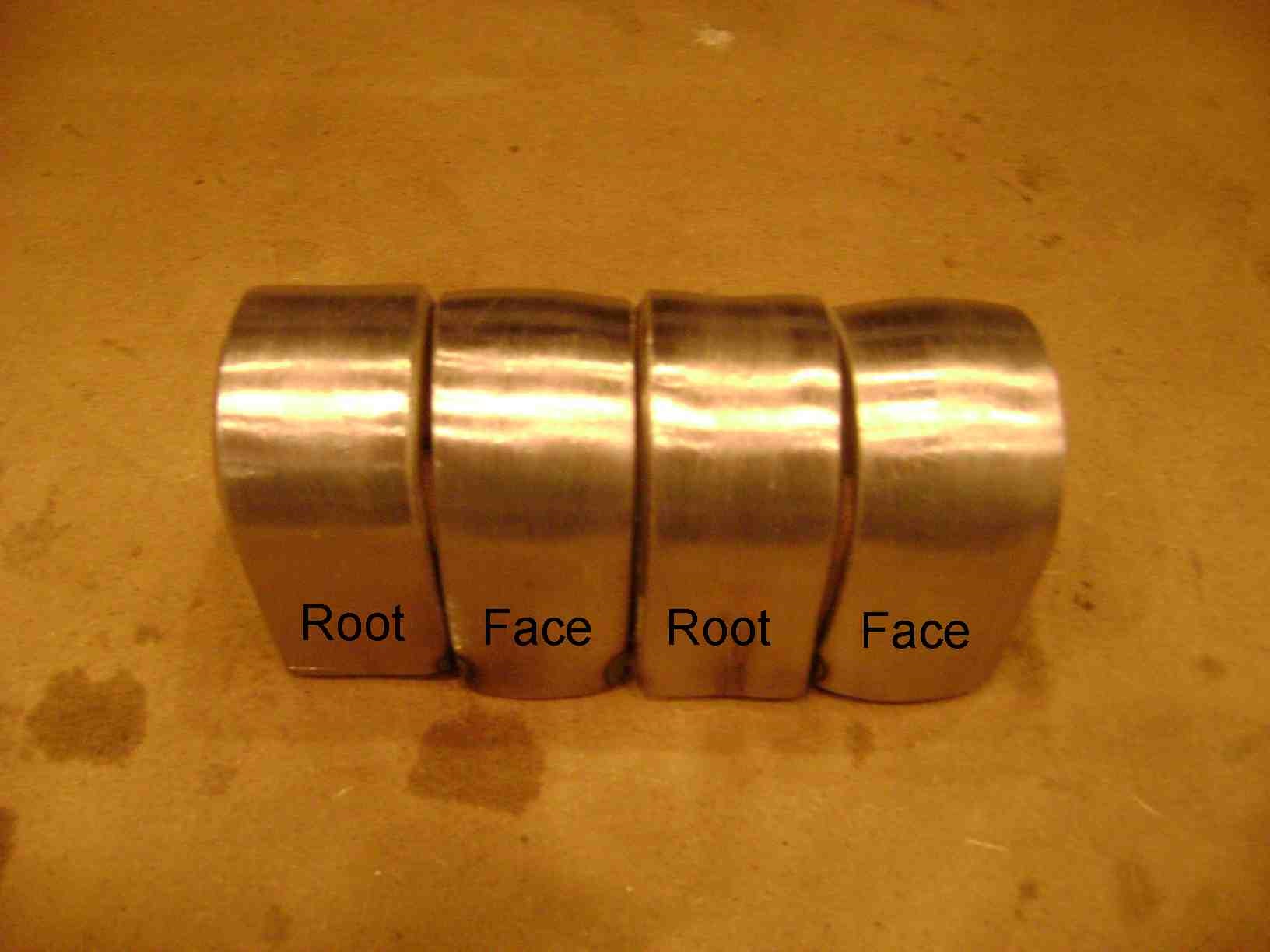

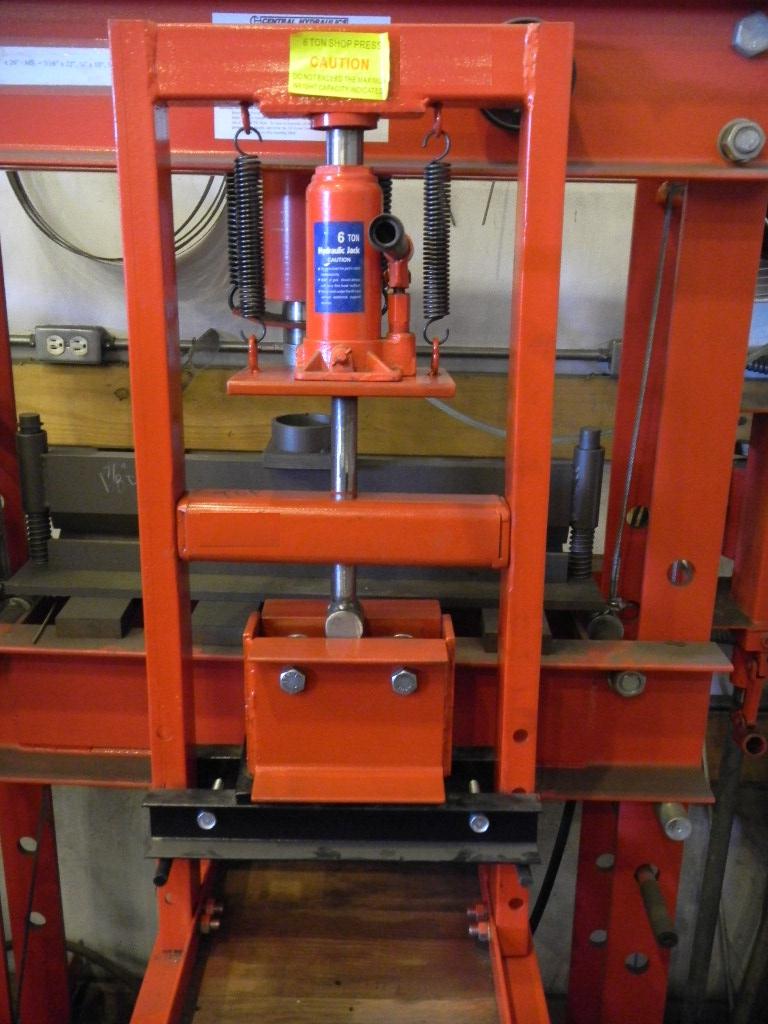

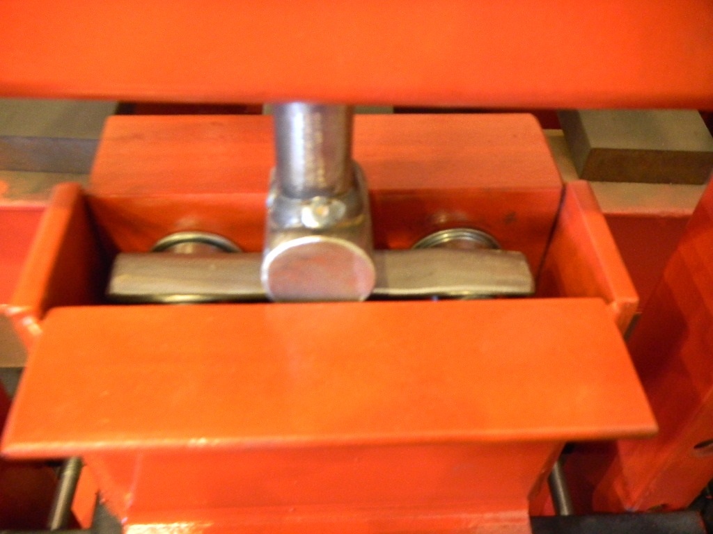

Back when I was taking a class in high skool, we had a rig where we'd bend our welds. It was interesting because you'd have the perfect looking weld, but it would crack when bent. The test piece was two 1/4x2" bars with a butt weld. You'd put the weld, facing up over a bottle jack that had two rollers a couple of inches apart. You work the jack and it would bend the bar into a U between the rollers. I referred to it as the "torture rack".
   / Ugly beads, critics welcome... #182
We use to call them the heart break machine. :laughing:

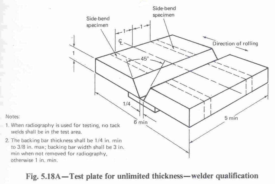

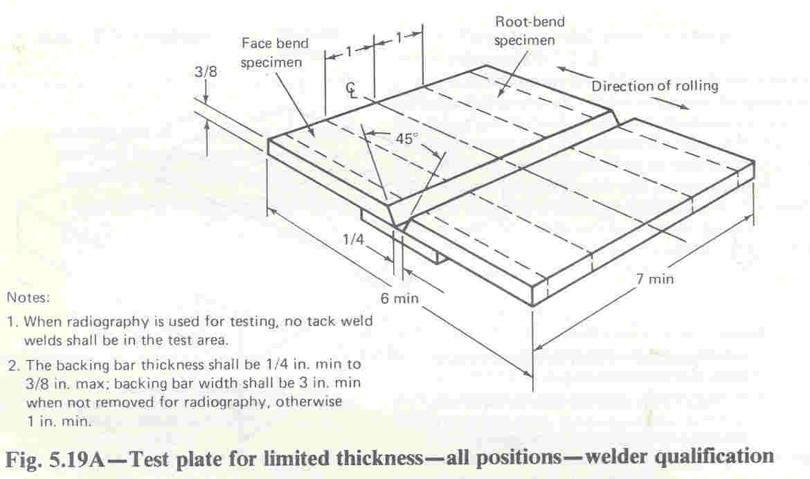

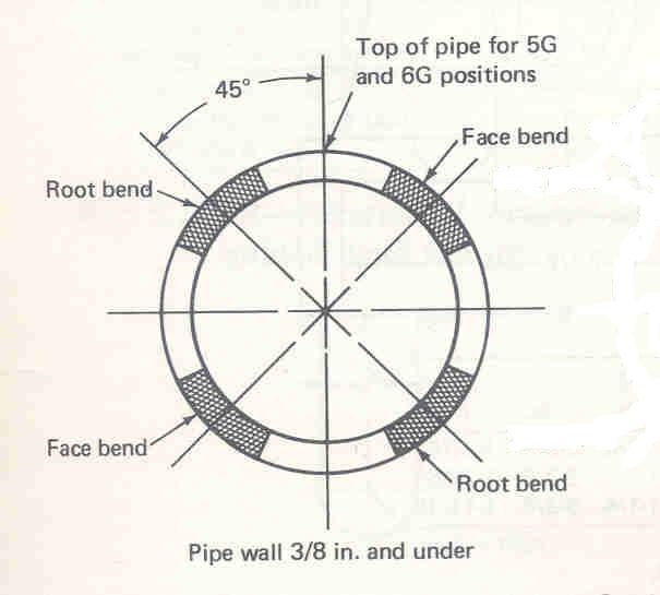

I'm going to buy or build a shop press, and plan to do some torture testing of my own!

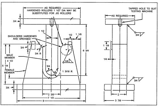

If you want to build a coupon bender, here is a print.
