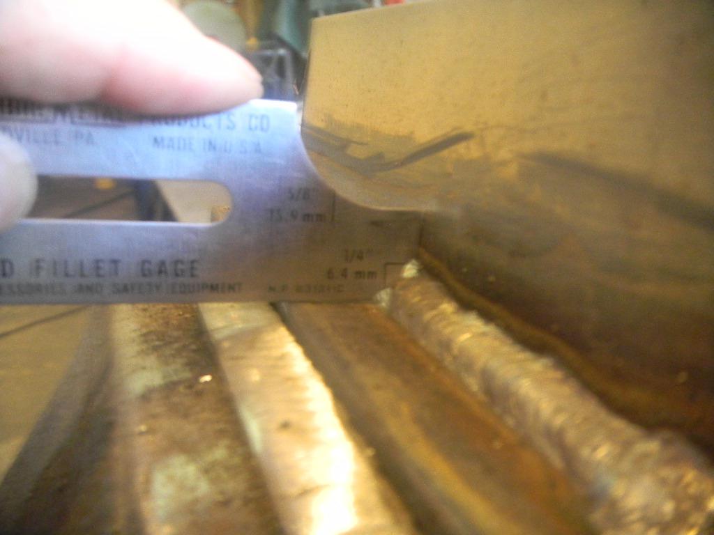

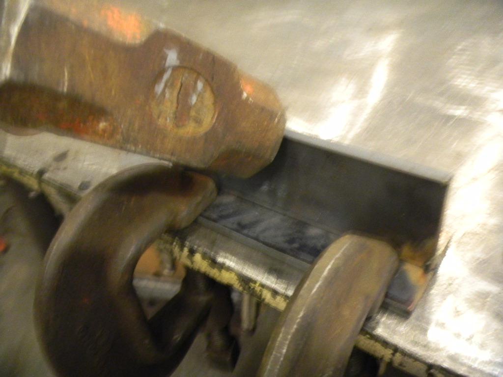

That doesn't look bad at all. Doing some break tests would help to see how much penetration you're getting.

Needless to say, this is going to take a lot of practice :shocked:
Not really! I am very impressed with that vertical up hill weld!:shocked: For the amount of time you have been welding, that is very impressive!:cool2::cool2::cool2:
Oh, that little PowerArc 200ST runs about 15-amps hotter than my Lincoln V350-Pro.

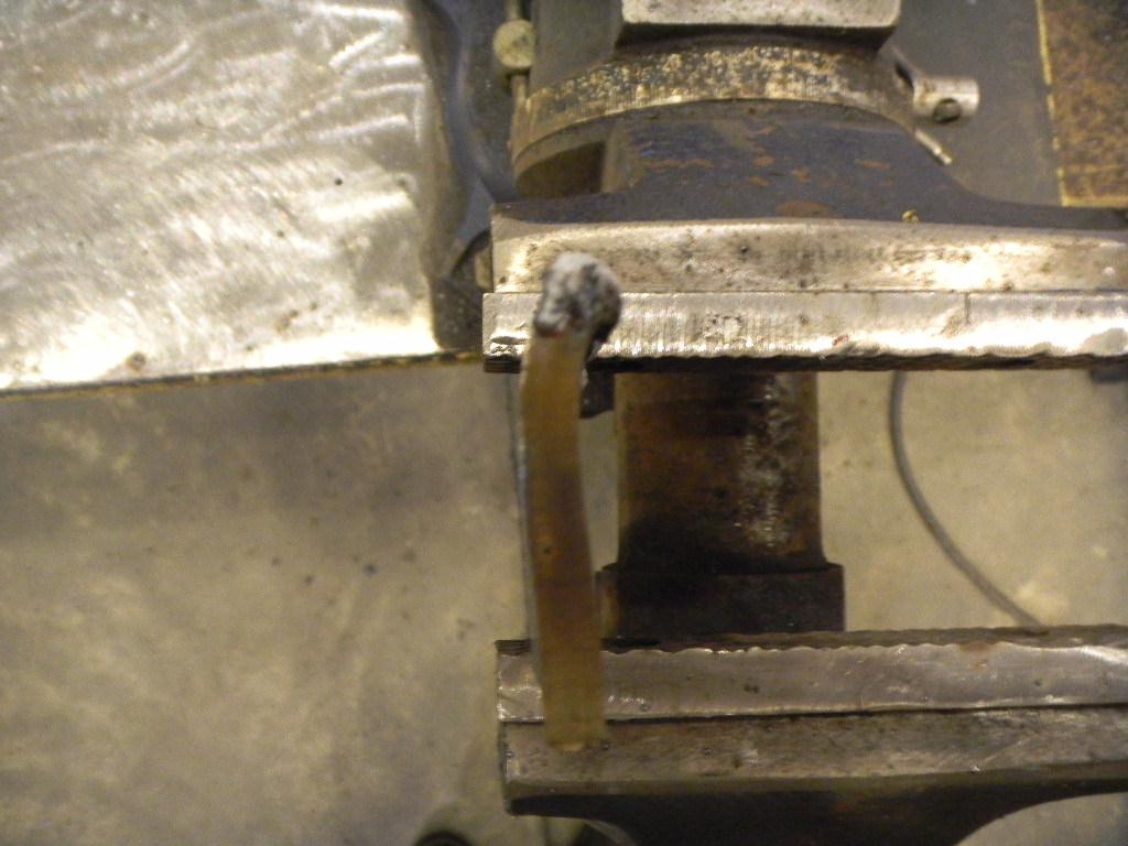

So just weld on one side, then put it in a vise and hit it with a big hammer?

Thanks...you guys are being very kind, but I'll take it!
I can definitely see how the PowerArc 200ST runs hot, but that's not a bad thing since I can only imagine it will do some pretty thick material at 200amps!

   / Ugly beads, critics welcome... #168
   / Ugly beads, critics welcome... #170
If you have a shop press with a gauge on it. It will tell you how much force it takes to break the weld.
