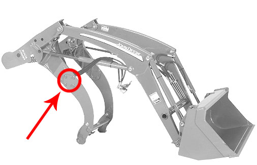

I assume that the bolts in question are circled in the enclosed picture.
-nosualc
   / Uh-oh! 300CX loader
#12
Yeah,
The cluster of four bolts directly above the front axle when the loader is down... button heads to the inside... every bit painted green...
Looking at the remnants, I see a bit of rust in the fracture area, so the cracks had been there for some (?) time...
Talked to Peabody Lawn & Leisure in Houlton, they asked me "what do YOU want us to do?" In the good sense, as in whatever you need, give the word... GREAT dealer!
I asked for seven more replacements so I could swap them all out & torque them myself, and they'll be here by Saturday! /forums/images/graemlins/grin.gif

Based on what has been described the broken bolts sound like a classic case of Hydrogen embrittlement. Are they zinc plated?

Yes, nosualc thank you!
Where did you find schematic? /forums/images/graemlins/tongue.gif
   / Uh-oh! 300CX loader #19
browns40
I sent you a PM. Can you check it. Need picture /forums/images/graemlins/smile.gif
   / Uh-oh! 300CX loader #20
browns40,
Not really a schematic, it's a black and white photo from the operator's manual that they have posted online. I nabbed it, and Photoshop'ed in the red circle and arrow.
