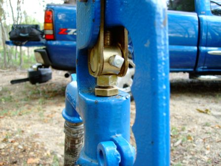

There has not been any problem with the other 5 hydrants. Only the one I frequently use. This one is also the only one I've oiled. Maybe the oil got under the setscrew and is what caused a problem.
On a related note, I now have a product/manufacturer endorsement for Simmons Manufacturing (hydrant maker). After I called them to order a replacement "connecter", their technical rep CALLED ME to get more information and to offer to sent the part under warranty. He also hand inspected the new part before shipment to be sure it was up to quality standards (had well-formed threads). Evidently they have had some past issues with the threads for the setscrews not being cut too great. So they volunteered to make it right for me for free. I still think I'll thread the main rod and add some nuts!

You might be able to drill and tap that set screw hole for the next larger bolt size. It may be worth a try if you are going to replace it anyway.

All better.
I had to trim down the packing nut a bit to make enough clearance for the nut, but it works great and is easily adjustable.
