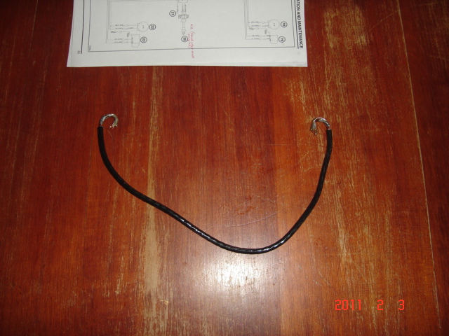

glad to hear your gc is back up and moving snow,after 20 yrs working on heavy equipment in the mining industry you learn quickly to check for grounds,ie loose,dirty or broken my gc had the flat braided ground wire/strap and it broken clean off from vibration,i replaced it with a short piece of 2/0 battery cable with battery eyes,i have been a lurker here but now i will post more frequent when i get a chance,glad to be of help and glad to be on board with a great group of people
/ Uh-oh. This could be serious.
#24
Well revver, you sure saved my bacon; very glad you decided to post! :thumbsup:

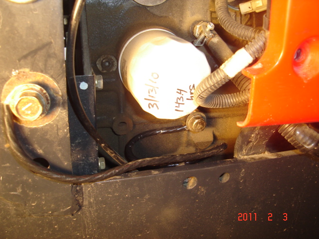

I did notice, in my service manual, the photo of the GC oil filter showed a braided ground strap in the background, with a nice gentle U-turn. Guess some bean counters got a real deal on the very short --barely long enough-- stranded ground cable that I had on mine. :mad:
All is now well, and I've just completed cleaning up; couldn't stand it, said I wasn't coming in today, had to get my snow removal equipment repaired. Hate to do that, but when I've got a major mechanical or electrical issue at the home I just have to get it fixed. It just eats at me until I get it done. Had the LRB (Little Red Beast) up & running by about 11AM.
We got about 18", maybe more, and I sure am grateful for my neighbor with the plow- it allowed my daughter to get out this AM with her AWD van without dragging its belly, but... my driveway became about 4' narrower, and I had these huge piles of snow....

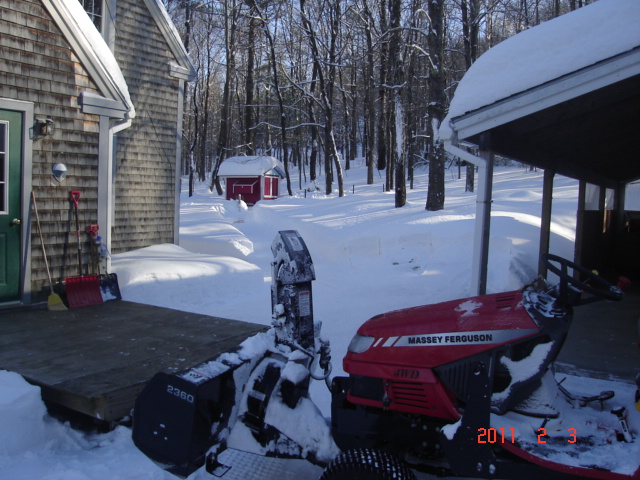

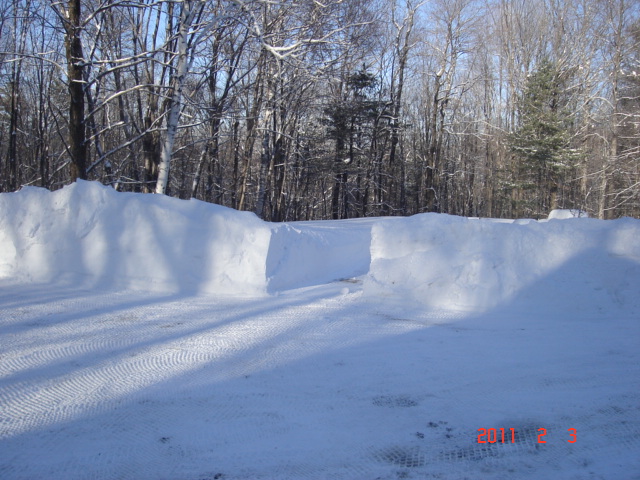

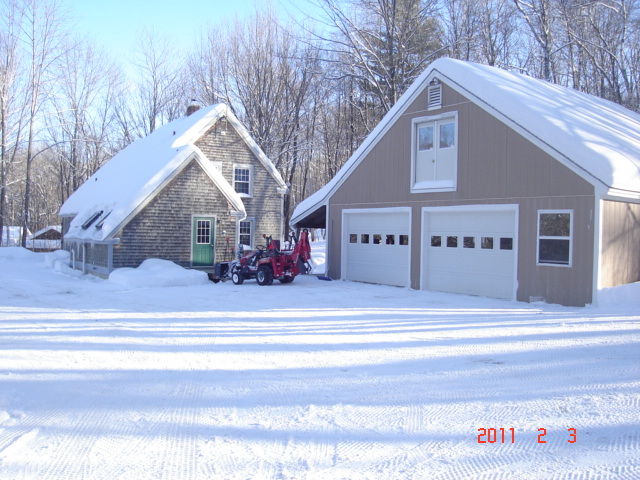

Here's some before & after pics!
  • storm 2:3:11-before blowing.JPG
  • storm 2:3:11-after blowing.JPG
/ Uh-oh. This could be serious. #26
Hi irvingj,
Nice photos, couldn't help but notice that you have the snow-blower shoes on backwards. Was that intentional?

Jaylegger- yes, backward shoes are intentional; I also asked about that when I bought it. Rick @ Northwood Power explained that it was far better at NOT catching on stuff when it was turned that way. I think he was right!

After thinking about it, I was remembering that a year or so ago, the tractor seemed to be harder to start--at least, for sure not starting as well as it did when it was new.
That ground cable- was stranded copper, and obviously had to have all but one or two strands broken before it finally let go last Wednesday.... Might that also have something to do with the starting??
I found that, even when outside temps were warm, I still had to give it some glow to start. There was a thread about this; seems I wasn't the only one experiencing this. When it was cold, sometimes it didn't seem like the glow plugs were helping at all....
Well, here's my thinking: With half --or maybe most-- of the strands already broken, and any significant amp draw apparently uses that ground strap/cable for its ground path.... The tractor was probably having a bit of difficulty with both cranking and glow-ing, ever since those strands started to let go.
So I went out this AM, 15F; the tractor hadn't been run since Thursday, and I tried to start it with NO block heat.
And it did!! It took three tries, all with 20-30 seconds of glow, but it did start & run well once it began to pop. I'm also almost certain cranking speed was higher than it had been, which I'm sure also helped.
So- any others experiencing the need for glow when the tractor seemingly shouldn't need it... check that ground strap!:thumbsup:

Walt, I have that same ground wire on my tractor. Black with a yellow stripe? It seems intact, but based on your experience I'm going to do a braided strap upgrade soon.
My MMM arm brackets are intact. I don't see how they would get stressed, they look like more of an alignment guide than a strength thing. You must have got the factory's new guy welding yours up.
I bet your glow and cranking problems were related to insufficient ground. High amps need big wire to travel on, and if it was 'half broken' the wire had less capacity. Your tractor was still starting, but I'd bet it warmed that ground wire up pretty good.
#38
"I bet your glow and cranking problems were related to insufficient ground. High amps need big wire to travel on, and if it was 'half broken' the wire had less capacity. Your tractor was still starting, but I'd bet it warmed that ground wire up pretty good."
YUP! Never felt it, but I'm betting it was pretty warm. And yes, the ground cable was short (too short, methinks!), black with a yellow stripe.
Not only did it start without block heat the other day when it was so cold, but this AM it was 27F here; ordinarily I'd expect to have some --not too much, but some-- difficulty getting it started without block heat, so I'd just plug it in and either shovel snow for a while or have another cuppa coffee.
Today, however, it started immediately after 20 seconds of glow. :eek:
Hasn't done that in a while!:D:D
