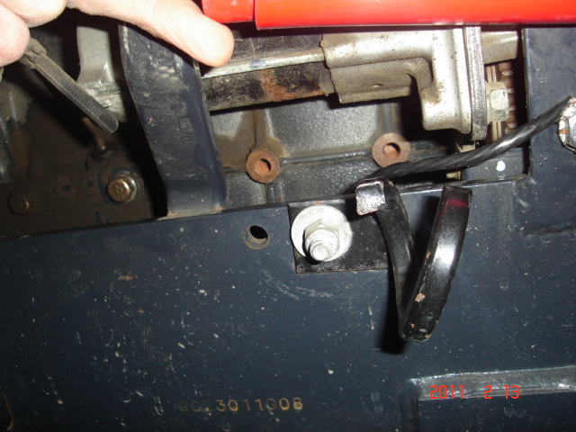

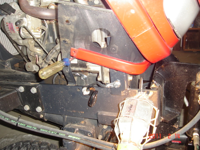

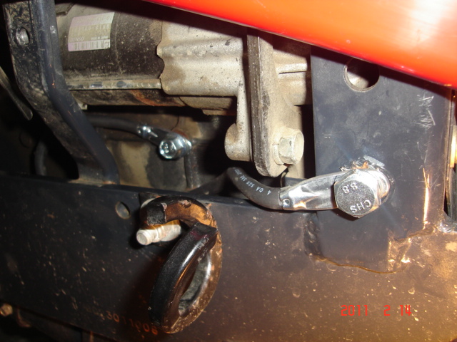

glad to hear your gc is back up and moving snow,after 20 yrs working on heavy equipment in the mining industry you learn quickly to check for grounds,ie loose,dirty or broken my gc had the flat braided ground wire/strap and it broken clean off from vibration,i replaced it with a short piece of 2/0 battery cable with battery eyes,i have been a lurker here but now i will post more frequent when i get a chance,glad to be of help and glad to be on board with a great group of people
   / Uh-oh. This could be serious.
#24
Well revver, you sure saved my bacon; very glad you decided to post! :thumbsup:
I did notice, in my service manual, the photo of the GC oil filter showed a braided ground strap in the background, with a nice gentle U-turn. Guess some bean counters got a real deal on the very short --barely long enough-- stranded ground cable that I had on mine. :mad:
All is now well, and I've just completed cleaning up; couldn't stand it, said I wasn't coming in today, had to get my snow removal equipment repaired. Hate to do that, but when I've got a major mechanical or electrical issue at the home I just have to get it fixed. It just eats at me until I get it done. Had the LRB (Little Red Beast) up & running by about 11AM.
We got about 18", maybe more, and I sure am grateful for my neighbor with the plow- it allowed my daughter to get out this AM with her AWD van without dragging its belly, but... my driveway became about 4' narrower, and I had these huge piles of snow....
Thanks again --to all-- for contributing to such a great forum.

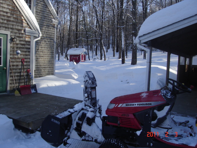

Nice photos, couldn't help but notice that you have the snow-blower shoes on backwards. Was that intentional?

When the ground goes bad all sorts of hinky things can happen. It is usually easy to find if it is just a no start, but I have seen all sorts of weird stuff happen that were caused by a faulty ground.

Jaylegger- yes, backward shoes are intentional; I also asked about that when I bought it. Rick @ Northwood Power explained that it was far better at NOT catching on stuff when it was turned that way. I think he was right!
