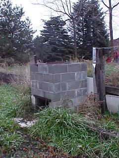

You poured the block? That's what it looks like from your pic. Very heavy duty. /forums/images/graemlins/cool.gif

</font><font color="blue" class="small">( You poured the block? That's what it looks like from your pic. Very heavy duty. /forums/images/graemlins/cool.gif )</font>
Yep, not as much work as you think. A few bags of premix was all. This is mod #4 I think.
1 - barrel propped up on 2 layers of 8x16 block.
2 - blocks stacked loose - no liner. Blocks burned out in only a few seasons.
3 - Mortared blocks - no liner - Blocks burned out but took a few more seasons before it collapsed.
4 - this one. Mortared and cores filled, with liner. Was doing alright but you can see some cracking already.
Now that I have it pretty well perfected I can't use it. This state (Wa) last year ran adds in the papers asking good hearted citizens to rat out anyone they saw using a barrel and I am right on the highway. Still sneak in a few burns a year tho. I hope to get a shot showing the entire front and side but having problems with it. bczoom may post it for me.

Front/side view for a bit of clarification. The bottom two rows are 8x16, the remainder 6X16 yeilding a ledge for 4 iron bars to rest on. Those need replacing regularly too as they also burn up. Ashes fall through the bars and get shoveled out. The lintel is two pieces of heave guage (3/8" IIRC) angle iron.
Thanks to bczoom for his help with this
Harry K
