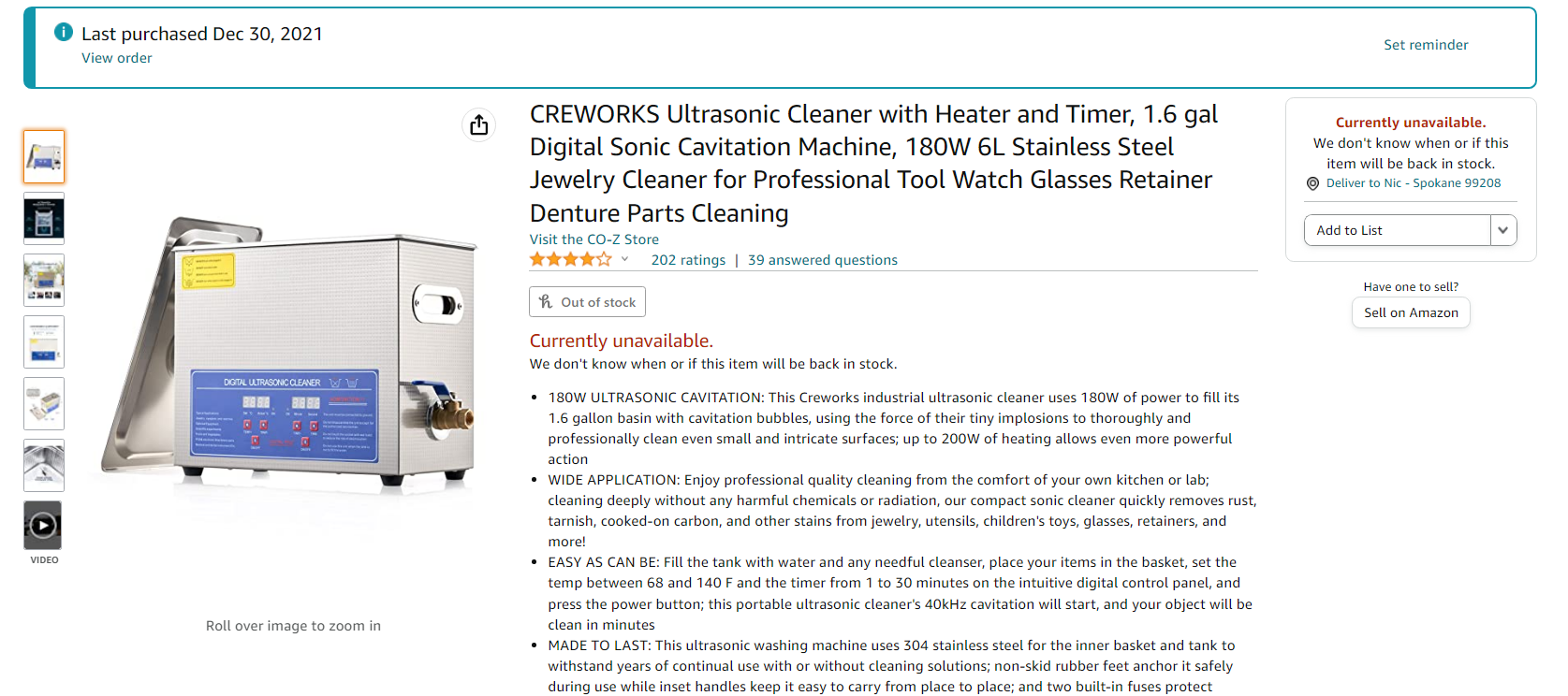

Thank you very much for posting your experiences and methods. I have been looking different machines for a future purchase. I did not know you could isolate items and solutions in containers like that. That is great information.I have this one:
It hold a LOT of fluid. When doing large items, or lots of small items, its very nice to have the capacity. But thats a LOT of cleaner! The grease and oils that come off of some parts can be a pain to clean out too. For doing jewelry, I really dont want grease in there. I discovered using simple tap water for the bulk of the cleaner. I use little jars, ranging from very small glass jars, up to qt size ball jars. Peanut butter jars are really good. These jars hold the cleaning solution and the object I'm cleaning.
Here is the process. I put a small carb or carb parts into a peanut butter jar, fill it with gasoline (OMG!) and put the entire thing in the water. The ultrasonic waves will pass through glass and plastic as if they were not there. Now, I'm not wasting all that cleaner, and my machine stays clean!
