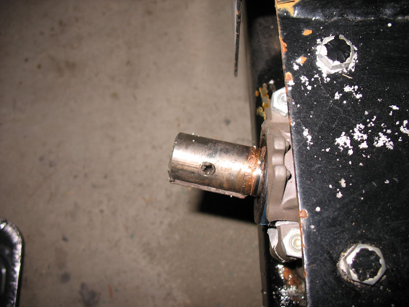

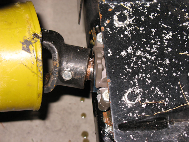

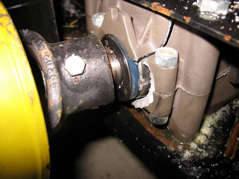

I finally had time to inspect things last night. I'll post some pics down below.
Escavader I'm sure it's not the PTO shaft because I have double checked it's length and how it fits. It's well w/in specs that are given in the manual and does not bottom out.
Honestly I'm beginning to feel like my dealer has steered me wrong and should have suggested a bigger or beefier blower. The gearbox is a Comer Industries L-25J. It must be older b/c I couldn't find the spec sheet on Comer's website, but I did find it on other sites. And all spec sheets I've found state it as being rated for 15HP. And then I have to question MK Martin/Meteor's website because they rate the max horsepower for the blower as 20HP. While my L3400 is like 29HP at the PTO. I'm not sure what to think anymore. But here are some pics of THIS year's gearbox:

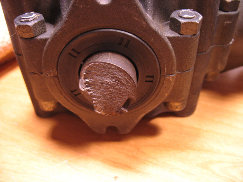

And here's a pic of LAST year's gearbox. It appears the gearbox is OK, but the propeller shaft is, well, you can see:
