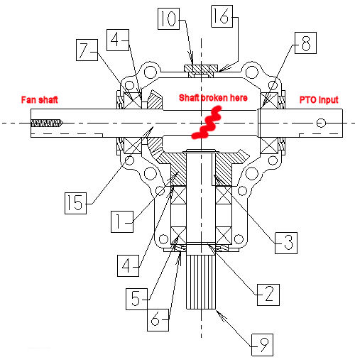

Interesting -- just judging from your pics - last year gearbox was looks like a defective or weak metal shaft. this year gearbox has casing failure and looks cheap. your shaft looks pretty good but too shiny.:rolleyes: . Anyway is it possible that your blower is on cockeyed ? or one of your 3 pt lift arms have too much movement ? Was the chainstay on tight ? I wonder if there was a angle issue here, nothing wrong with your equipment instead? Sorry for these questions - we are just simply not there to see the whole thing.

Exactly what I was thinking. I'm no metallurgist, but I thought both the shaft and case looked cheezy.
The blower was level, I actually put a level on it and adjust the side links until level. And there's really no play in them. The drawbars are tight enough too, maybe an 3/4 - 1" movement to either side. Just for some give.

Looks like a key in the input shaft. Can I assume that the shear pin is on the other end of the drive shaft ?

638 & Kubotafan you're right. It is a keyed shaft w/ a shear bolt on the tractor end. Wicked PITA setup.
Had time to split open the gearbox last night and *&^(%! the same thing happened as last year's! The keyed shaft that the PTO attaches to and drives the fan DIRECTLY broke. So I can't even rebuild last year's gearbox.
I called for replacement parts and replacing the shaft would be about half the cost of a new gearbox. But it would also be 4-6 wks to get a new shaft! That I obviously can not do.
One other little tid-bit, and I'm not really inferring anything here, but I found it interesting that my Comer (Italian) designed gearbox has a big ole MADE IN CHINA stamp on it.
Guess I suck it up and hope it lasts this year. But I have that sinking feeling...

You could get a local machine shop to make you up a high quality shaft. Not sure of the cost, probably 100-250$

A gentleman at Comer's US office was nice enough to email me. He informed me that neither the US or Italy office was able to find a spec sheet on this particular gearbox. But he did inform me that since it is a 1:1 ratio that it is definitely rated for 15HP @ 540 rpm. So to end this long saga basically my dealer hosed me by recommending this blower for my tractor. I'm set up to fail again. Grrr...
