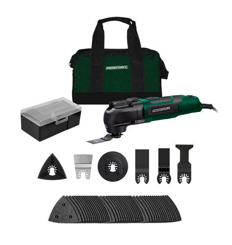

Gentlemen,
Had the deck off my Z Force Zero Turn today to sharpen the blades and clean the deck underneath.
The BEST tool for scraping the grass buildup, but more importantly, the caked on mud that's just like concrete ... is a vibrating tool with the scraper blade attachment. I couldn't believe how quickly that vibrating action of the blade cut the hard packed mud from the steel. Using a putty knife used to take an hour, and the vibrating blade took 15 minutes. Try it, you'll love it!

pictures please. not fully understanding
/ Under Deck Cleaning #3
I don't know if this is it, but I bet this would work.
/ Under Deck Cleaning #4
Yep, I bought my M18 oscillating thing a ma jig just for that. A rounded putty knife for the soft stuff.

The vibrating tools are real handy and work quicker than a putty knife. One of the best things you can do is commit to a hose down after use. Commercial mowers and municipalities pull maintenance on their machines every day or two. If it is awkward to run a hose underneath the deck, make some stanchion or ramp that will help you get underneath the deck. It is time consuming but worth doing. In commercial work, operators figure their maintenance time each day. Your machine will operate better from top to bottom and last longer.

I have a Craftsman vibrating tool my SIL gave me 5 years ago, hardly ever used it, but I tried it on my z force and your right, much easier than a putty knife, thanks for sharing!
