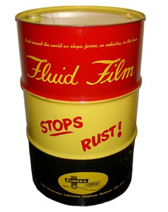

I haven't tried Krown, but am a big fan of Fluid Film. Have done the last three truck with it and have graduated from cans (it takes at least 5 cans for a long bed pick-up) to the gallon containers. It does an amazing job, but you need to re-apply regularly.
I spray the trucks once a year, usually in the warmer parts of Fall as my winter prep. I cover the exhaust with old towels and go to town. The cans work good for the surgical stuff, the sprayer just blows it all over. As a previous poster mentioned, you will need to throw your clothes out and shower outside before going in. I avoid the brake areas, tires, bushings and rubber lines. Each year I find new areas to spray and protect. If you are really motivated, start taking things apart to get the spray into areas that aren't as accessible. Tail lights, the grill, bumpers, etc. If its metal and dull, I FF it. Shiny paint gets washed and waxed.
BTW - my first truck that I did this to was my 04 GMC. It plowed snow every winter as a driveway truck and back-up to commercial lots. When I traded it in 2012, it had zero rust.

On a side note FF is 10% off. I think they were waiting for you to make your big buy :)
I use a lot of fluid film. I spray it on LOTS of things.
They are having their fall sale, on orders over $49.50
10% off every order, free shipping, and a free Fluid Film Keychain
Enter promo code "fall2018" at checkout.
/edit - bought another 12 cans, the last dozen I think lasted me about 7 years.
I just can't yet justify the 55 gallon drum :(
sorry - on sale at Fluid Film Rust Protection

I avoid and cover the exhaust. Same thing with wire harnesses. Consider the FF to be a light grease. Obviously a drip or two will smolder and typically won't do much more. But...
Last year I got it on the catalytic converter of the pickup. I didn't see it and the FF smoldered, but I really wish I was more careful. The smell and fear of fire was enough to be more careful next time.
FF does effect some plastics and rubber. I'm extra careful under the hood and just hit key areas that do not get hot (no engine parts) and not near critical rubber (mounts, hoses, belts). I spray the core support, hood lip, hinges and area, some parts of the fire wall, bracing and backside of fenders. Frame and front horns get fully sprayed. Get some cans for these areas, as they are so much cleaner than the regular sprayer. That thing is a FF fire hose.
FF also collect all kinds of dust and grime (not a surprise). So, while you will protect the underside of the truck, it will be a greasy, dirty mess. But it won't be a rusty, crusty mess.
Also in high splash areas, it will wash off. Wheel wells are a typical place that washes out.
Its a working progress. Do your best this year. Next year, you will see the spots you missed, and hit them. Each year will get better.
