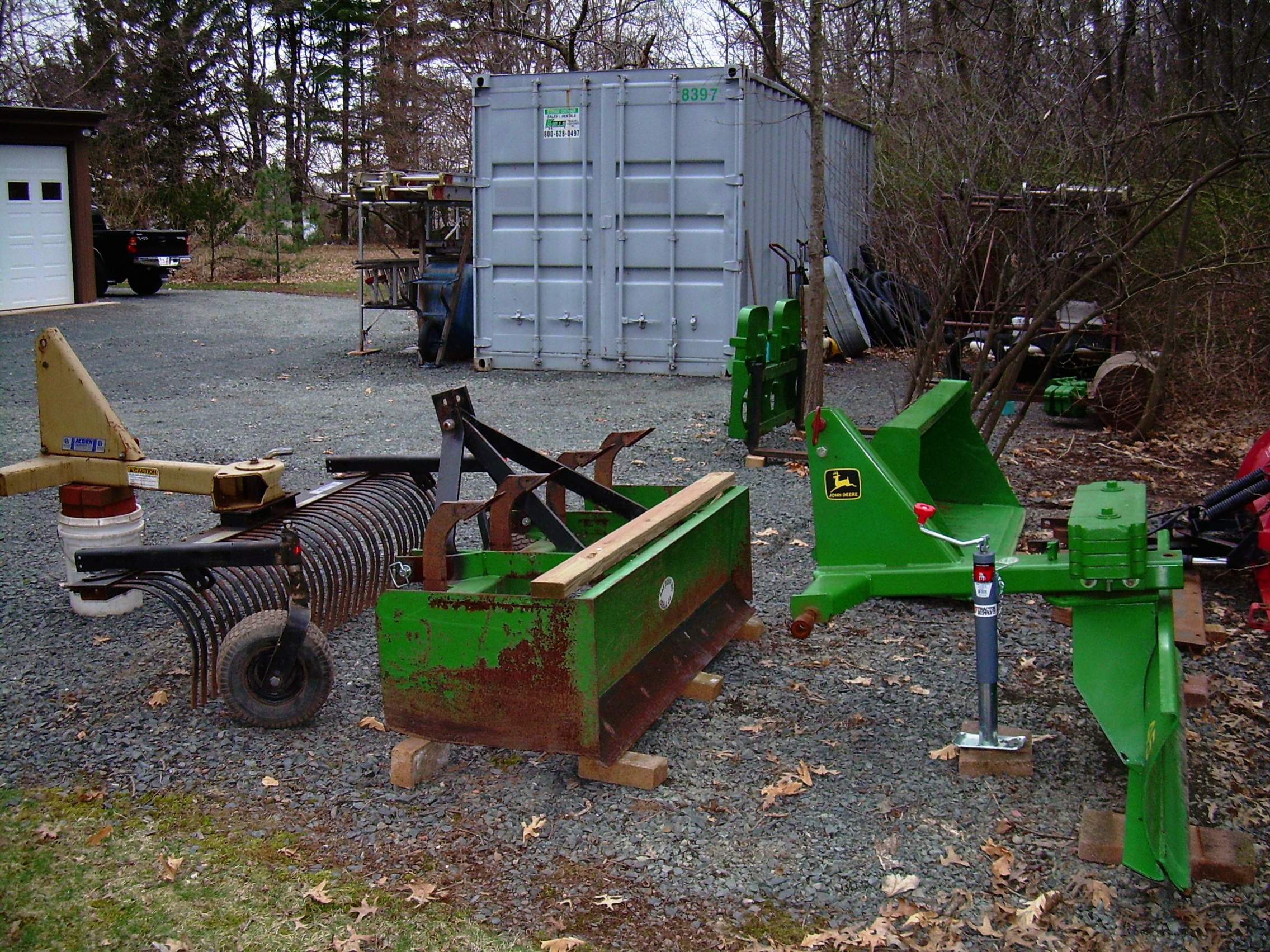

I could almost guarantee mine would not crush under 5 feet of fill, maybe flex inward but not fail, no way. These things, at least the one I have are built like a brick soup can, heavy corrugated steel all around.
Mine you can jump on the top and get very little deflection, I thought they were all built like that, I wouldn't call it a shipping container if it had a plywood roof.
Don't know why you would want the top 5 feet under anyway.
JB
