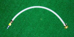

A few years ago, I extended a water line out to a new shed about 200 feet from the closest spigot. I ran 1 1/2" black well line. At the house side, I connected a coupler that then has a hose connector screwed in. I then made up a short length of garden hose about 8" with female ends on both. This allows me to connect to a 2 way brass splitter at the spigot and allows some fexibility when connecting the line for the season. At the shed side, I made up a connector that has a coupler, then a 6" length of pipe, then a air hose connector, another 6' pipe and than a boiler spigot. I fatened this to a piece of pressure treated wood that I fastened to the side of the shed. If I had a digital camera I would post pictures, sorry!
Around the end of November, I disconnect the lower end at the house and blow air through the line using the air fitting and a normal compressor. Blows the line out in 1-2 minutes, and I don't worry about any freezing. The line is only 8" deep. Works very nicely for me and only cost about $25 in plumbing fittings. I plan to run a similar line this summer out the front of the house to my orchard.

Here's a photo of the blowout hose I made. The left end is a quick connect and works like any air tool with my compressor quick connect fitting. The right end works just like a garden hose and will connect to any standard faucet fixture.
