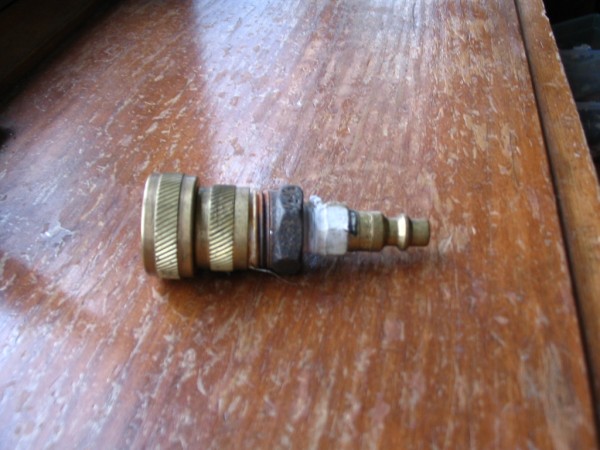

Mike,
Here is the adaptor I made. Does the same thing as Bebsters, just no hose.
