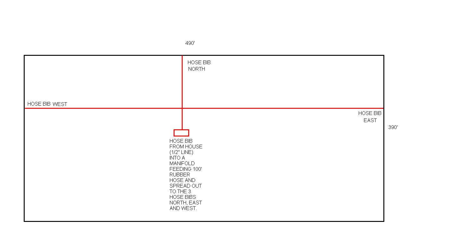

Hey all,
So i have 4 acres and i want to add some hose bibs to the perimeter of my property to allow for easier watering. I have attached a drawing with my property dimensions and approximate location of the hose bib coming from the house.
What i would like to do is:
the 1/2" line from the house into a manifold that would feed 1 100' rubber hose, run out directly to the north 100' to one hose bib have a "X" connection in this line and run out east and west to the other hose bibs. I will not be running all the lines at the same time at most i would run 2 at full blast to run sprinklers.
What size line should the underground lines be to ensure i have adequate pressure? can my current water pressure in my home handle this extra load? what size manifold should i make?
thanks.

The 1/2" line is going to be your flow limitation. Can you run 3/4" or better yet 1" out of the house to the manifold?
See below.
There are two aspects to this -- pressure and volume. Where does your water come from? Well or city? If on a well, what PSI @ what GPM did your driller/pump installer end up documenting? If city water, what size is the main and what is the typical pressure?
The short story here is that you could run a 12" main out to your spigots but you need to first determine whether you can actually source the water at the pressure/flow rate you need.
See above. But in general, for the distances you are running, it will have to be AT LEAST 3/4" and better 1"

I am on a well system, i am not sure what PSI @ GPM i a rated do you know where i can find that info? will it be on my pump or water softner?
So you are saying in order to get adequate pressure to my hose bibs i will need to have a 1" line to my manifold and use 3/4" line out to the hose bibs? or can i use 1/2" out to the hose bibs?
   / underground water lines, what size plumbing #4
I would use 1" throughout... It will probably cost you a little extra, but IMO it is worth it. We have one hose with a 3/4 feed line and one with a 1" feed line and when you open it up you know which you are using.

To make things a bit easier would i be able to use my 1/2" line out of the hose into a 1" manifold then 1" throughout?
Would the 1/2" line inside the house make enough of a bottle neck that it would slow my flow?
   / underground water lines, what size plumbing #6
How much work will it be to change the 1/2" now now vs down the road? 1/2" copper will flow water at 3.2GPM while 1" poly pipe can handle 12-18 GPM (depending on the pressure). That will be quite a bit of difference when you open the hydrant let me tell you.

alright you convinced me.
I will do 1" throughout im just being lazy and trying to save a few bucks.
What type of line should i buy? is there a certain PSI i should look for? or am i ok with any type of pex.

I would use the black poly pipe. Available in large rolls (up to 500' or so) at your local plumbing supply store with pressure ratings from 120PSI up to 200PSI.
I like 200PSI pipe because while it costs more than the thinner stuff, the price difference isn't enough to be worth my time to dig it back up in a couple of years when the thinner stuff fails.
One note, when putting fittings on, a propane torch works wonders to soften the end of the pipe and make the fitting go on easily.

You could also do 1 in thin or thick wall PVC and blue glue. Thin wall will flow more water.
To measure what your pump flow is, take a 5 gal bucket and fill it up.
5 gal - 60 sec = 5 GPM
