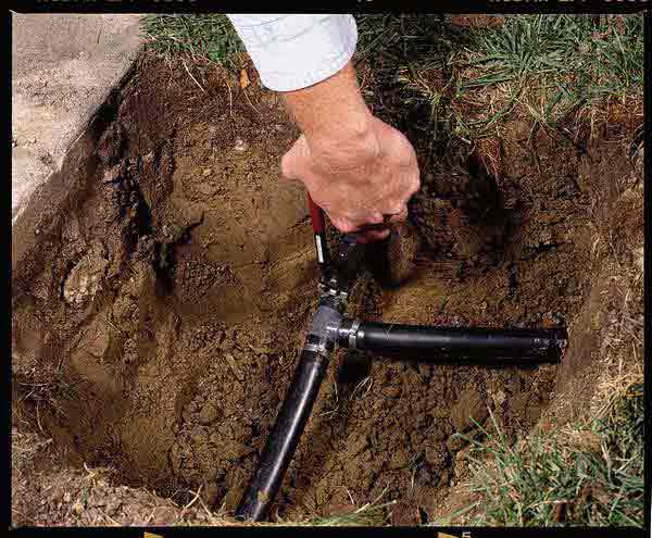

for the barb fittings that will be below ground that will need pipe clamps. i might advise double up the pipe clamps, and then put a small coating of silicon over the screws on the pipe clamps. ran into some problems of pipe clamps stating stainless steal, but for what ever reason they were wanting to rust up pretty good. when i went back and had to fix a leak or redid things and saw how things looked.

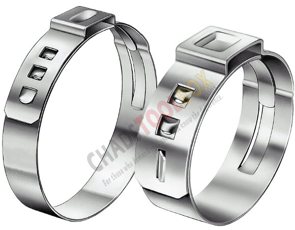

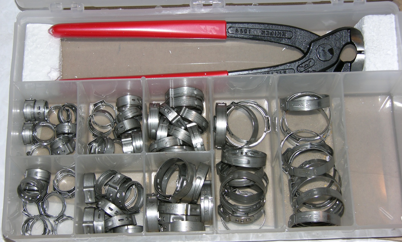

A single quality hose clamp is enough. That said, the right way to to this is to use Oetiker clamps. They go on much faster, are far more reliable, can not strip out, will not corrode, and if you are doing more than a dozen connections the cost is lower even factoring in the upfront investment in the crimp tool.

never needed to use a specialty tool, for clamps, the projects that have came up. there just not enough to invest in a tool and clamp setup. and then buy if need be a special tool to undo the clamp.

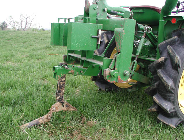

If you have a tractor, you can use the subsoiler to dig and pull the PVC line.
