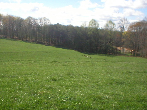

If you'd like I'll post some pictures of the grass hills I pull the trailer up with no problem, they're even steeper. It dosen't matter if it's asphalt or grass, if the wheels aren't spinning I'm not losing traction on either. According to your posts your problem isn't losing traction on the slope and spinning you tires but inadequate power causing the engine to die, this should happen on grass or asphalt.

Here's a picture I took in the spring of a pasture I reguarly go around in. In fact as soon as the weather breaks and it dries up some I've got to go cut up a tree that fell on the fence in the distance and load up the wood and haul it home. I don't expect any problems.
Why don't you at least give a try at unloading the tires and seeing if that will help.
