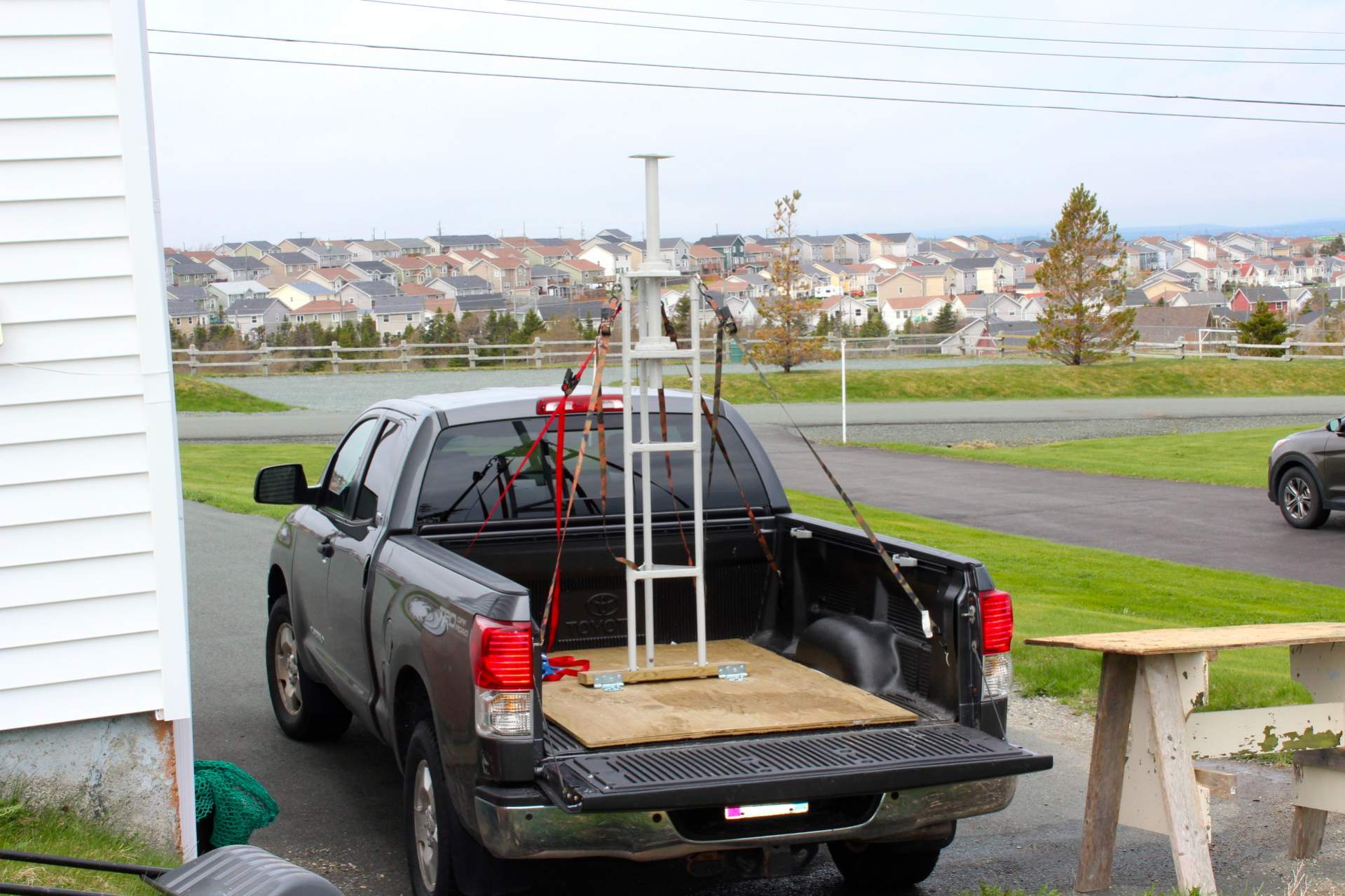

Can't argue with any of your comments. I expect to be capable of lighting a few LED's (should I install a little generator). Idea is to check out new concepts. Here's a photo taken a min ago showing how the tower will be situated in the pickup.

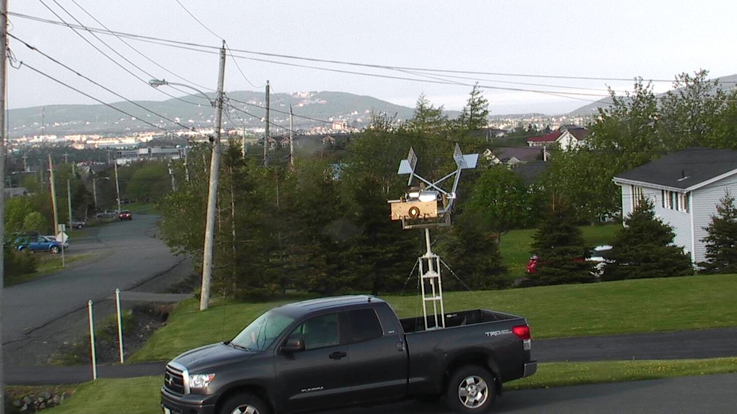

Made two road tests so far and nothing conclusive re operation yet. Most noticeable was the "tail wagging the turbine" effect. So I increased the size of the two yaw pieces and reduced the wagging somewhat. Yesterday I extended the tail arms and installed aluminum yaw and tilt pieces (original parts were p.t. plywood). I'm hoping this new tail will eliminate the wagging. Will do another road test when road and weather conditions permit. Here's a photo of the latest variation. Just installed 4 C-clamps to the front plate to counteract the extra length of the tail (to control the tilting action). Eventually I will get a video done up showing the road tests.

The tail wagging is caused by eddy shedding effect caused either by eddies generated by your pickup cabin or the turbine itself. If it is your truck then you need taller mast and mount it closer to the cabin. If it is the turbine then you can place the the fins on side of the turbine or make them long enough to catch two eddies. One from left and one from right. But I think it is your truck causing it.
https://en.wikipedia.org/wiki/Strouhal_number
https://en.wikipedia.org/wiki/Vortex_shedding

Thanks for the links. Kind of think that the turbine is in a pretty good laminar flow with the current height. Also another possible contributor to the wagging might be the buffeting effect due to the the blunt front plate. Perhaps dumping wind and returning (due to tail influence) to neutral and repeating. Anyway it is interesting and will have a better idea when give this new tail a try.

OK - Just back from a road test and glad to report the wag is gone! Had a GoPro mounted on my chase vehicle but haven't processed the video yet. Now I'm in the clear to work on the augmenter and overspeed control.
