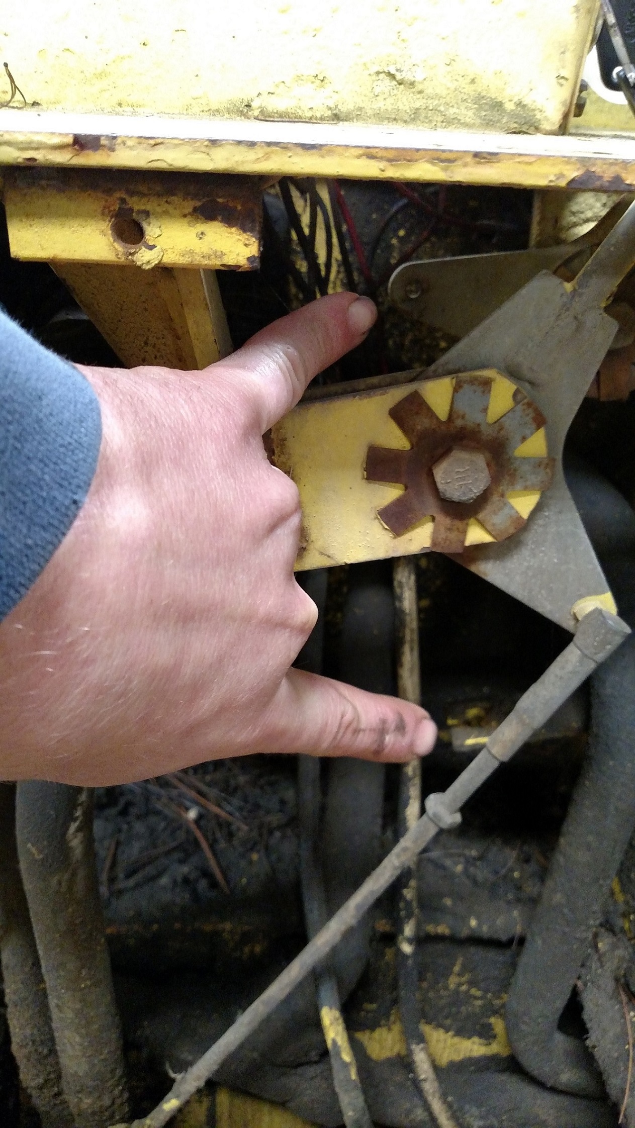

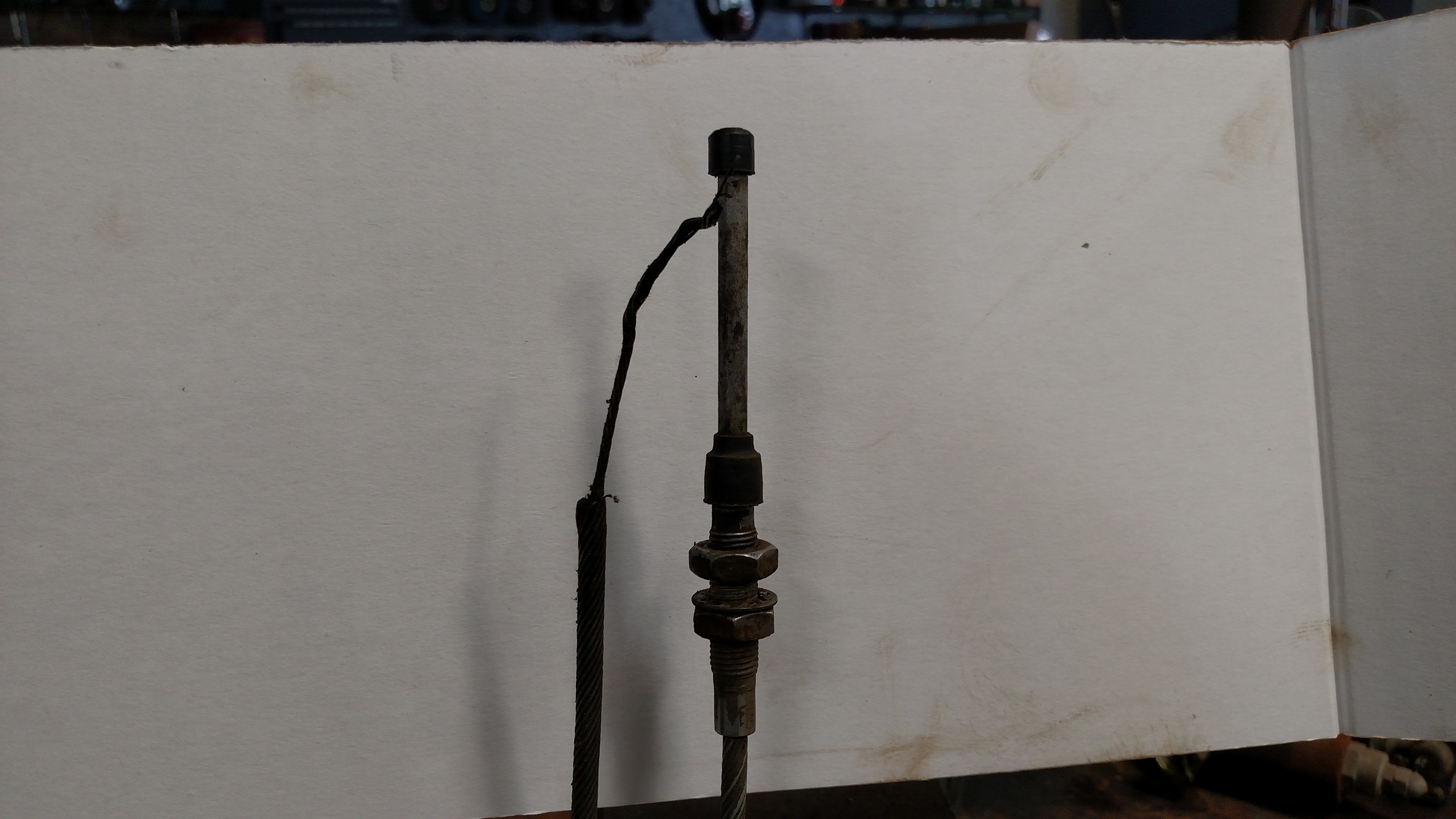

Anyone got any good places with a wide assortment of good throttle/choke cables?
Want to replace the OEM one on my ford 5500 backhoe. Seized up years ago and previous owner just actuated the lever by hand. I installed an old cable I had on the shelf, one of the push pull types and mounted it down by the steering column as it was way too short and had the wrong end to hook to the factory lever.
One end is just a blank end that hooks to the injector.
The end that connects to the lever has a short ~4" steel rod/guide. Since you cannot "push" a cable into a sleeve, this is kinda a guide.
Will see if I can get some pictures. running to the shop now to do so

Here is the cable ends. There should be an eyelet and cable coming out of the tube on the right side.
Here is where it attaches
The outer-jacket length is approx 80" and the inside cable diameter is 0.080". Not sure the OAL cause the one end broke off and not sure what it looks like. I am guessing ~90" should work.
Ford wants $150 for this piece
