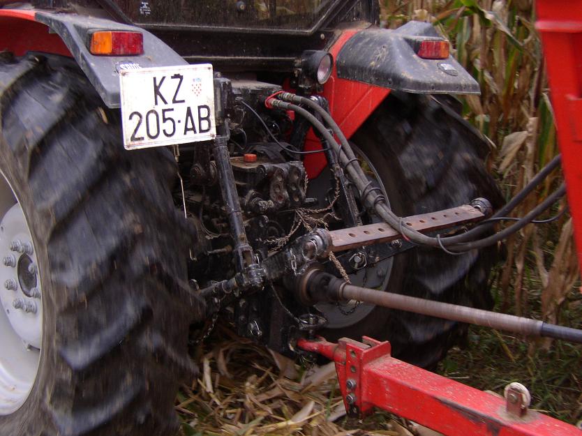

I had very good luck with both of my PTO shafts, with wide angle CV joints on one side, used on corn pickers. They were not stopped even at full angle (80-85 degrees), and they survived several hundered hours without any problems, run at 540rpm.
