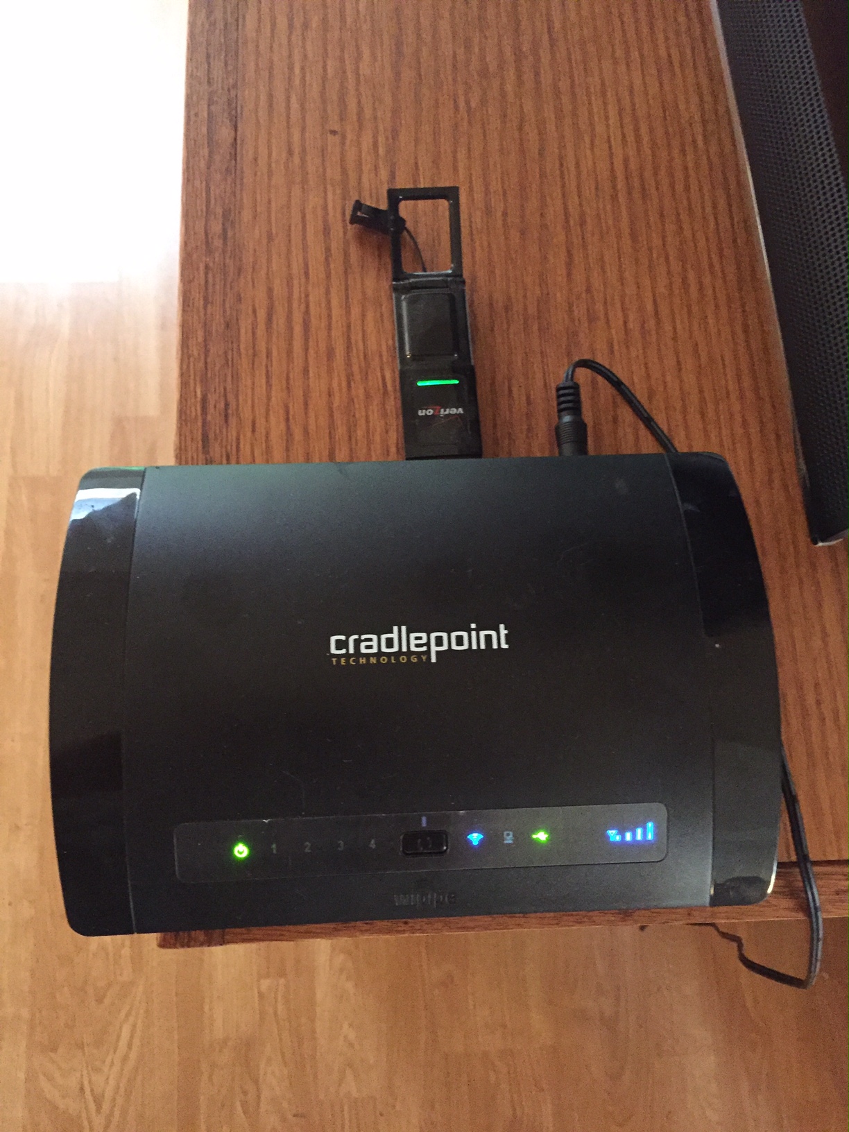

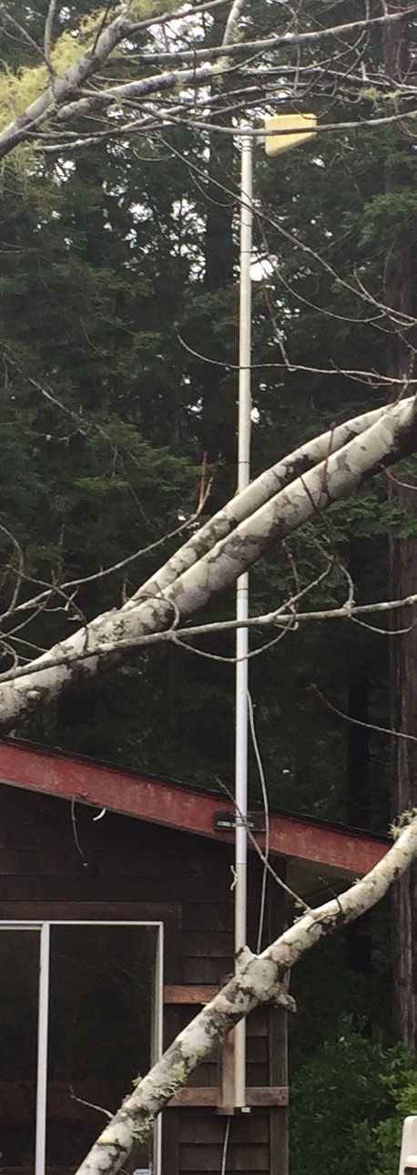

We had a similar situation. No cell coverage here, although there is a tower 3km away down a thickly forested slope. I put a cell phone booster antenna on an aluminum flagpole. That boosted the cell signal at ground level from nothing to a reliable 3G service. Then I used a wireless router with a USB727 modem to provide wireless. It provides decent coverage everywhere in the house. We only use internet for email, news, keeping in touch with family, etc, it is not good enough for Netflix for instance.
Looking ahead, we are about 6 miles from a town with 4G cellular and might get that in future. Also, there are two local outfits trying to see if they can make a WISP network work. But there do not seem to be enough potential customers within any line of sight location -- lots of hills and trees here.
