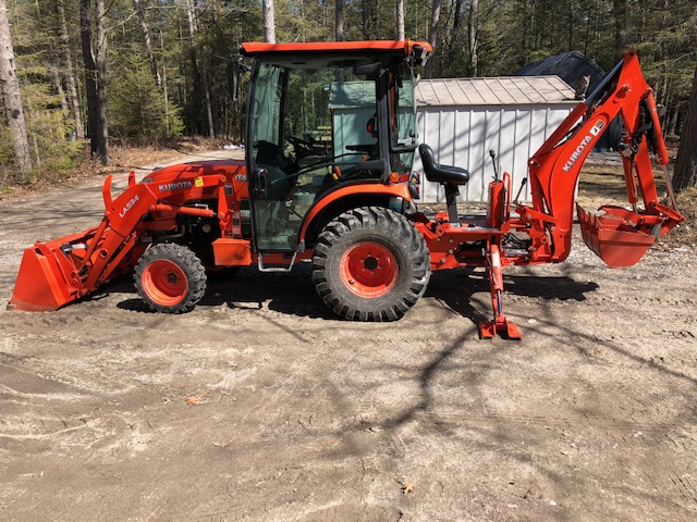

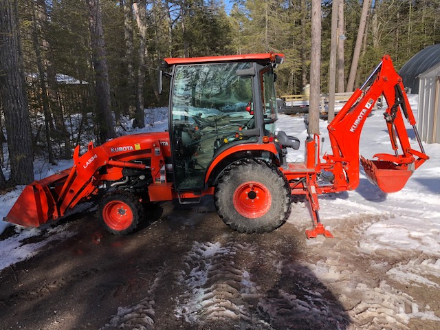

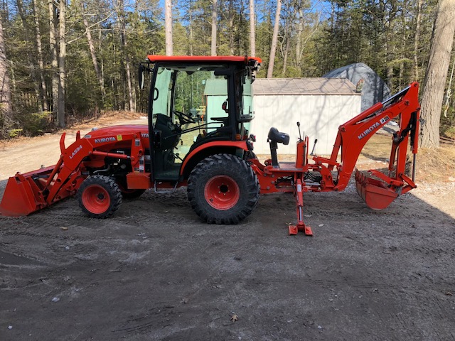

Here are three pictures of my shorten backhoe conversion. The first one is the original, the second is the original with the new small seat and the third is with the 9 in extension removed and the seat post cut down 2 1/4 in. This was done on a B2650 HDSC. I want to thank bandit67 for the inspiration and his work and showing me the way to do this. I might also modify the seat plate to get it a little closer to the cab. Hope I get the pictures in the right order.

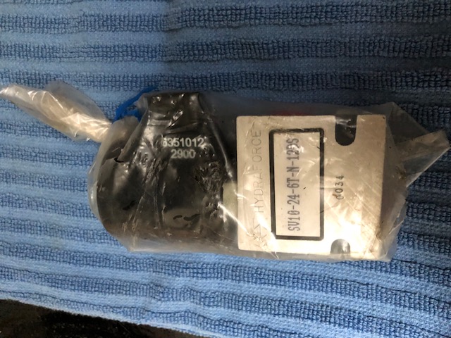

Now maybe you can help me. I see you've done the hydraulic thumb mod. That's something I've been thinking about doing. Would be curious to know what you did, parts used, etc. Or point me to your build thread if you did one...
   / UPDATE: B3000 - moved my BH77 closer to the cab: MOVED IT BACK OUT #16
Let me look it up and get the details. I just used a 12 volt diverter valve with an on /off switch. Its not as good as the factory setup but they don"t offer one for the B2650. There was a person that had previously did this that I copied. Not really expensive and very easy to do .I think I can find it by tomorrow.
Randy
   / UPDATE: B3000 - moved my BH77 closer to the cab: MOVED IT BACK OUT #17
#18
OK, I had seen that thread recently. Unfortunately the pics are no longer available, so I thought I'd see what you came up with if you've done it more recently. Sounds like the hyd. cylinder Bumperm used was too short, so I guess I'll search for one that is a couple inches longer, as I don't have the tools to modify the cylinder on my own.
If you found a better fitting cylinder when doing yours, I'd appreciate the info on that one.
Thanks Randy.
   / UPDATE: B3000 - moved my BH77 closer to the cab: MOVED IT BACK OUT #19
I used a cylinder from Surplus Center 9-4945, 2 1/4 x 10 1/2 x 1 1/4 for $99.50 in June of 2014. I used this on my BH 65 first and then moved it to the B2650. It worked for both backhoe's without problems. I also have a spare diverter valve since I had bought them in a pair. If you want I could sell it to you for my cost? Hydraforce SV!0-24-6T-N-12DS
