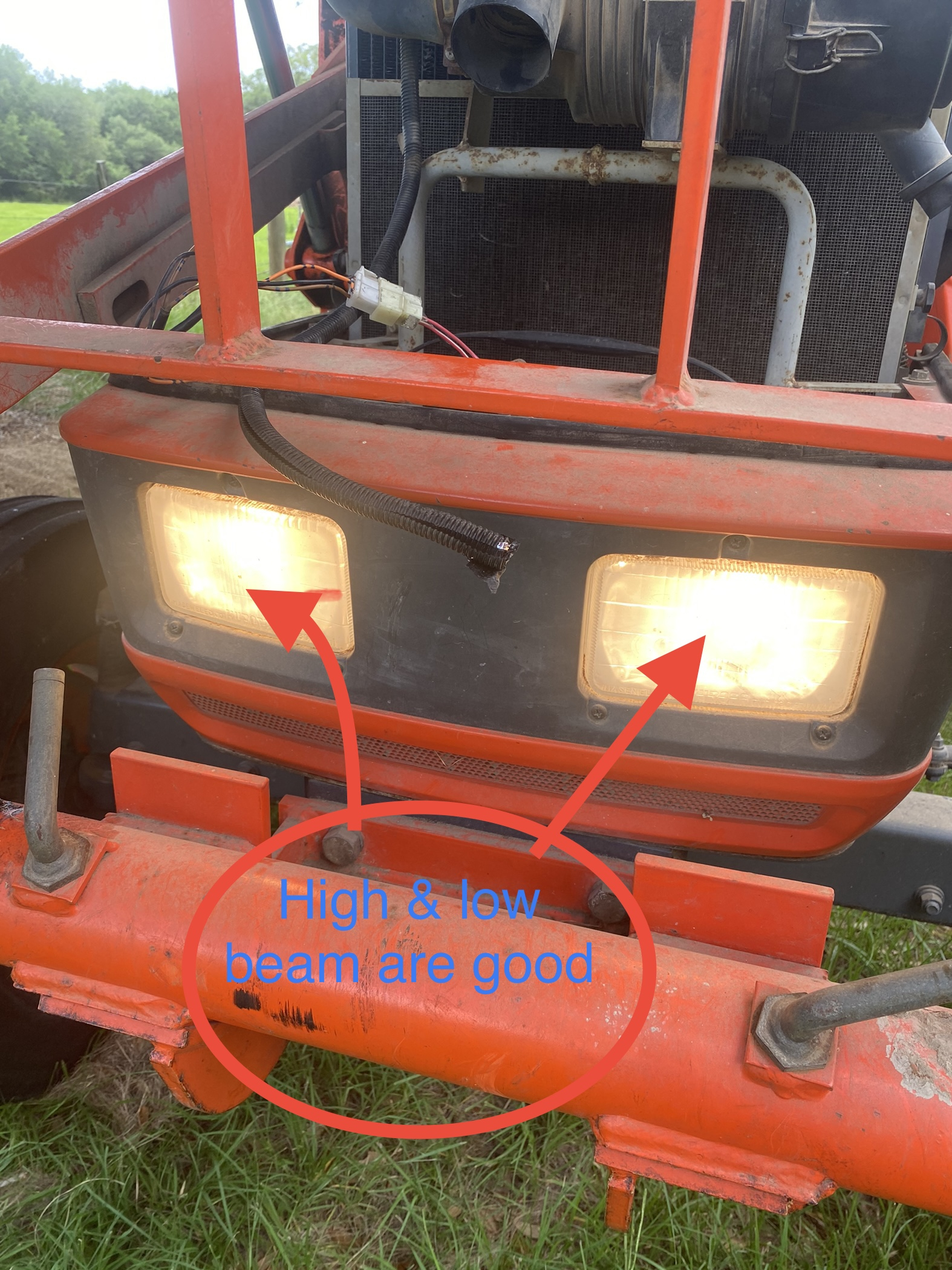

All,
I was finally able to remove the .250 terminals from the plastic housing. Things are all starting to make a lot more sense.
Going to prob buy a 25 pack of .250 female uninsulated terminals. I only need 6 but you never know when mouseville will stop by again...however, I am going to spray mint-oil in all of my gas/diesel powered machines to be proactive. I hope to have the "lights back on" around this thursday evening.
I sure do appreciate everyone's help and suggestions, and stories...the guy w the video of the mouse dropping into the bucket made the rest of all this trouble somewhat palatable....thanks again, tstex

Glad you are moving along with this project. That housing holds male terminals on one side and female terminals on the other. You can easily eliminate it and just use male and female terminals. In that case you buy insulated terminals. Use tape to hold the three together.
I would buy some male and female terminals. Keep them for future use.

Thanks ET. Since I was able to remove the uninsulated female terminals, I will go ahead and use the plastic connectors. The male side of the connectors were not damaged by the mice. I'll crimp the 14ga wiring into the new terminals on the harness side, slide them back into the plastic connector, then connect to the headlights and I should be back in business...I am going to wrap all of the wiring w extra tape and spray w mint...

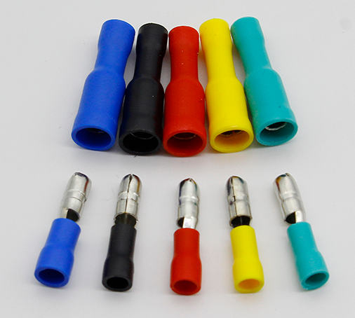

Another option may be bullet connectors who are fully insulated.... Needs no taping and they are a male/female sort of connection.

Another option may be bullet connectors who are fully insulated.... Needs no taping and they are a male/female sort of connection.View attachment 747512
Thanks Wrangler…Those look pretty robust. Having 8-10 sets of those bullet connectors, don’t think you could go wrong..

Back in business. Thank you to everyone for your help & experience. I learned about the micro aspects of lighting on 12V battery & tractor.
i also left a bag of moth balls in the hood. The “tomcat” bait that was wired in this time was half eaten. The other/first one was completely removed.
Thanks again guys !!
