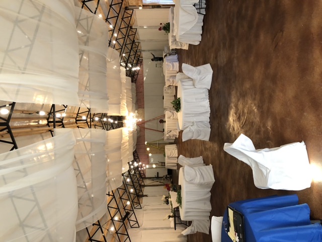

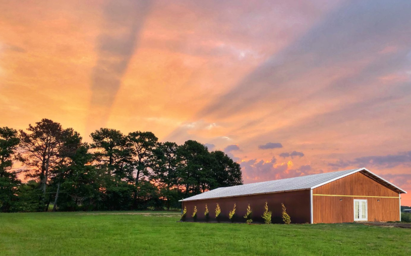

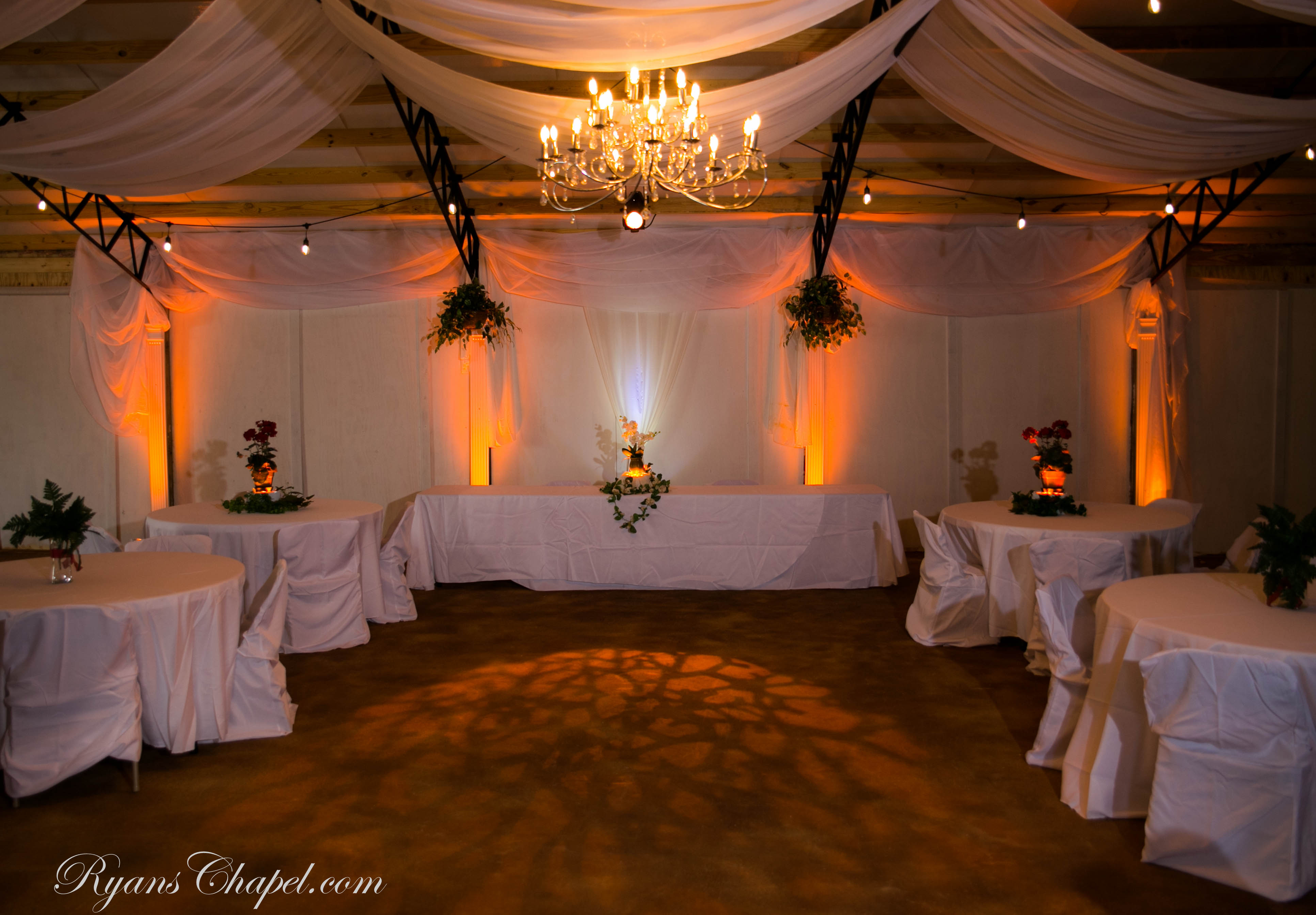

I wanted to give an update on my project, and (of course) ask for advice on how to attach a lean to. To recap, I'm building a wedding venue and had a company do a basic pole barn structure; 6X6 posts and galvalume roof, then put down concrete. This is a 90'X40'X10' structure. I then used T1-11 for the exterior, attached to 2X6s between each post. Had a painter to acid stain the floors and stain the exterior. We just finished insulating and I put sanded plywood on the interior walls and painted white, 1 coat (so the grain shows thru). The final part of this project is a 48'X14' lean to. This will house M/F bathrooms, along with bride/groom suites on either side of the bathrooms. First, let me post a couple of pics.
