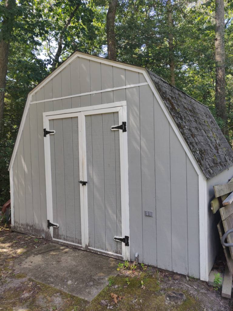

T111 will last a long time with a little attention to detail. The house we bought came with a 12x12' shed sided with painted T111. Judging by the trees that had grown up around it and Romex stamped 1998, about 20 years old. I had to replace the panels on one gable side and rebuild the doors 5 years ago when we moved in, they had rotted on the bottom where the water splashed up during the rain. No gutters or overhang, so worst of both worlds. The Z flashing is a good idea, the front of the shed is original and solid.

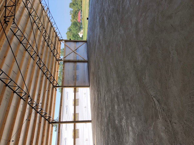

...I'm wondering, do you think these panels will help in building stability? It's about 22 panels used on this one wall. I used 4" construction screws to anchor the studs to the poles then 2.5" screws to anchor the panels to the studs. I'd say there's about 18-20 screws in every panel...
Only using 3 purlins instead of 5 causes some concern in overall strength. Everything that I know is based on 2 foot spacing or less. To gain maximum strength of of the siding, nail spacing is also important. Or screws in your case. You did't gain anything by going with 4 inch screws. 2" would have given you the same results. Hardie makes a 1 5/8" screw that has a thicker shaft and bigger head that would have given you the most strength, but for something like this, I usually just use 2 3/8's nails in my framing gun. The biggest thing is that you nail into the stud, or purlin, ever foot in the middle portion of the plywood, and every six inches around the outside edges. So that would be 9 along the top and bottom purlin, and 5 in the middle one. Then along the edge you need 17 for each side, but since you don't have anything at your seams, that's not possible, and why I question the strength of your plywood. With 5 purlins, you should have 59 nails per sheet of plywood.

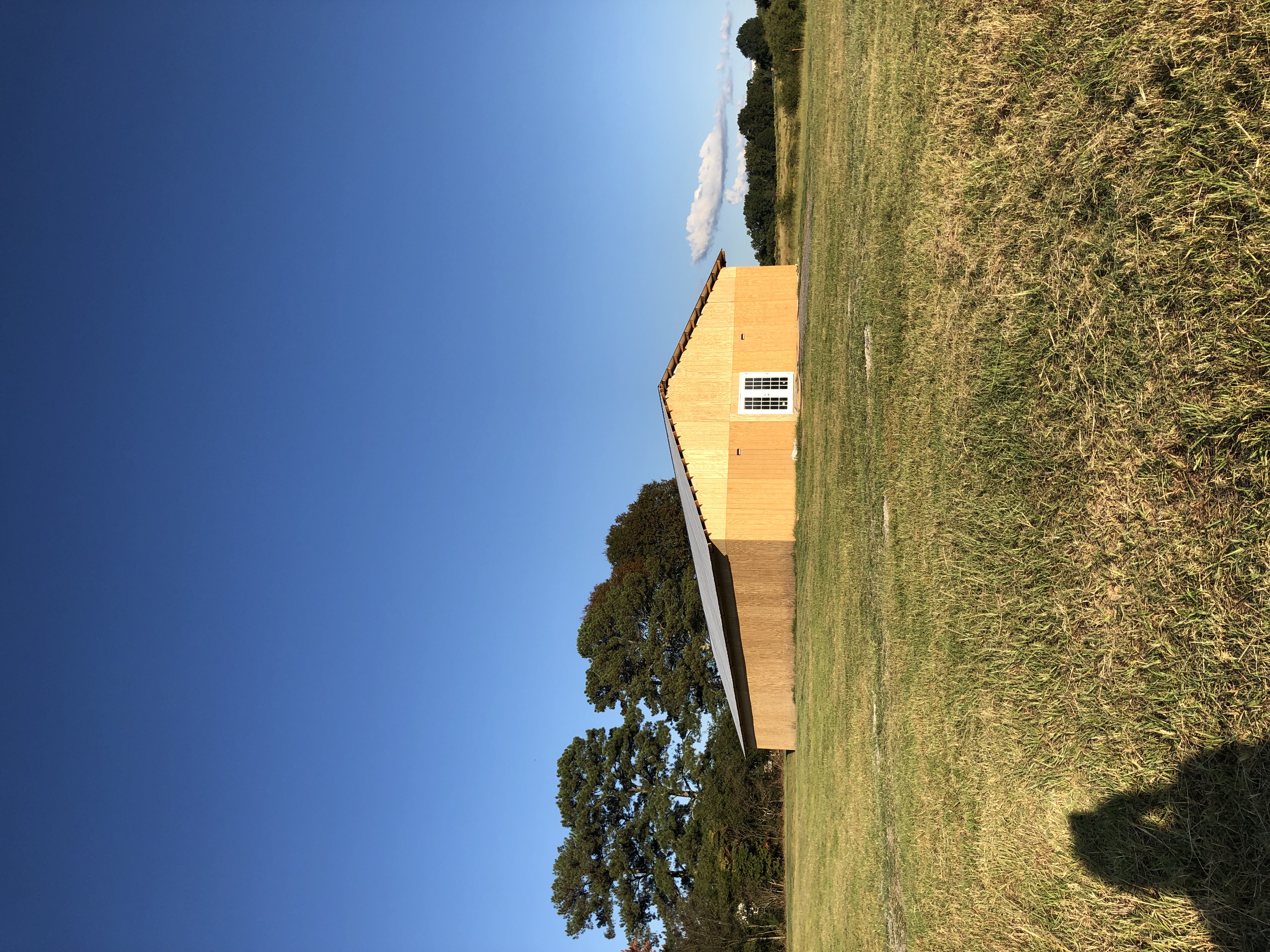

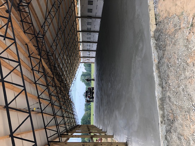

Here are a few more pics of my project. I installed cross-bracing (2X4) in the corners, and have done about half the T1-11 panels on the backside. On Monday, I had a crew pour concrete. 57 yards over the top of mesh and about 3 loads of gravel ($11k). Next up, I'm going to put up 2x4 studs on the ends to wall it in. I'm intending to tie to the 2x6 purlins on top and sink anchors into the concrete at the bottom. I'll then install T1-11 over the top of that. Any suggestions on the final walls are appreciated. BTW, the building contractor did a bang up job on getting everything straight and level.

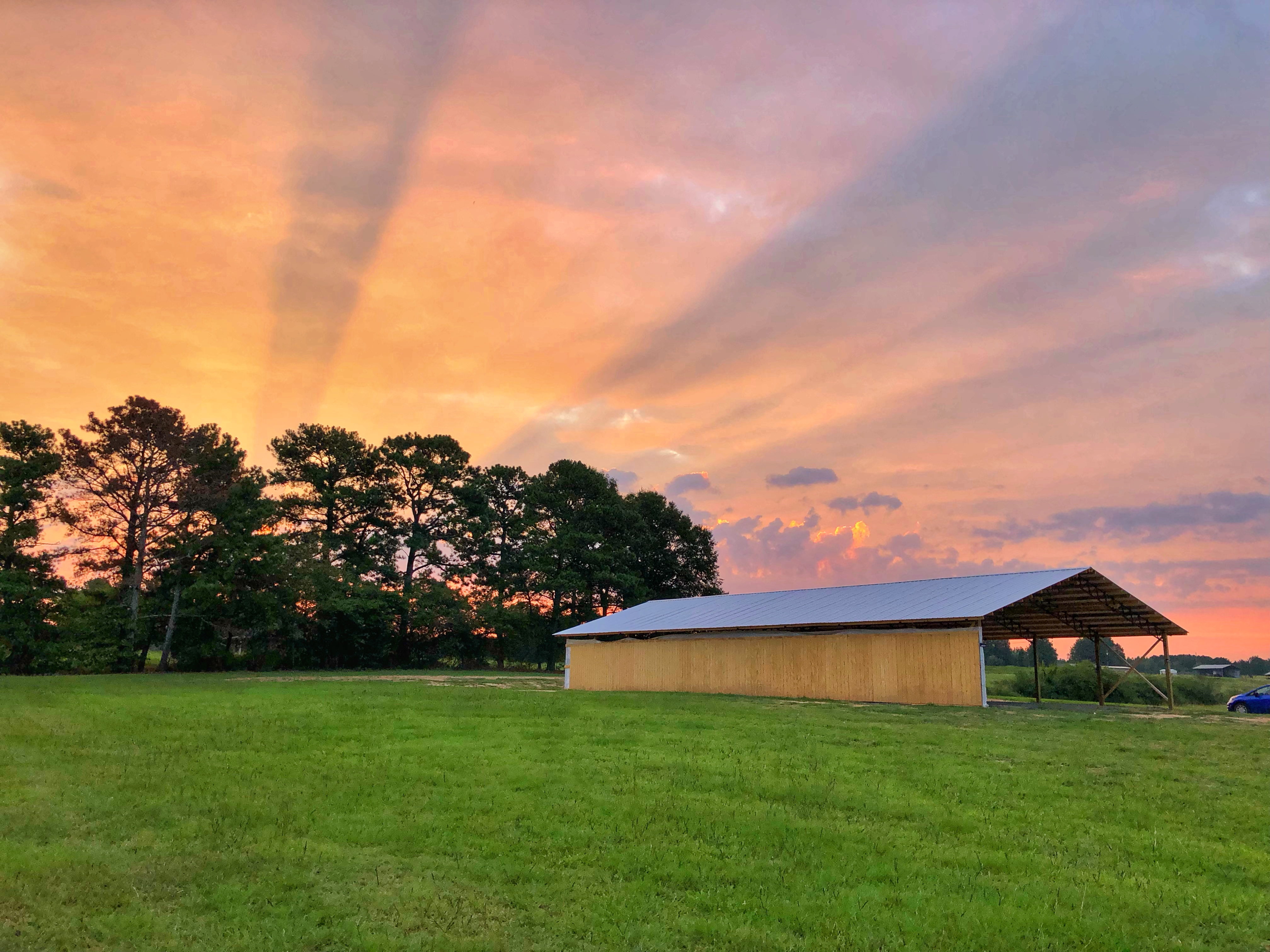

Wanted to give another update on the project. 40X90X10 pole barn that will be used for a wedding venue. I've finished closing in the front side/end with T1-11. Yea, I know I did the ends wrong with vertical studs but I'm closing the gaps with 1X4 on the outside. I've installed 2 double doors and have a 3rd single door yet to install. Laid down some acid stain on one corner of the floor and installed string lighting. Oh yea, I have my first booking, Feb 1st, 2020. I've got $30k in the pole barn and concrete floor. Have put another $8k into it and will have another $15k into the bathrooms (perk test has been completed, about to order septic install and water tap). I'm going to end up somewhere around $50k for the entire project. Thanks for everyone's input.

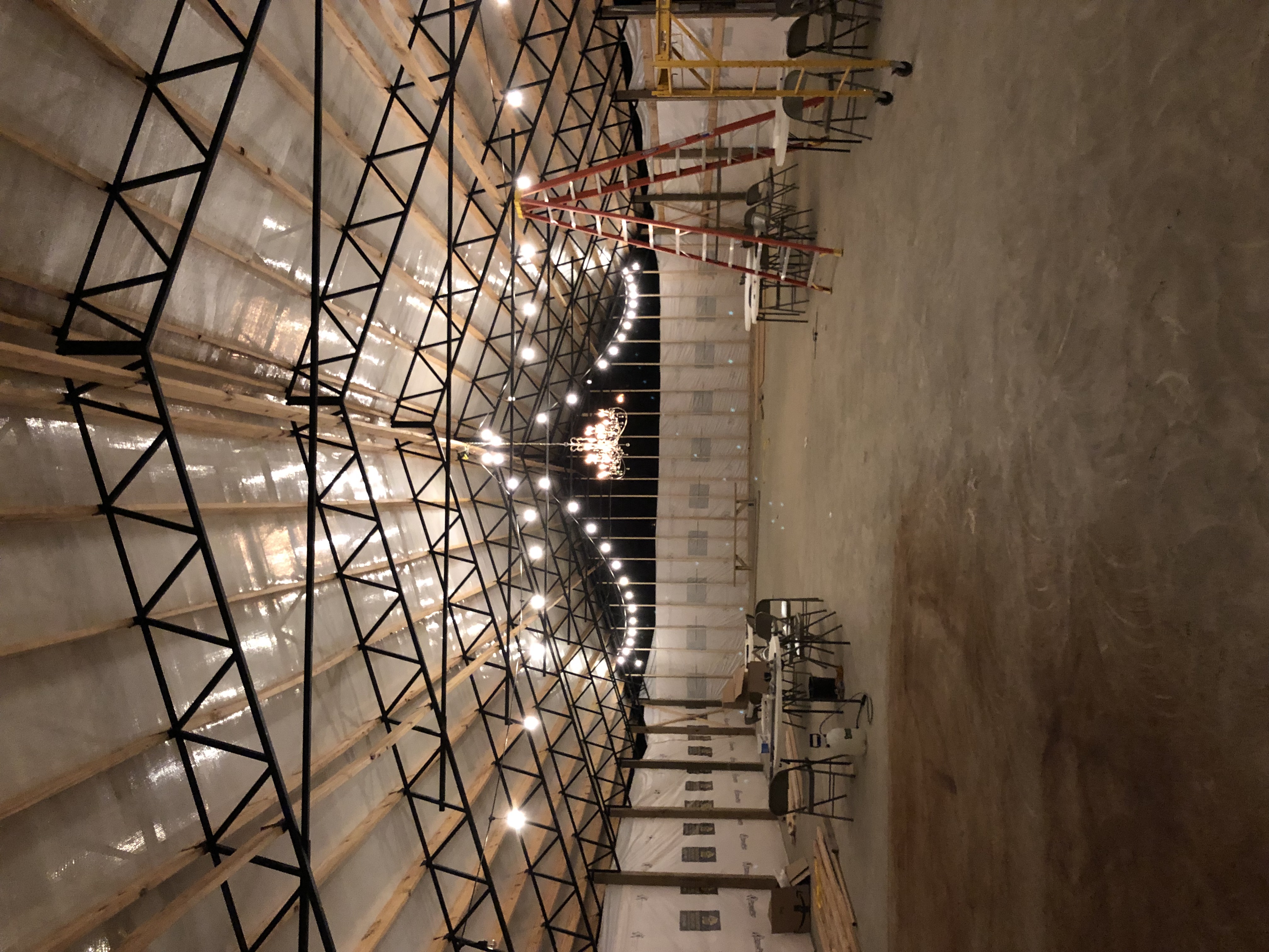

One more question. I originally thought about T1-11 on the interior walls but am considering instead to use thin (5mm) poplar plywood that will be whitewashed (white with wood grain showing thru). Do you think that thin plywood would work? I'm installing 10' drapery swags between every other set of poles (4 per side) to finish it out. Here are a couple of pics.
   / Update on my pole barn project #46
I wouldnt do T111 inside. What about knotty pine.
