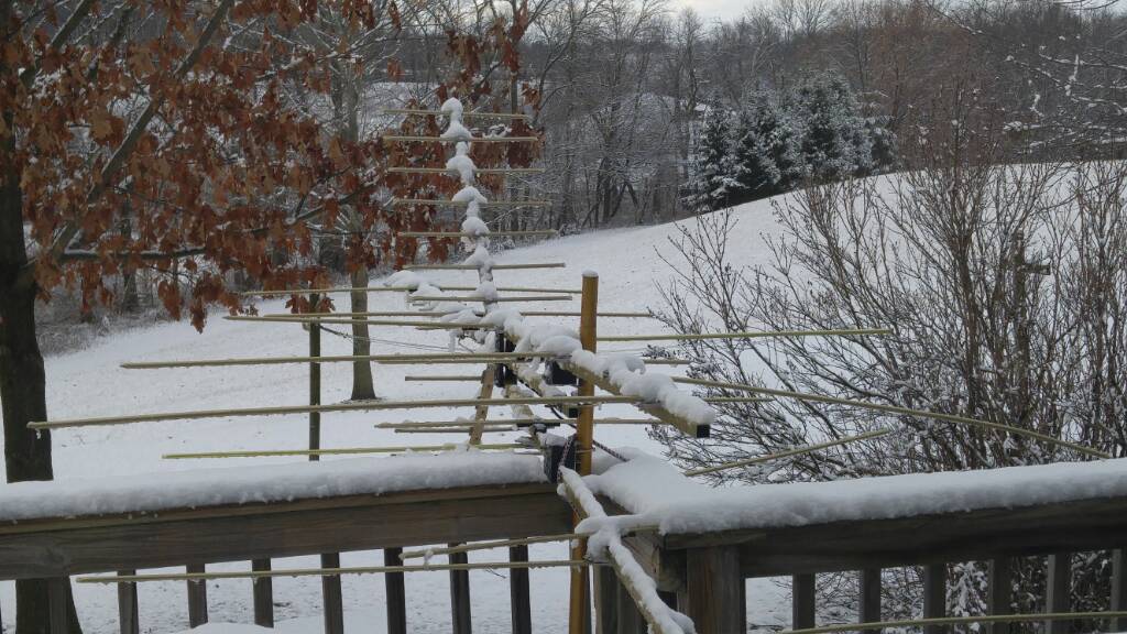

Finally got around to trying the antenna, could not get any signal. cable checks out ok, and antenna was tested higher up than my temporary antenna sitting on by deck. Not sure what to try next. maybe I should put my temp antenna up on the pole, but it's huge.
   / Updated TV Antenna Thoughts #80
I think you mentioned earlier that you had a Winegard FL-6550A. Those flat panel antennas are rather poor and only good for strong signal areas like in the city and near suburban areas. Since I don't know your situation, height, what you're trying to receive, I can't say much more than bigger is better, and height is your friend in TV and FM reception.
Yea, i thought id try it. It claimed 60 miles or so.
I knocked down my pole mounted antenna trimming tree branches. Had this antenna in my barn, so temp install on my deck. It's a huge antenna, dont have half of it assembled, dont need the longer elements. Its doing good on the deck, but want to get one up on the pole. Just too big to put up on my pole, so ordered a smaller one. HD7694. Will see how it does, or go larger, or amp it.
Pulling stations from DC 40 miles, 172°, or turn it some for baltimore 30 miles, 116°. Got a close ridge to the east, better shot south to DC.
