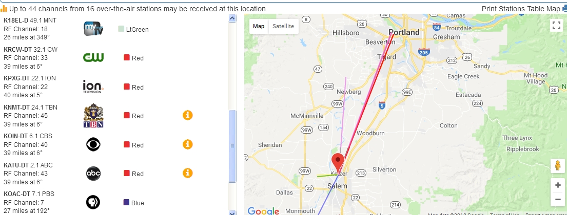

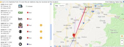

I have a question James, I get pretty good reception off a $25 craigslist TV antenna (looks like a 4 element Channel Master type), but I occasionally have difficulty with channel 2 and it's sidebands. They all come from "tower mountain" in Portland. Sometimes it perfect, sometimes it's so pixellated and distorted the image jams (at least with the old analog you could hear the Jeopardy questions through the snow) and becomes unwatchable.
Could that particular band be more susceptible to atmospherics, as other signals from the same area are unaffected?
   / Updated TV Antenna Thoughts #90
Are you talking about KATU-DT the ABC affiliate? as shown on the sidebar of your map? There are not very many stations actually on RF channel 2 any more, KATU-DT is on actual RF channel 43, so it is in the UHF spectrum. My first thought is that the fade margin for this station at your location is near non-existent. In other words the signal can fade (for a number of reasons) but the margin of excess signal that you have at your location is very low or none. So when a fade happens, say from tropospeheric bending or rain or snow you have no margin to make up the slight dip in signal, so you have digital drop out.
A signal strength analyzer measurement on a good day, then measure when you have drop out that would tell the tale.
