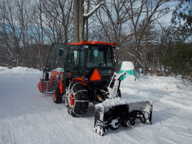

My property is not smooth so I added a suspension seat. 54 inch bucket does not perform that well when ripping in virgn ground so I made a 48in toothed bucket which is perfect for the loader capacity. A skid plate is a good option, too many vulnerable hoses underneath. (mine are all displaced and I changed a couple O-rings) I have not been able to figure out why my rear locker is a bear to engage. I may reroute the pedals, locker engages fine from the lever when the rods are removed. I admit i only have a 6 foot box blade (also have an MF135) I have used it successfully many times on the B3200 until one time backing with the box blade I made a Pretzel out of the draft bar (lower link?). I have welded a 3/8 thick bar to beef them up.
I cannot drive this tractor far without looking for the ear protectors. Otherwise I am having lots of fun with it.

Electric deflector and rotator?...You may want to investigate hydraulic ones...Run off your already installed loader valve. I've got the Hydraulics on my B2782 blower attached to the front of my B2650HSDC and they work great.
Would have gone with hydraulic but I already have an electric actuator and gear motor. Actually have a wiring harness & switches too. Figured I might as well use those instead of having to buy all new hydraulic parts. All I need is a 4 wire connector and make a metal plate for the motor to connect to the rotator and I'm good to go.
What about those "trailer light" wire setup's, there's four wires with connectors at each end.

You're gonna love that blower! Congratulations!
Guess I might be the one that came up with the UHMW polyurethane lining:
The lining all but eliminates chute clogging, even with really wet mushy snow. Side benefit, throw distance already excellent with this blower, increases maybe 10 - 20 percent with wet snow (doubtless more due to no clogs than from reduced friction).
I bought mine with the hydraulic chute rotation, then added chute deflection as I have 3rd function on my tractor. Without 3rd function, you won't have enough hydraulic functions without diverting something (and that's doable of course. Either way, hydraulics or 12 volt linear actuator works well for deflection.

Yes bumper, I was clicking through your Picts and thought I'd steal a few ideas. I was going to pick your brain about the lining once I actually find the time to do it. I assume you picked up an 1/8" thick piece of poly and then heated & bent it to fit the inside of the chute. Looks like you used two pieces on the inside instead of trying to go all the way around with one. Did you attach them with some kind of metal screws?
It definitely looks durable. How has it held up? One other reason for putting the poly in the chute was to protect it from stones that occasionally fly up through it. One of the misfortunes of having a gravel driveway.
I did get a piece of 1" poly to use on the skid shoes. I need to get that scraper blade up as high as possible. I don't mind leaving 2" of snow on the driveway as long as I don't have to blow stones all over the place!
By the way, thanks for taking the time to post the Picts. They help a lot!
   / Upgraded to a B3200 #20
You're welcome!
I used 1/8" UHMW Polyurethane sheet (amazon). Lower (main) chute section is one piece. Cardboard pattern first, cut PU oversize. Then took a thin scrap of waste PU and used a heat gun to form the bends. Held strip in position to cool, marked corners on strip, then used strip to layout corners on actual piece. Bottom of lower chute liner is cut so it "locks" in place (there's some recesses there that will hold chute in position. The the only other attachment for lower chute are the holes on front side used for the grill guard (which I removed previously as it makes the chore of cleaning out a clogged chute that much harder.
Deflector, being a compound shape, is made from 3 pieces the sides go up against the curved center to help hold its curved shape. All 3 pieces are held fixed in place with small countersink head SS screws (8-32) - - I drilled and tapped the chute for these so there are no nuts on the outside (no particular reason for doing it that way).
Still trying to figure out a good (easy) way to make seals for the impeller - - stock isn't bad, but it changes from maybe 3/8 to less than 1/8"
