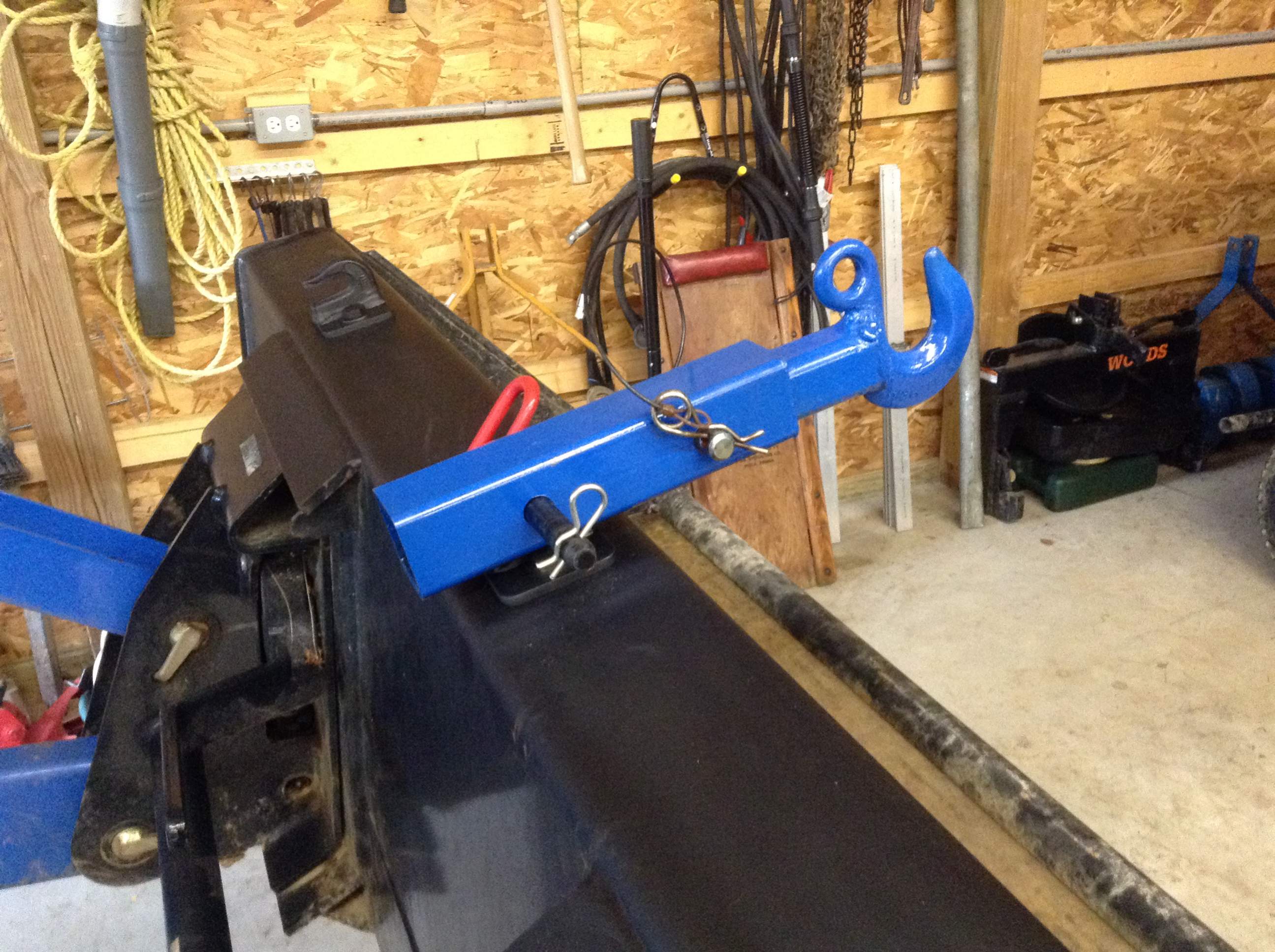

BD: You have to tell me more about that! Is that a clevis mount under there? (maybe start a new thread so we dont derail the OP's thread)
KennyD, Yes, this is a clevis mount. I milled a piece of square stock and drilled a precision hole for mounting. Easily removable so I can use it with a chain. This hook is for moving my 6 foot brush hog around in the Garage. A gentlemen from Erie PA inspired me to make this on TBN. He had made something similar for his Kubota tractor and I saw a photo of it.
