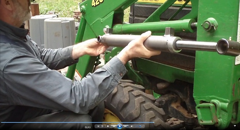

Hi Folks: I just finished upgrading the hydraulic cylinders on my JD 420 Loader. The tractor only has 1400 hours on it but I was having trouble with the loader leaking down. It would leak down about 10 inches in one hour.
The real impetus for the upgrade was that I broke one of the bucket cylinders. I had curled the bucket all the way down and hooked the bucket teeth on a large vine. I was creeping backwards very slowly, being careful not to tip the tractor over, when I heard a loud bang. The bucket cylinder on the left side had snapped. So to rebuild the broken cylinder was going to be over $250. I refitted with new oversized Bucket cylinders for about $275 for everything. The loader lift cylinders were even cheaper, about $200 for everything. I bought cylinders hoses and fitting from the Surplus Center and cut the ends off and refitted them with the correct ends.

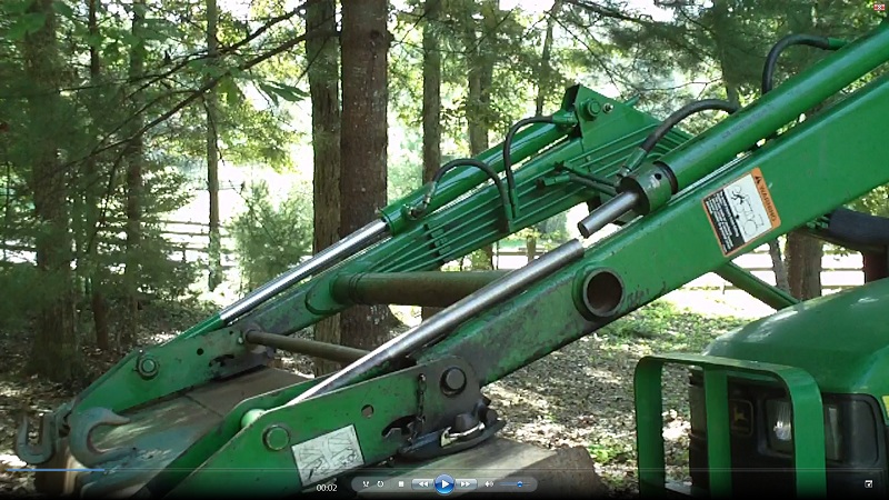

The 2 inch cylinders have about 30% more lift power and about 18% more curl power than the 1-3/4 inch OEM cylinders. The 17 inch lift cylinders that I used yielded 10 inches more lift than the OEM 16 inch cylinders.

Thats pretty cool. I may have to do something like that next year. What are the cylinder specs and/or part numbers? You had to cut the ends of them to add some bar stock and tubing?
/ Upgrading John Deere Loader Cylinders

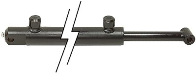

I bought the cylinders at Surplus Center here are the links:
2x17x1.25 DA HYD CYL
2X16X1.25 DA HYD CYL PINHOLE

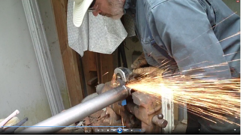

A couple years ago I purchased several lengths of 1-1/2 inch DOM Tubing with 1/4 inch walls nominal ID of 1 inch. Since the ID of DOM tubing is not guaranteed you usually have to ream the ID to your spec. The ID of this tubing just happened to be perfect for the Metric pins on the 420 loader. I used some scrap 1-1/4 inch round stock to lengthen the curl cylinder rods but I could have used the cut offs from the 17 inch Cylinder rods.
If I had it to do over again I would use 4 of the 17" cylinders since they are so much cheaper and would have tried to find a way to make them work for the curl cylinders.

I have put about 20 hours on the loader since the rebuild and everything is working very well. The FEL has a lot more power now. I will try to post some pictures of it hauling brush.

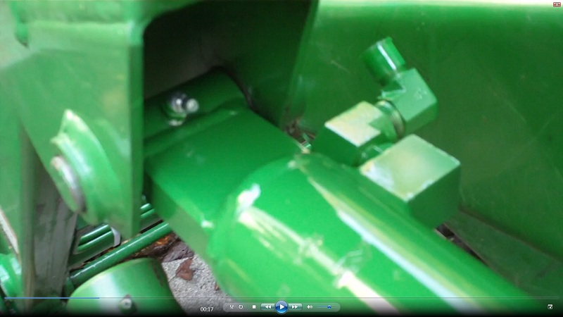

I had to add 6" to the bucket curl cylinder rods to make them long enough. The 17" cylinders that I used for the lift were long enough to use for the curl but you would have to install a stroke limiter to make the stroke 16". The retrofit was a lot of work but I would do it again. Make sure that you test fit the cylinders after you tack them together, adjust the fit, tack more firmly, retest the fit and then weld them up.
