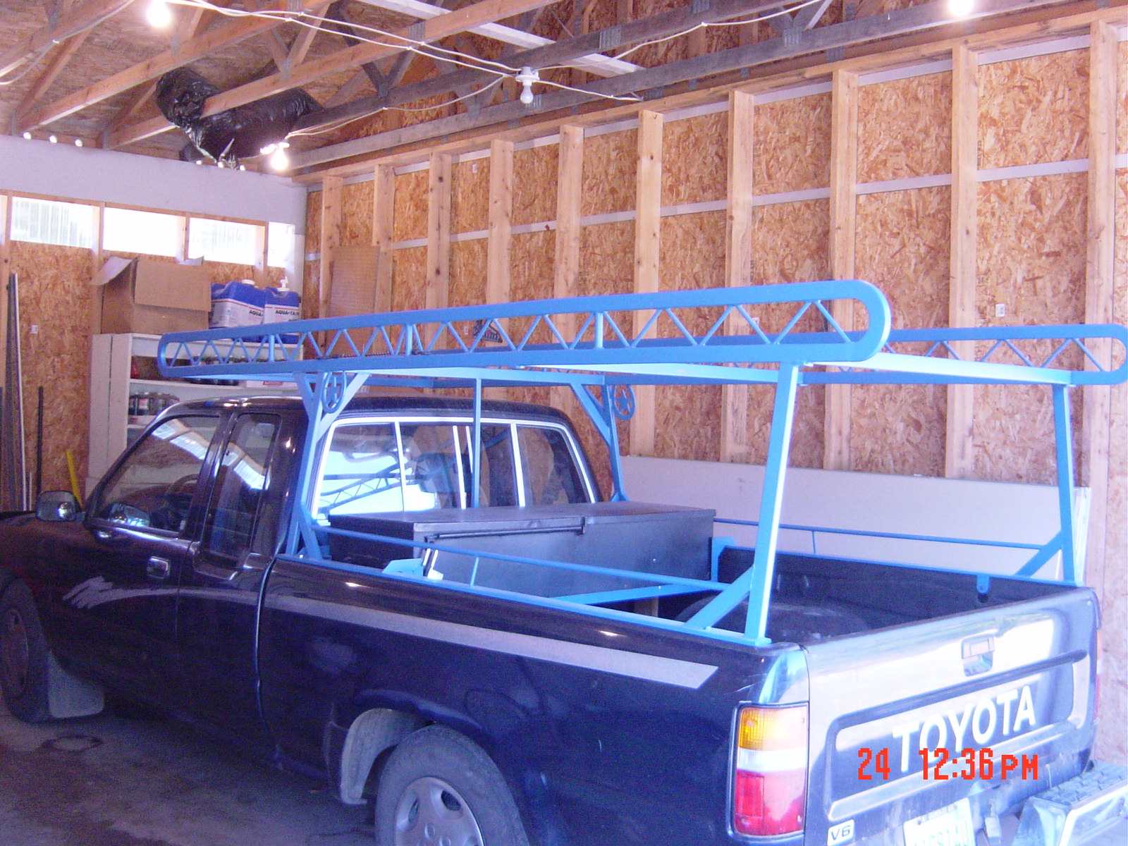

I really like the 15-feet long guns. Only trouble I ever had was when I built this lumber rack. I used my Linde VI-206 with .023 wire, I had to keep the gun as straight as possible at all times. :rolleyes:
