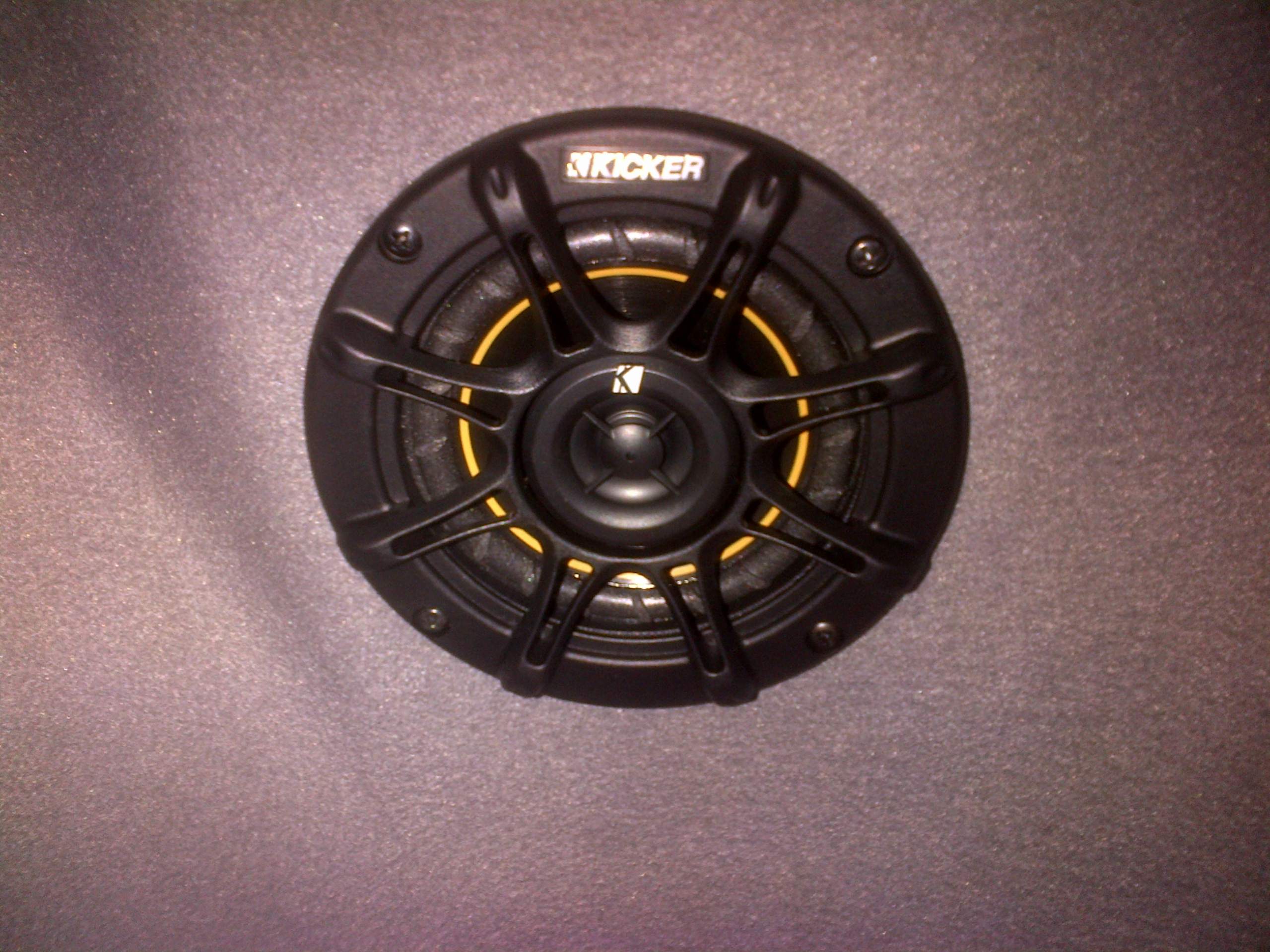

I completed the install of the aftermarket radio and speakers today. I also went ahead and pre-wired for a powered sub while I had everything apart.
Here's the 10AWG ground wire for the sub:
And the 10AWG for power:
And the radio about to be installed:
All done.
It sounds so much better than the factory system!

I took a look at Crutchfield's website to see what they have in the way of powered subs that would fit. I came across one by Sound Ordnance that was very slim at 3" deep and had great reviews. On top of that, it just went in sale with a $50 discount. So I dropped by their retail store and picket one up. It fits like a glove against the rear metal wall below the seat.
The only catch is that you can't have the seat all the way back, but in my case is not an issue. Especially with the tilt steering wheel. I have the crossover set for 80Hz and have not had a chance to play with balancing the levels out yet, but initial impression is a huge improvement over just the aftermarket speakers by themselves which were still struggling with bass heavy songs. I don't think there is any getting around that with 4x6 speakers although it was a huge improvement over the factory ones.
