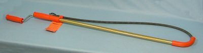

Thanks so much for all the fast help.. At this moment it has almost become a comedy of errors.. My hacksaw was so old that the plastic handle started falling apart when I started cutting.. So off the walmart for another, but walmart was sold out of the $5 hacksaws - they only had a $25 hacksaw that going to be too thick for what i needed.. So drive 30 minutes to a bigger town and lowes. The good thing is lowes had a handle that held a hacksaw blade for working in close quarters which will work better..
I also got the toilet clearing tool, but hadnt had any luck snagging the 'end' yet.. I like the drimmel tool idea, that may work better than the hacksaw..
I will tackle getting the toilet up tonite when my wife will be home to help hold toilet.. Ill let you know how it comes out (pun intended LOL)

The comedy of errors continues.. But the good news is that the first wand end is out of the commode.. It was right at the end where the commode connects to the plumbing..
The bad news is that the reason the screws were turning when I was loosing them to take the tank off is that the plumber did not set the ring properly so the slots are at (3 and 9 o'clock).. The end of the slots are at about 8 and 2 oclock, which causes the bolts to turn freely... And the mounting ring is screwed to the floor AND glued to the rest of the plumbing so my idea of rotating the mounting ring didnt quite pan out like i planned... So now its time to figure out how to set the screws at 3 & 9 and to keep them from turning..
Ill keep you updated..
Brian
