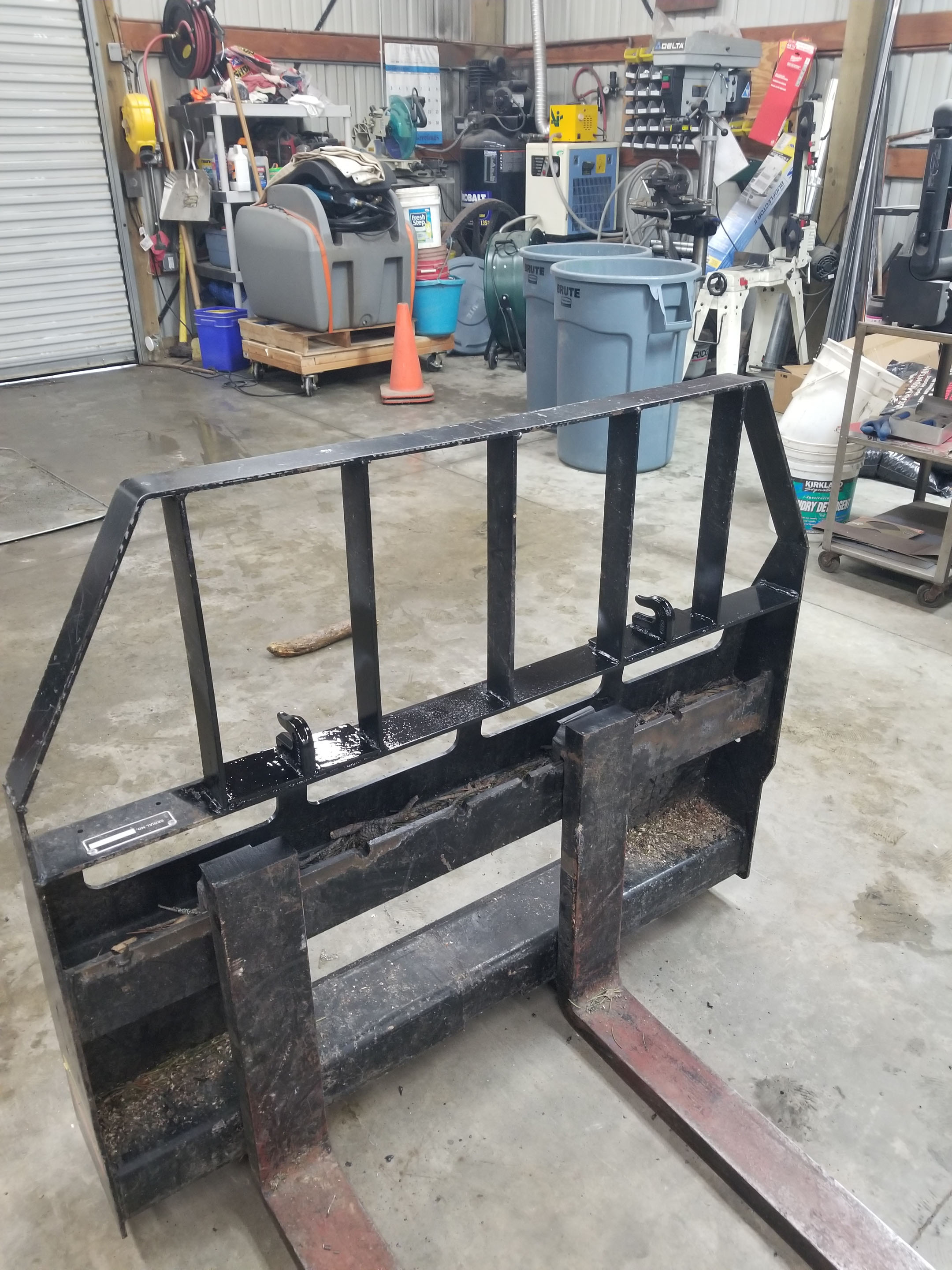

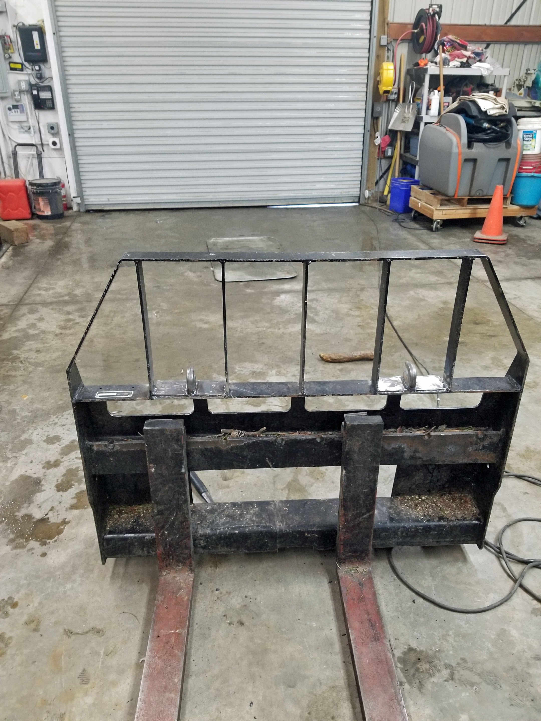

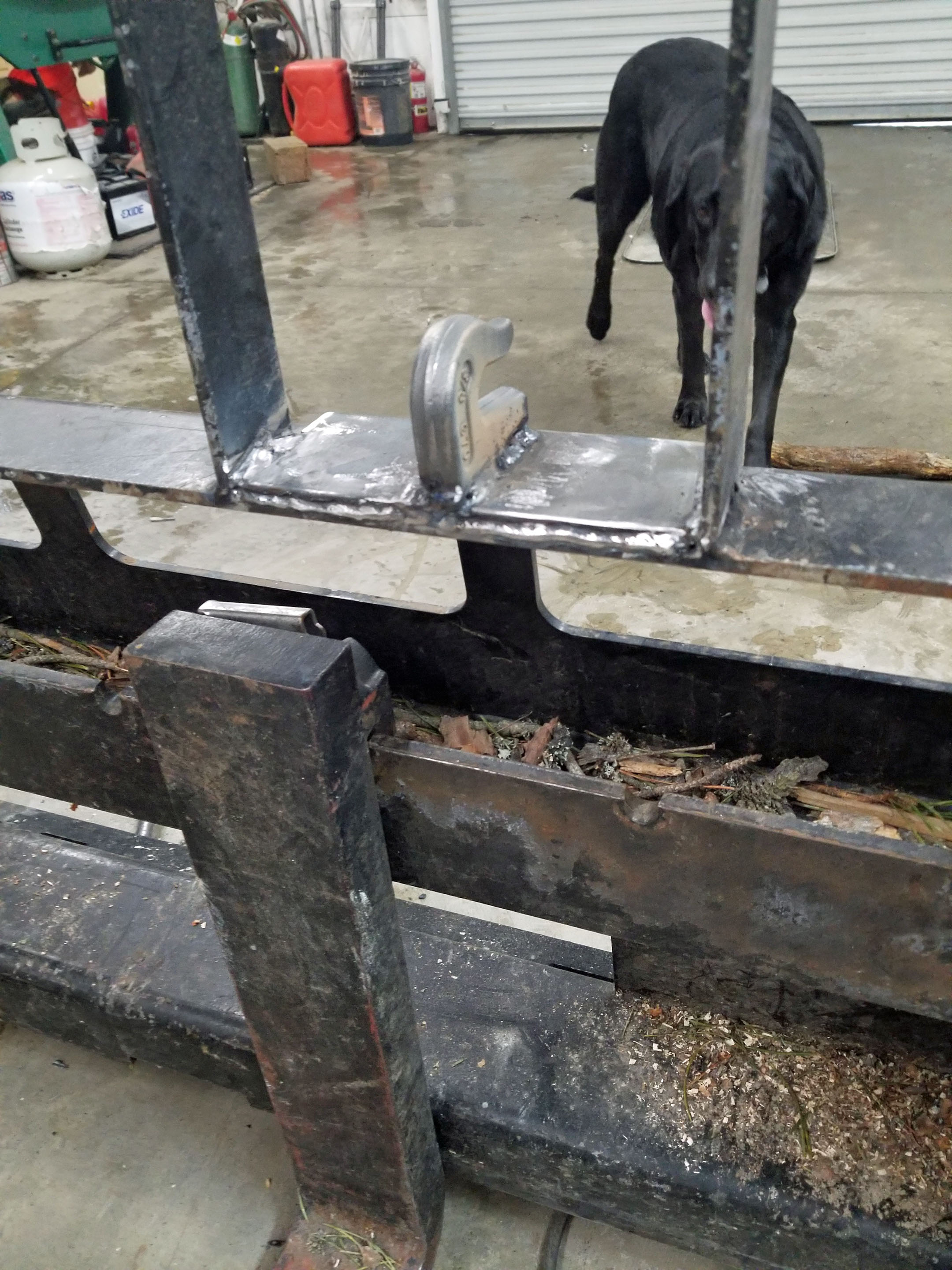

Well i finally got around to adding 2 of the 3/8" hooks to my forklift attachment. i have gotten tired of having to loop the chain thru the guard. dont know why i waited years to do this. Im not going to go thru too much effort to paint it cause it will be all scratched up this spring. but i did use a primer and rustolium.
i added a 1/4" base plate to the 3/16 in framework just to be safe, but probably didnt need to. 20210222_142558.jpg 20210222_142609.jpg 20210222_143506.jpg
