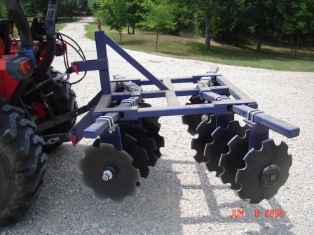

You could always build one if don't find what you want.

You're not trying to say you built that thing, are you?

OOOH no not me...here is the thread on it and I also narrowed it down six inches after it was completed....what a pain that was but I wanted it to be a true 5ft disk, I really didn't want to buy anymore parts to fit the frame:)
It's amazing what having a welder and associated tools can do.
http://www.tractorbynet.com/forums/build-yourself/81139-finally-finished-disk-harrow.html

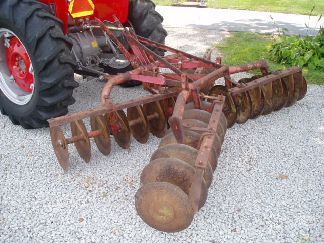

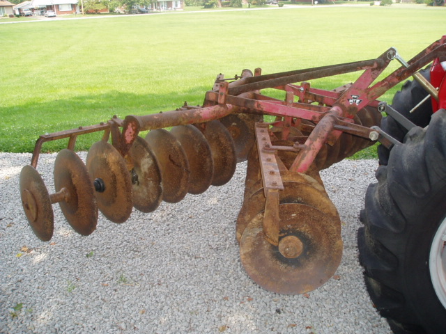

Here's a disc that didn't break the budget. The basic design stayed with the Massey Ferguson line for nearly 30 years. Not only does it do a fantastic job, they seem to be extremely durable too. It's a model #25 MF. The 2 levers change front or rear gang angle on the move. Each gang has a single bolt that can be removed to allow that gang to float independent of the others when on rough ground. They were built in large numbers. Still quite a few left to be found on dealers lots. I paid $400 for this one. That's about average for a #25 disc. This one is the largest of the 3 sizes available. (6', 7-1/2', and 9') They can be cut down if you find a deal on a 9'er. Remove 1 or 2 disc blades and spools per gang, cut down and re-thread the ends of the axles, and you have a smaller model. Most I've seen are 6' or 7-1/2'.
Not only do these sell cheaper than any new disc I know of, they do a much better job. Massey sales literature from the day, nor the manual list's weight, but I'd estimate this 9'er weighs close to 1200lbs.
