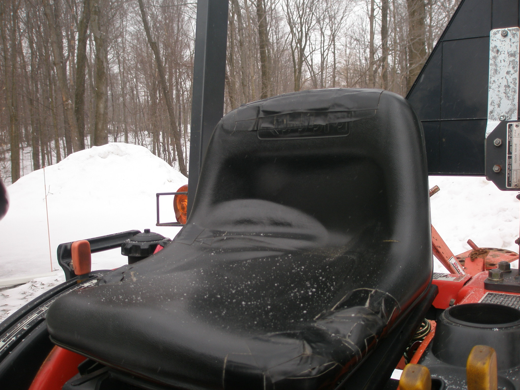

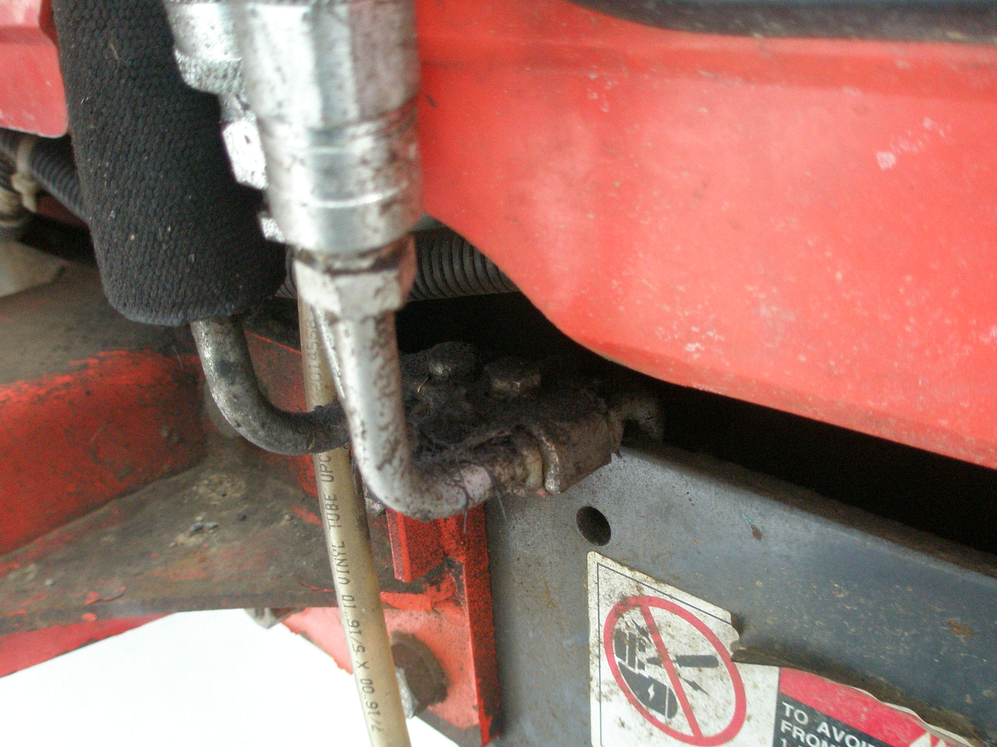

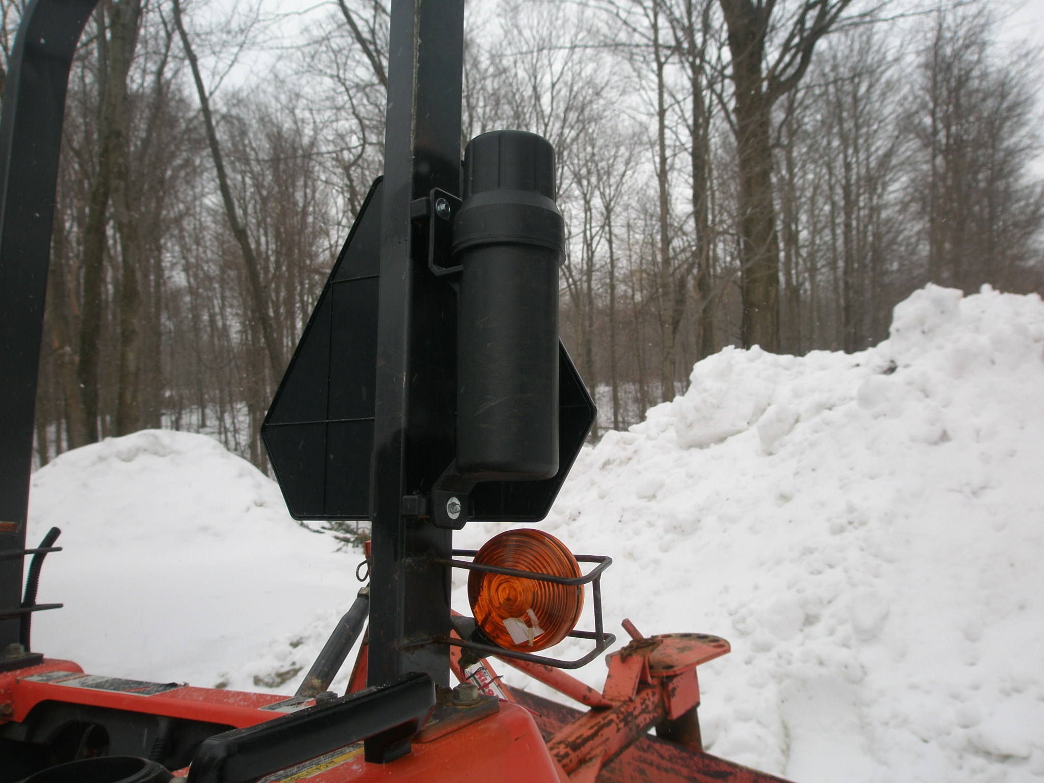

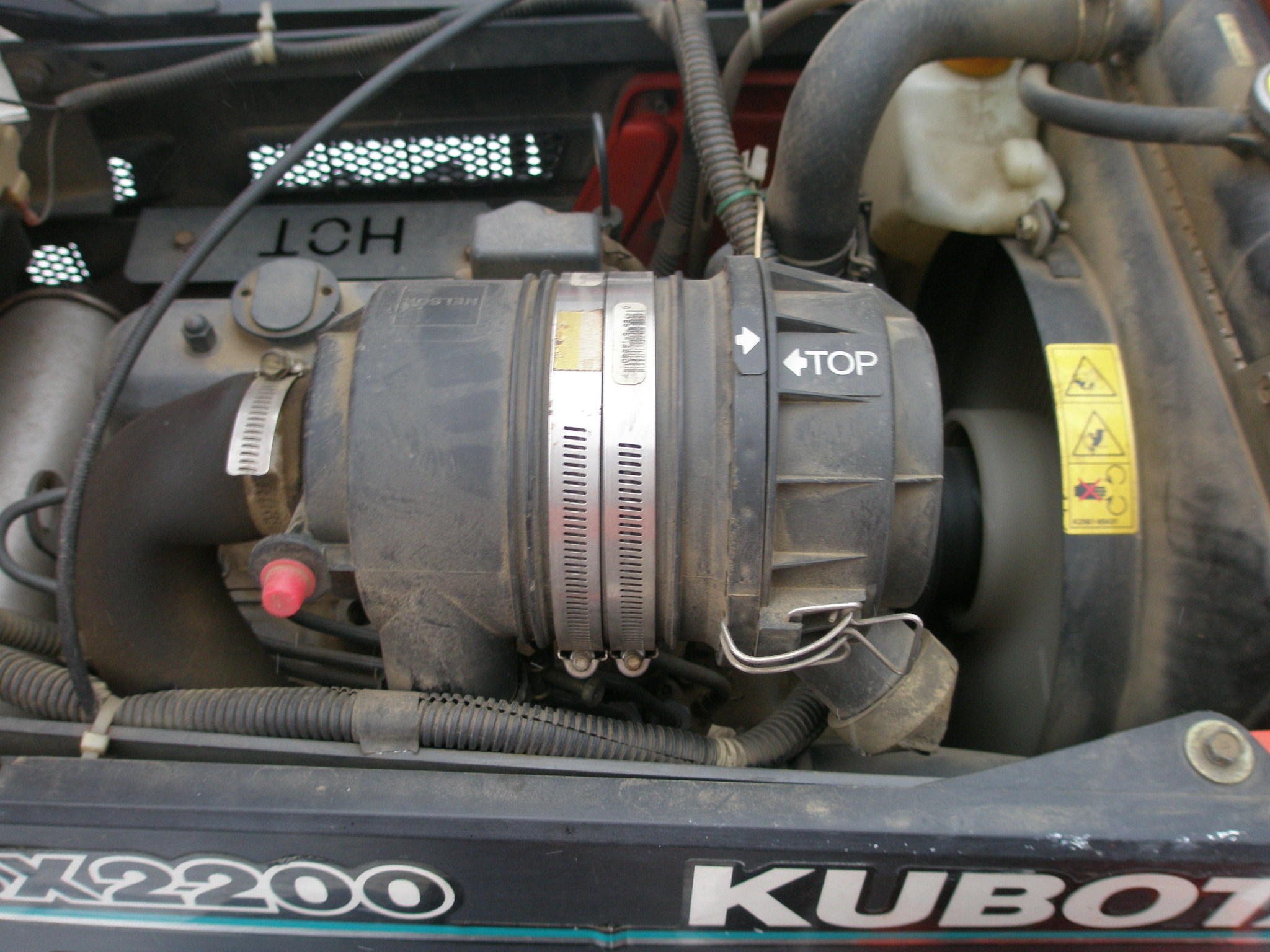

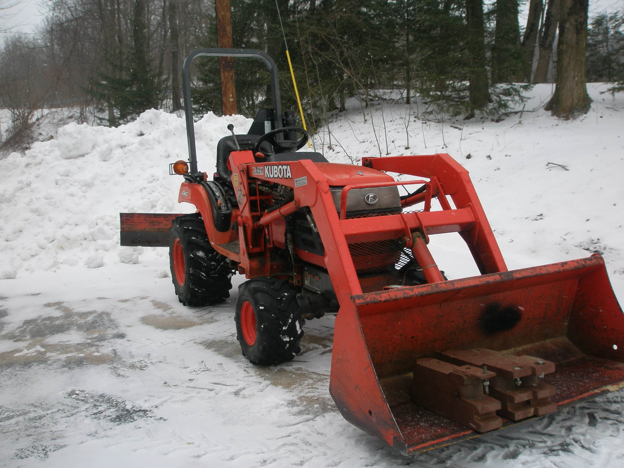

Here are some pictures of things that I needed to do to the Kubota BX2200 over the years. Pic 1 ( sorry about the focus) is the steel grate that was needed to save the plastic grill despite putting the brush bar on. Pic 2 shows the tool canister that is on the roll bar ( no drilling but welded on ) and the turn signal guards that were needed. pic 3 shows the air cleaner bands, the original band broke in 3 months as well as the second OEM part. Pic 4 Shows the taped seat that is holding up well. Pic 5 shows the bracket and gasket for the hydraulic lines. The hydraulic lines were being cut by the threads that clamp the bracket. No mater what I did the threads would cut through to the lines. Until I came up with the silicon caulk idea. Pic 6 Shows the BX2200 set up for snow removal.

Hi and welcome to TBN Vicki B. I too bought a BX2200 about a year and a half ago, had some repairs (prior owner didn't want to fix) I love it just sorry I didn't buy one sooner. DB Pilot Thank you for the heads up on FEL lines, I didn't check that side.View attachment 309111View attachment 309112View attachment 309113 I had trouble with a bolt also but it was on the FEL frame, left side. I use rubber grommets on the bolts when reinstalling them, one above the line and one underneath.:twocents:
