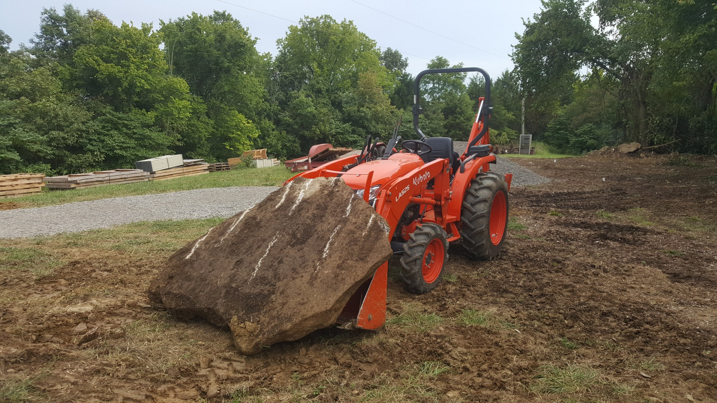

With the impressive work you have done with the L2501 and 77BH you deserve to have a real Kubota TLB.
BTW, even our M59 wouldn't pick up that rock in post #12 pinched between BH bucket and thumb - lthough it would easily flip it over and over into position.
Probably be able to lift it in the loader - 4000 lb capacity.
What do you think that rock weighs?

The LA525 bucket is 5' wide. Taking the rock as 6' x 4' x 1' = 24 cubic ft, and granite at 170 lbs./cuft puts the rock as 4080 lbs.

I doubt it’s half that heavy. For one it’s closer to a circle not a square. Also it tapers to a lot less than a foot thick. 3rd if it was 4000 pounds the L2501 couldn’t handle it is well as it did.
