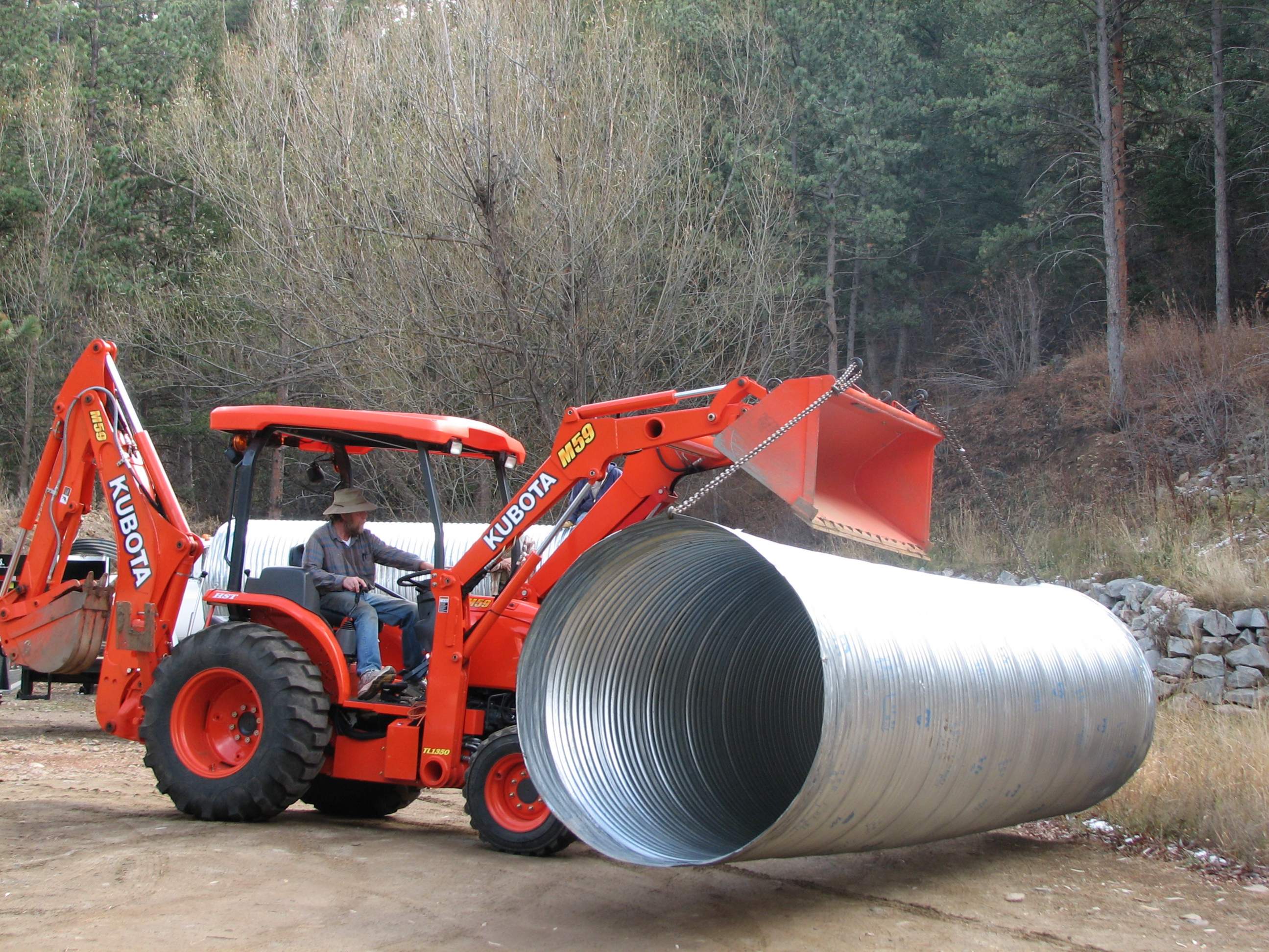

I have been going back and forth for a few months now trying to decide whether to add a Laurin cab to my B26 or purchase a used M59 with a Laurin can and just under 500 hours on it. I had decided to stick with the B26 and add a cab but the dealer still has the used M59 with the Laurin cab on it and they have dropped their asking price a considerable amount. I haven't nailed down final numbers, but just based on what they are now asking it looks like I could trade my B26 (which has 504 hours on it) and give them about $25,000 and have the M59. It will cost me about $11,000 to put a Laurin cab on my B26 so for about $14,000 I can move from the B26 to the M59. I did spend some additional money on my B26 this year (thumb, front hydraulics) but fortunately the M59 also has these options.
Sorry to ramble on a bit but I wanted to give some background. I am going to finally go and look at the M59 on Saturday and so I wanted to ask the M59 community if there are any know problems or issues to look for in an M59 with around 500 hours on it. I read somewhere about one person whose pumps failed around the 500 hour mark but I can't seem to find anyone else who has had this problem so I am hoping that was just a manufacturing defect. Are there any known where and tear issues that I should watch for on the M59?
Any particular tests or things I should look for on Saturday when I am at the controls?
Any input would be appreciated.

Not knowing your needs, I can't comment, but 500 hours on an M59, is just enough to put a few well needed scratches on it. Better than new, as it has a cab.
$11,000 for a cab just seems like burning money, especially for a B26. I bet you could find an old running full-size Case BH with cab for about that.
Real big jump from a B26 to an M59. Consider selling the B26 yourself as you will come out way ahead, then picking up a small tractor, to do the little stuff. Having two tractors is handy.

Thanks guys. The main issue I have with the B26 is that on commercial sites most pallets of materials arrive weighing around 2,000 pounds. It doesn't matter whether it is brick, block, ceramic tile, vinyl tile etc. This means that to move this stuff on a job site with the B26 I have to break the skids down right away which costs time. In addition there are many times when I wish the hoe on the B26 had another foot or two of reach.
I actually wanted to upgrade to an L45 because it would address both of these job site problems for me and not be too big. However when I started looking around I stumbled on this M59 which already has a Laurin cab on it as well as all the other accessories I want and I can purchase it for less than a new L45 optioned the way I want. I would then have to spend around $11,000 to install the Laurin cab on the L45 as I am tired of moving snow in the cold. I can purchase this used M59 for about $15,000 dollars less than a new L45 with the Laurin cab so it is attractive to me for that reason.
Looking at the differences in size and weight between an L45 and an M59 there is not a huge difference and the M59 actually has a tighter turning circle. The truck and trailer I have will move either machine so that is not an issue either.
Personally, I only have an acre of land at home but I do have a lot of landscaping and excavation work to do in pretty boney ground so the power of the M59 is certainly appealing. I do a number of side jobs throughout the year with the B26 and its small size is nice but in looking back over the past few years there have only been a couple of jobs where I could not have fit either an L45 or M59.
I am going to look at the M59 Saturday and see if it is too big.

I quite liked the M59 I saw yesterday. The size is fine and it was sure nice to sit inside a cab on a cool, windy day for a half hour or so. I am going to see if I can purchase the M59 but right now I think the dealer is at least a few thousand too high in his pricing so we'll see.

I was looking at a 45 as well, but the 45 was right on the edge of lifting 2000lb pallets. Most of the pallets I've been handling are in the 2500-3000 range, and the M59 handles them no problem.
The only complaint I've got on the M59 so far is that I think its a bit light on the rear. I don't have loaded tires, and find I have rear traction problems when I've got a heavy front load, even with the hoe on. If I take the hoe off and swap a box blade on then I'm REALLY wishing for more weight.
The only other complaint is the M59 makes me think I've got a case 580 under me and it clearly doesn't have the power of a larger 'yellow' machine. But for most of what I want it to do it does a good job.
