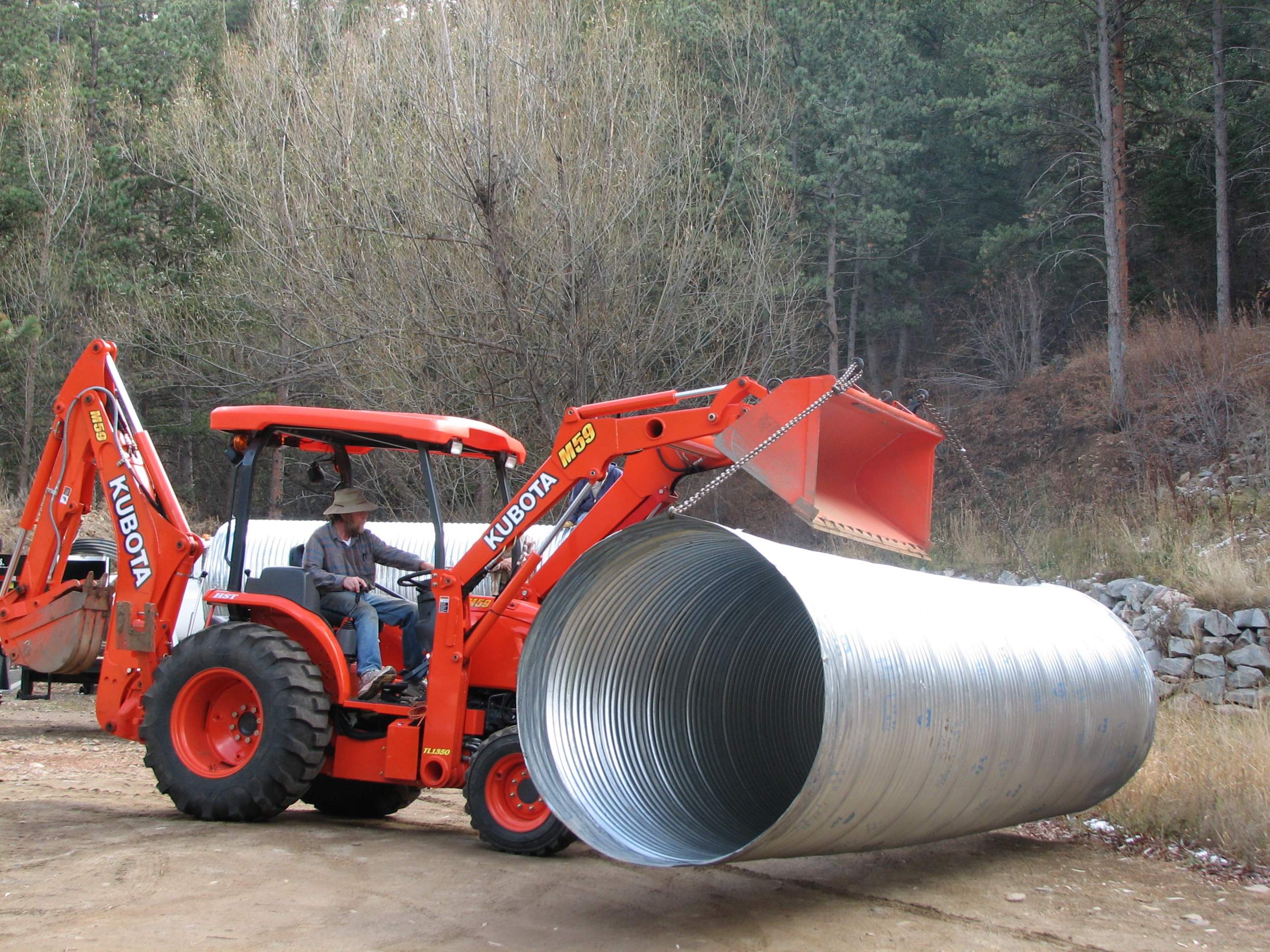

The only complaint I've got on the M59 so far is that I think its a bit light on the rear. I don't have loaded tires, and find I have rear traction problems when I've got a heavy front load, even with the hoe on. If I take the hoe off and swap a box blade on then I'm REALLY wishing for more weight.
The only other complaint is the M59 makes me think I've got a case 580 under me and it clearly doesn't have the power of a larger 'yellow' machine. But for most of what I want it to do it does a good job.
I've noticed the same thing. Mine could handle some more weight in the rear tires because even as heavy as the M59 is, the hydraulics are stronger than the tractor is heavy. Of course feeling the rear end go light makes a nice safety feature to keep from over-stressing the frame and tractor. It's mostly a loss of traction remediable with the 4WD lever. It doesn't feel like it is going over.
I'm not a fan of fluid filled tires, so if I did add weight it would be with the iron wheel weights Kubota made for the M59. Maybe Kubota noticed that it could handle some more weight too.
No, it's sure not a Case 580....but it has more in common with commercial machines than it does with the smaller TLBs. It's more relaxing when handling heavy loads.
