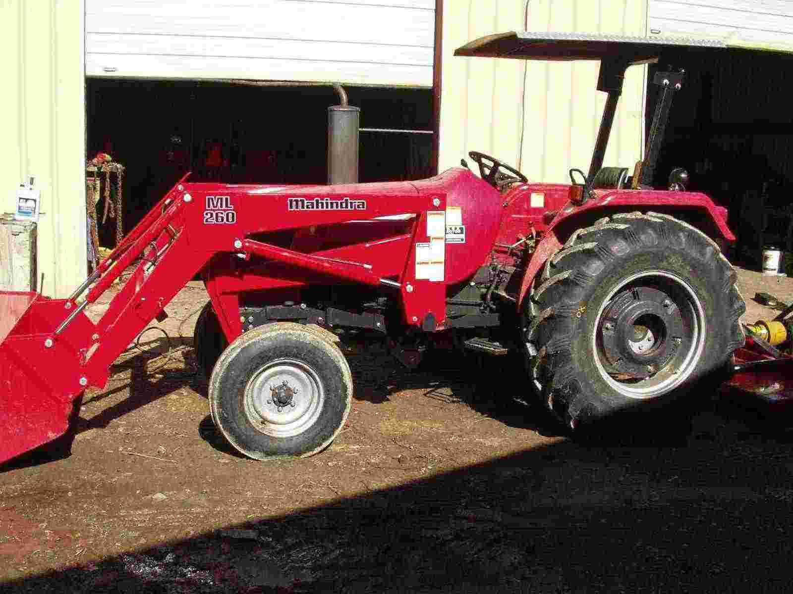

How about some pics, I like the Mahindra, but I am kind of partial to the old style. I think you did good. good luck with it.
Lloyd
   / Used Mahindra 6000 2wd - oil
PIC as requested of my new/used MH6000
Well here it is, I take delivery on Friday after Christmas.
Hope yall got what yall wanted, I did.
Charlie

   / Used Mahindra 6000 2wd - oil #7
Re: PIC as requested of my new/used MH6000
Nice tractor, Charlie. I am sure it will treat you good. Enjoy !!
