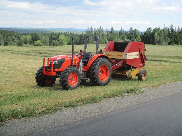

Guy down road has NH630, looks almost new,used on 10 acres last 20 yrs. Electric tie. What should I look out for?

I bought it, hope all is good with it.

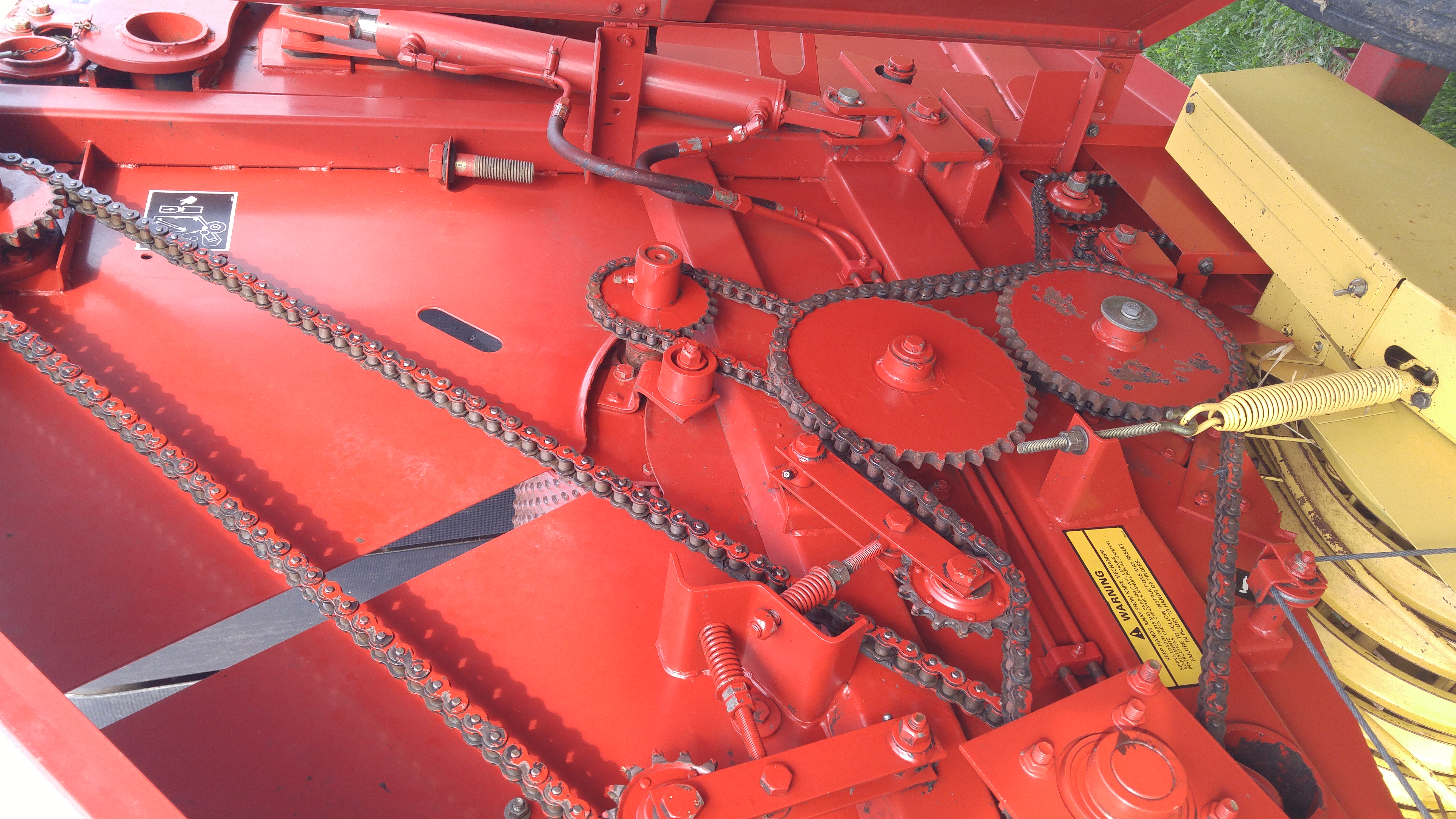

I assume bearings under each sprocket.
Never had or used a round baler.
I do have a laser thermometer.
   / Used NH 630 round baler #10
Given there is still paint on the chains I doubt you'll have bearing trouble, but yes, run the machine for a while and take temps, you can see if a bearing/roller is running hotter than others.
