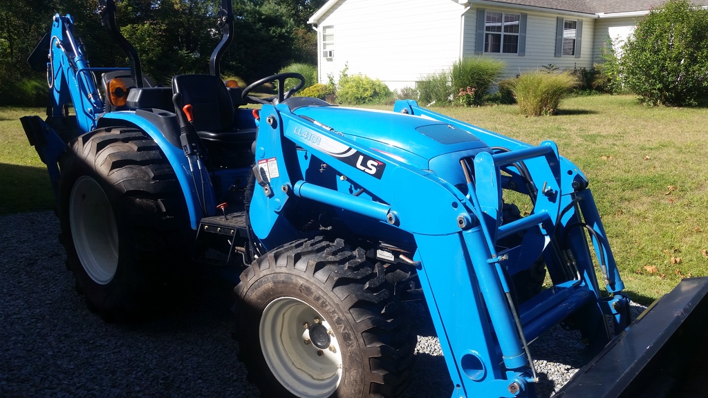

I went to look at it today and was quite impressed. I think there is a grand total of 37 hrs on it! I was also getting the impression that might deal a little:cool2:
The guy who showed it to me was selling it for his brother, he didn't know a whole lot of the operation of it. After calling the local LS dealer we found the valve for the hydraulics for the backhoe doesn't stay locked on...we used a bungee to hold it. The LS dealer said there was a mod to make the valve stay in position. Other than that it was like a new tractor....I'm psyched! Now I have to figure the best way to finance. Any suggestions? Is there anybody who specializes in financing used tractors? I would use my home equity but need to keep that free for right now.
Here's a pic from today
Here's a pic
/ Used R4047 #16
Here's a pic
Well, that is basicly a new tractor. The detents in the valves are often removed to keep inexperienced people from locking them on when the backhoe is not attached to let the fluid flow back to the tank. So the inexperienced person takes the backhoe off, does not use a Loop of hose on the rear remotes and accidently places the control valve in locking detent and leaves it there. This deadheads the hydraulic pump "looking" into that unterminated rear remote. He wonders why the tractor lacks power, seems to make more noise, and what is that hot smell? He then gets to buy a new pump if he leaves it in this state long enough. I had my detents removed by the dealer before delivery, because I did not want someone, myself included deadheading the pump accidently. This is sure to happen if you loan your tractor to someone who is unfamiliar with hydraulics.
Thanks k0ua, I wasn't aware of that. Sounds like maybe I should keep it the way it is then...
/ Used R4047 #18
it is up to you. Many guy are fine with the detent, some don't trust them. As long as you are aware, and paying attention... It is all good. Now you know.
By the way I would buy that tractor in a heartbeat. Even if you don't want the backhoe, you could sell it for 5k to 6K and have 14 to 15K in one nice new tractor.. But you probably want to keep it as is.
